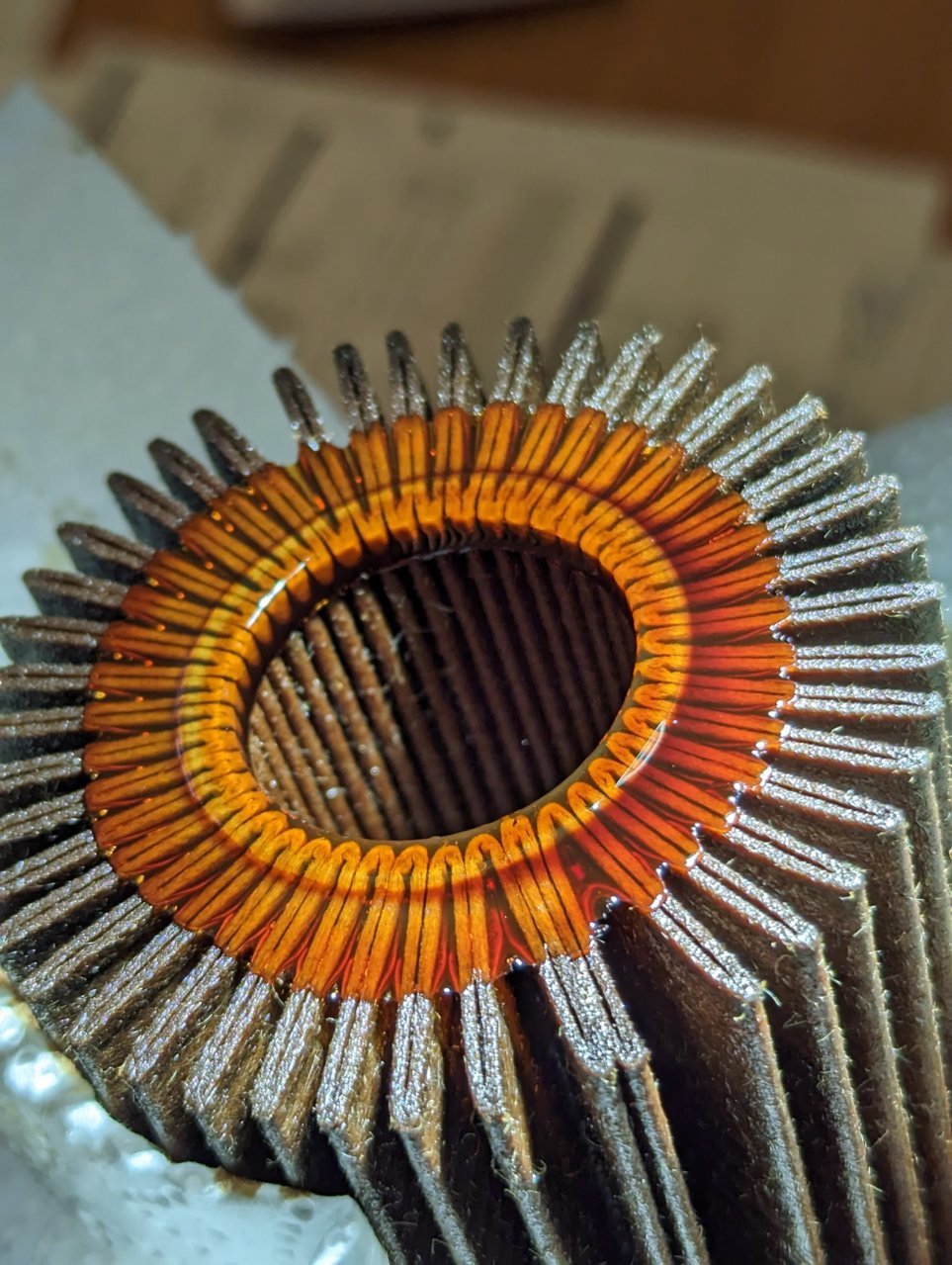

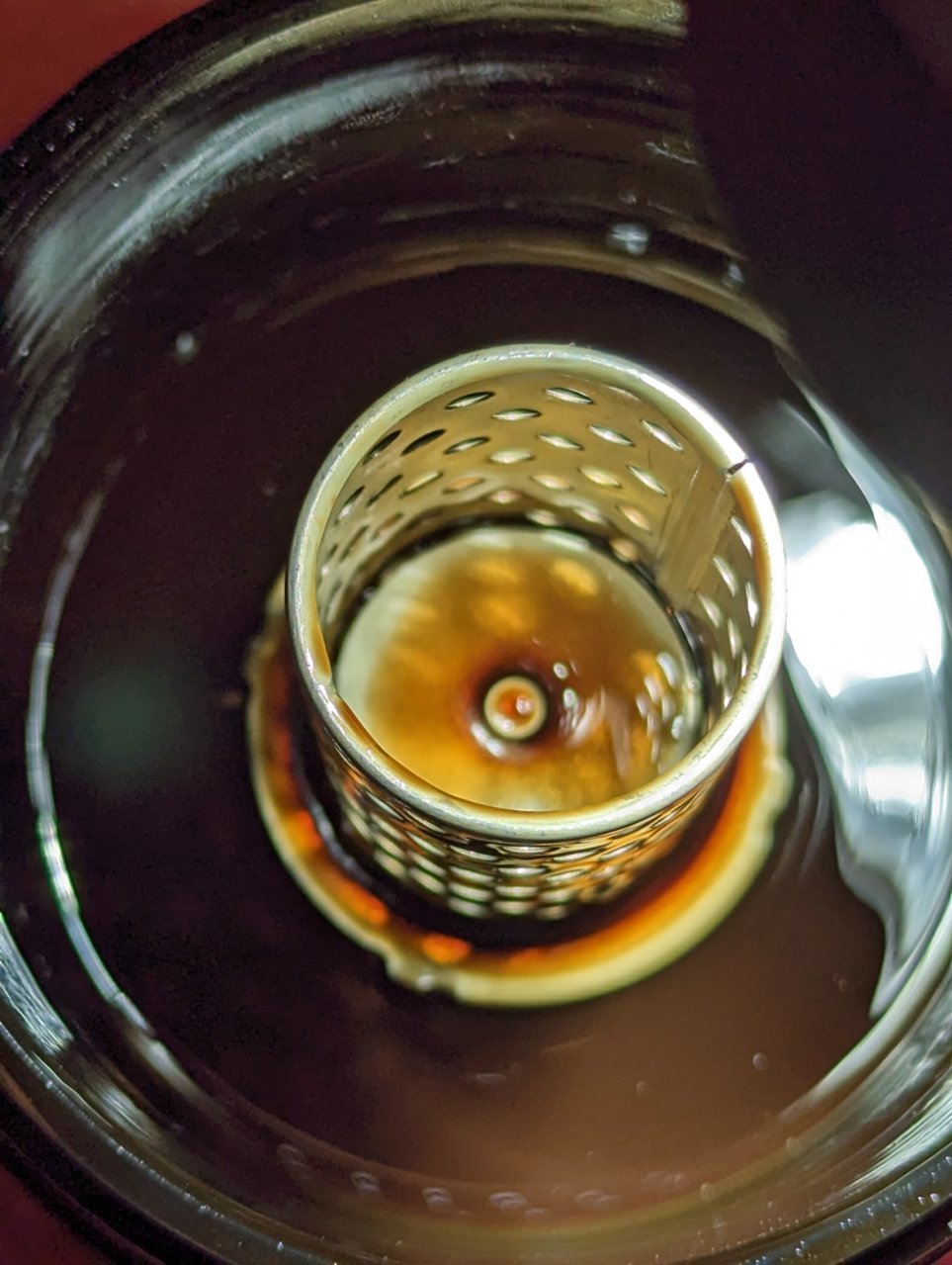

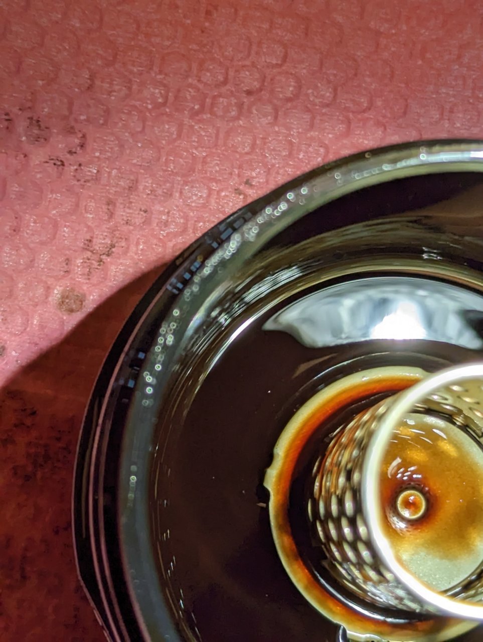

    Yup bad news. Needs a motor replacement. They said it would cost $16k to replace with a used motor with 80k miles on it. I don't think I'd replace it with a used motor at that price.
    The Manager said I can try to call Toyota care to see if they would still cover it after the warranty period considering it was days out of coverage. I asked if that's ever worked. He said twice in his 26 years. I guess I'll try and all they can say is no.
    The manager then said to try Toyota corporate and see if they will do anything. He said he's seen where they offer to cover a portion of the repairs in some cases.
    They don't really know what's wrong and would cost $3,400 to tear it down to find the problem but at that point it would just need a new motor anyway.
    The manager said it's possible the oil pump went out but no way to tell unless they tear it down.
    I guess I'll make some calls and hope for the best.
    It was hard to get good pictures but you can see the metal in there. The "large" pieces I'd imagine was just the service advise trying to relay what he was told.

    i really hope this works out for you and as others asked, please keep us posted.
    i see some silvery specs in the filter photos but i'm not entirely sure what i am looking at. if it were me, i'd want more of a dignostic. they should be able to test the oil pump.
    i'd drop the oil pan and unless there were chunks of metal and the if oil pump checked out oK, i'd put in new oil and filter, start/drive it, and see what happens.
