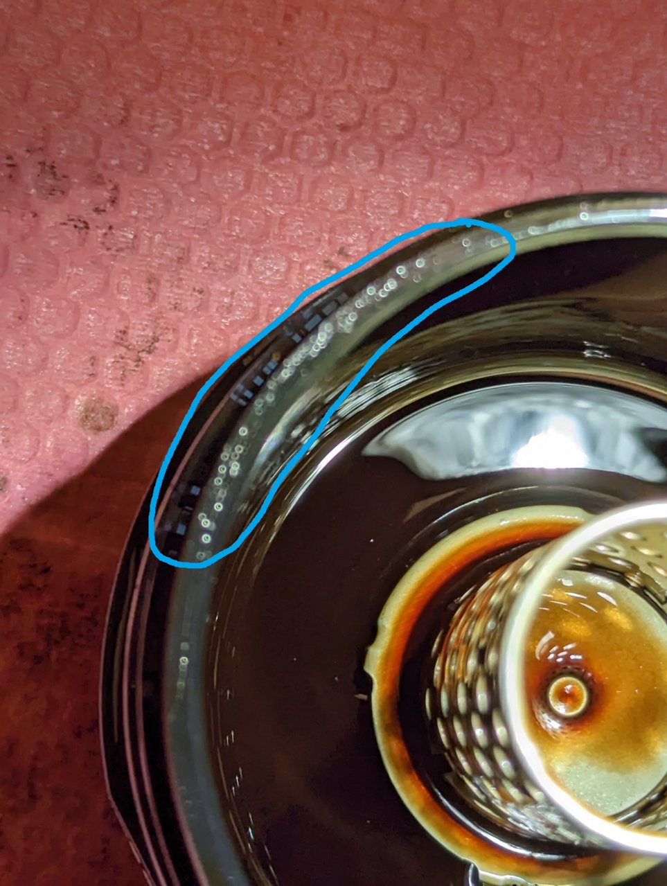

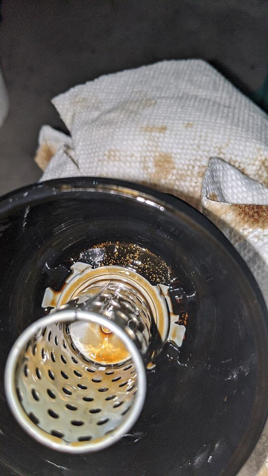

    Am I the only one who doesn't see a speckle of glitter?
    I had more glitter in my first oil change. Not that you should have much of anything after that.

    The only thing that remotely resembles glitter in these pics is this. And these could just be bubbles/moisture.

    I don’t see anything bad in those oil filter pics. I’d get that away from the stealership asap. If you can do work yourself, Add an oil psi gauge and see what’s going on. Drop the pan and see what’s on the pickup as well... if there is sealant on there you have a hard case against the timing cover repair being the root cause.

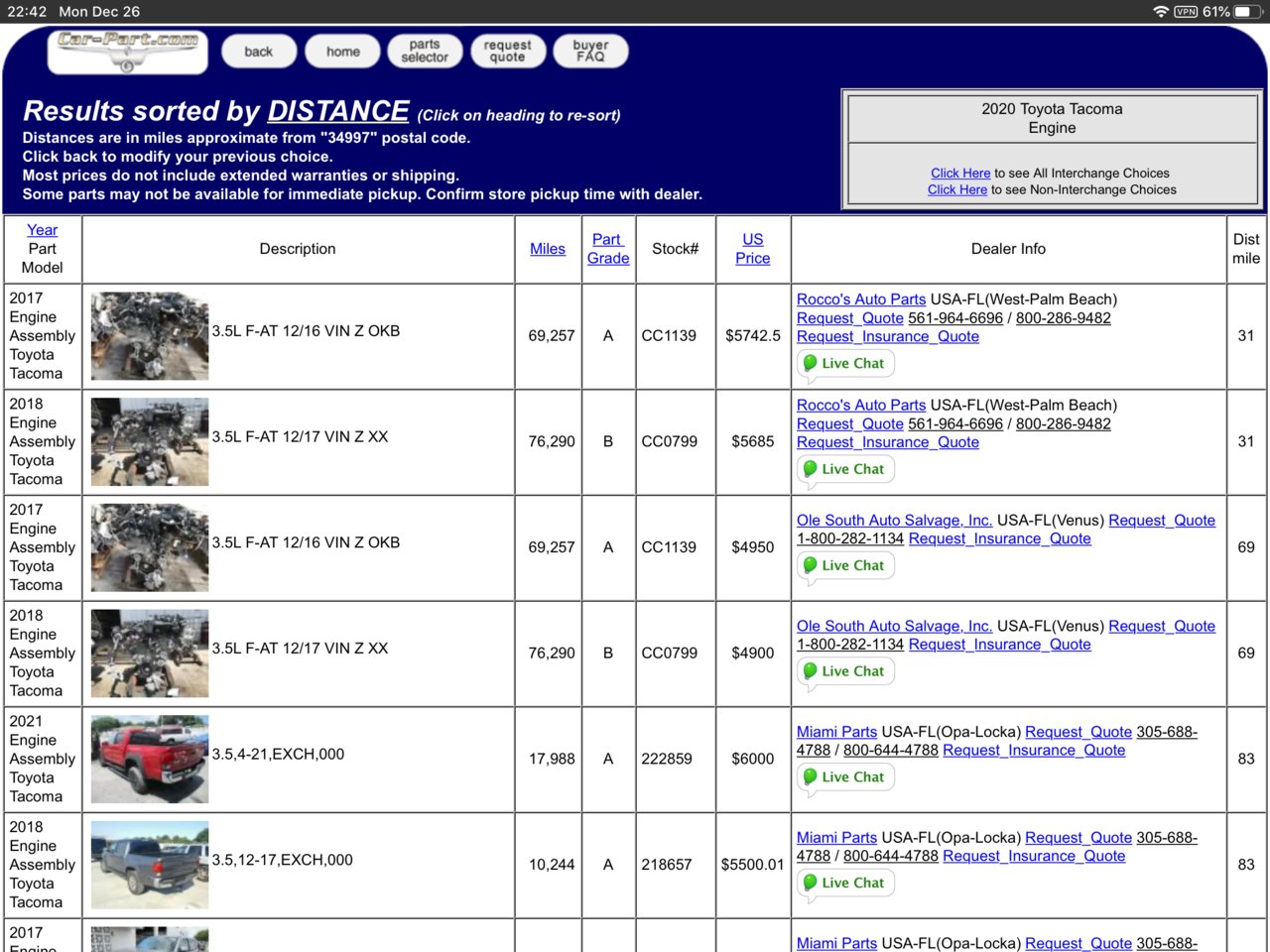

    regardless, I’m betting you can find a local used 3.5 and have a shop swap it over for a few grand. Check car-part.com as well.
