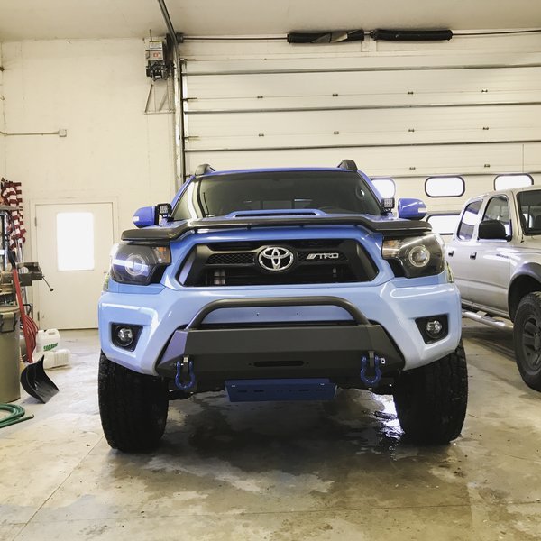

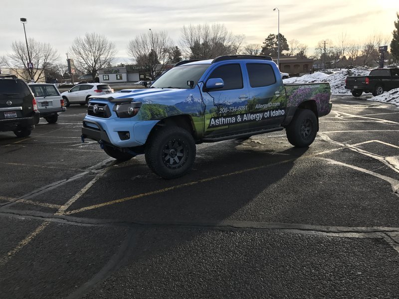

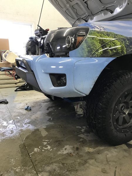

    What brand is that one?

    This is a perfect shot! that bumper looks soo good from this angle! I am pretty sold on it! SSO correct?

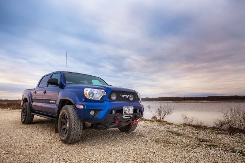

    Love my US OFF ROAD (style seen up to). Enough room in the gap for both a pair of cube lights, but also room to operate the winch clutch and plug in the wired remote without having to open the hood. Installation was straight forward, I do recommend getting the fairlead and winch installed first before putting the bumper in place. I did it the other way round and make for a few more curse words that necessary.

    @cuda2k did you have to do any cutting I'm not that great at stuff like that and worry about messing up the real bumper but really want this bumper

    I have a US Offroad set up, and I love it.
    A couple things I like about it:
    The fair lead mount is perpendicular to the ground, so you don't constantly dig your fair lead into the dirt.
    The cut out above the winch is great for accessing the spool and checking how your rope is winding. Very few Tacoma bumpers have this option, even though access to this zone is critical.
    As far as cutting goes, the bumper is super easy to cut, and can be cut with a knife.

    For the US Off Road there's two things you have to cut
    1) The recovery loop on the passenger side of the front frame cross member, this takes maybe 2 minutes with a cutoff wheel. Spray little rustoleum on the exposed metal ends to prevent rust from forming. This is completely hidden when the bumper is in place.
    2) there's a piece of the painted bumper cover that sits behind the gray plastic lower valance that has to be cut out. Follow the instructions provided, leave an inch at most from the edge of where the valance piece sat. I started off really conservative with my cut and ended up having to trim several times before I had enough removed for the bumper cover to sit right. I think the perfect tool for this is probably a really good pair of tinsnips or old (but still sharp) pair of good kitchen sheers.
