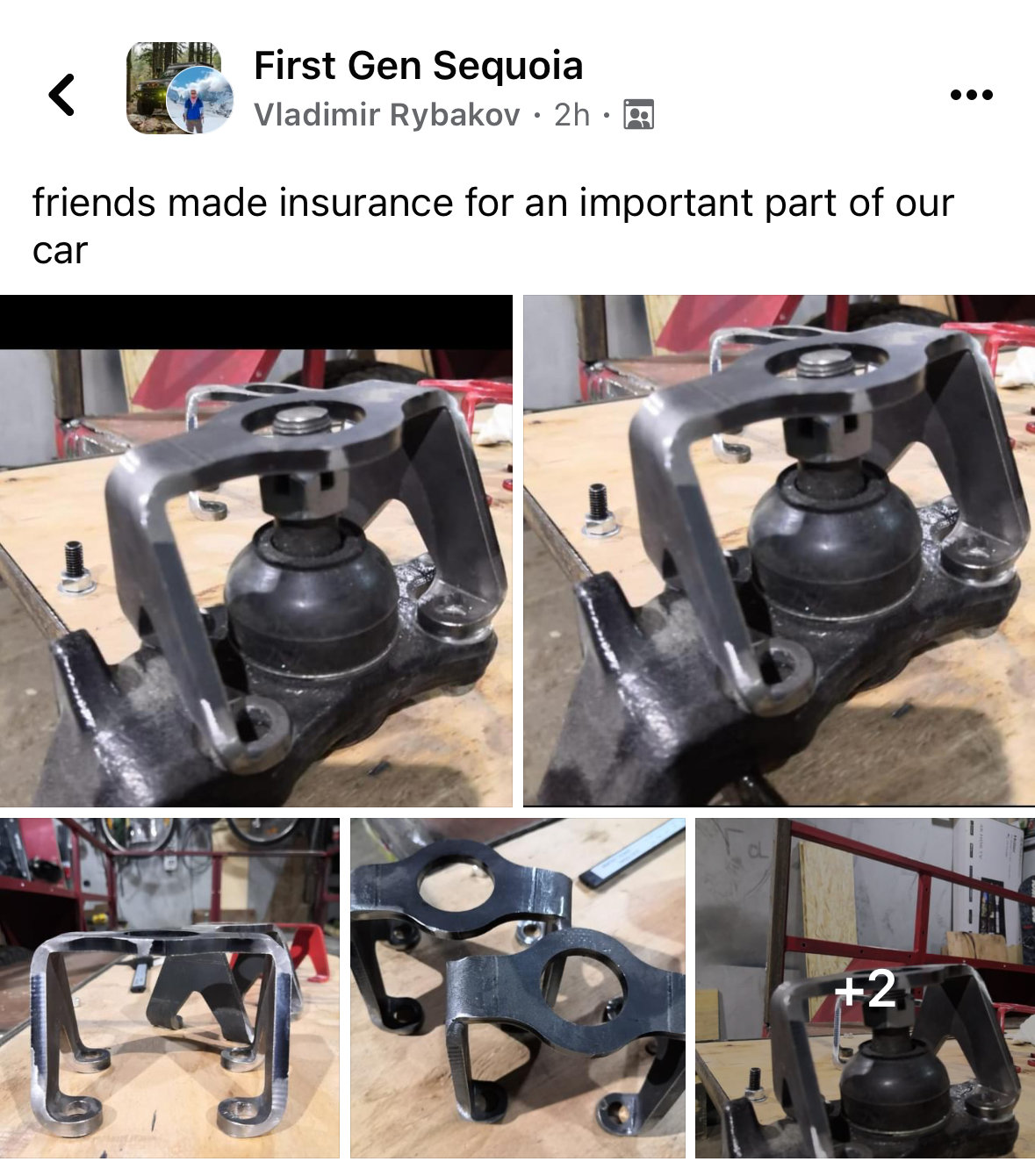

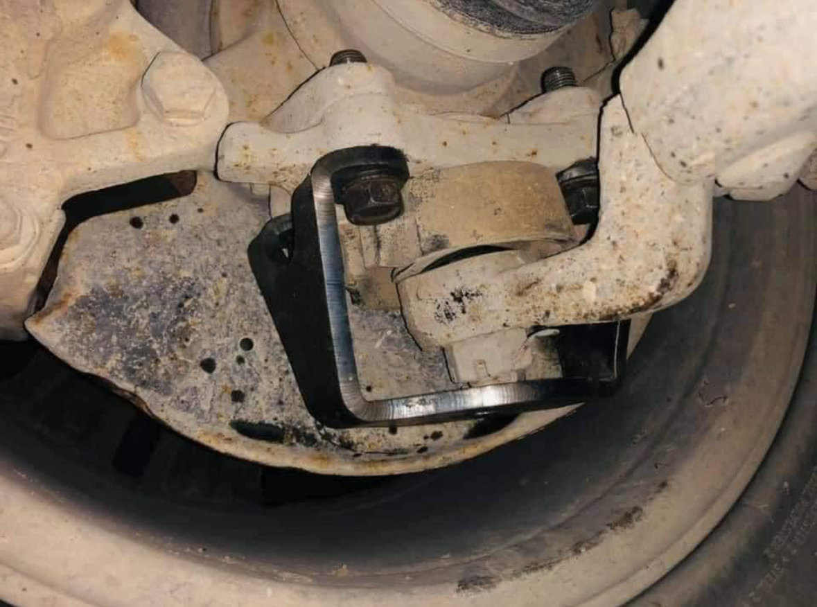

    Saw this on the Facebooks…
    Posted it over on Tundras. Seems the Taco’s are having more catastrophic failures.

    How does that prevent a failure of the bolts?

    Cool idea ig but the issue is just lack of maintenance. Preety much everyone with failures admits they never changed them or should have been upgraded to uni balls ball joints.

    Rube Goldberg seal of approval.

    How do you torque the bolts closest to the backing plate.

    If you were bombing down some rough roads even newer joints, might be a better piece of mind.
    I think no would need to see some testing and them actually supporting the weight of the vehicle.

    Should temp hold if the bj separated. Will buy you enough time to get to the shoulder and stop to prevent major damage.

    That bracket is only good for off road toys....and even then the wheel may be so misaligned it just goes in a circle...or jambs like a 9mm cartridge
