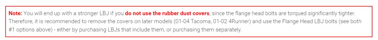

    I like @turbodb's write up. The only thing I disagree with is his note -
    Dan always (and I mean ALWAYS) churns out the very best write-ups, trip reports, guides. After Leon's (Spiker Engineering) research and tests on the lower ball joint bolts, I am sticking with the black w/washer and using the dust cover. No offense Dan ;)
