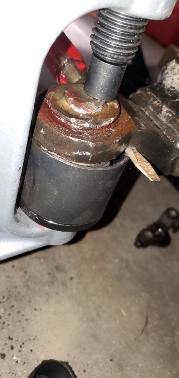

    Yes, it was. The AutoZone rental ball joint press kit didn't have the exact size presses I needed. Also, the press' handle was too short to get any real leverage on things. Fortunately, a buddy dropped in to assist me (I initially attempted it by myself) and he brought a "cheater" bar to really lay into things. I had to hammer out my old ball joints. Getting the new joints in squarely was a pain - I'd get them started with good alignment, but as soon as I applied torque to press them in they would shift/tilt off-center. I kept having to re-center them and start over. We eventually got it, however. Just be patient and persistent.

    The kit they rent works fine. The cup doesnt exactly fit the LCA but if you use a screw driver as a spacer on the back side it works GREAT.

    I’m glad your kit worked great for you. Like I said, mine didn’t. It was missing adapters.
