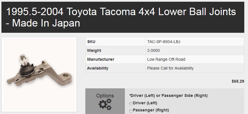

    I have Moog 555 in my truck. 30k miles without problems, but I'll replace them for oem ones soon, unless I stop reading Tacomaworlds posts :rolleyes:

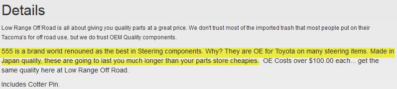

    Those are the 555 brand and repackaged for LROR to sell. These would be the next best to the OEM lower ball joints, as 555 makes the OEM joints for Toyota. The joints in the link aren't the same quality as the OEM, but they are a step above the shitty Chinese lower ball joints that many companies sell.

    It's never known with certainty how well the LBJ's will hold up, regardless of the manufacturer, at least yours are the 'medium' grade of lbj's available for the taco. 555 rebranded lbj's, except the OEM 555 LBJ, will hopefully last. Especially if you are easy on your taco.

    I'd still go with OEM. Pretty sure @Dirty Pool split open the 555 and OEM LBJs and even those were quite different.

    Yep, the 555 aftermarket lbj is below the quality and robustness of the 555 OEM lbj.
