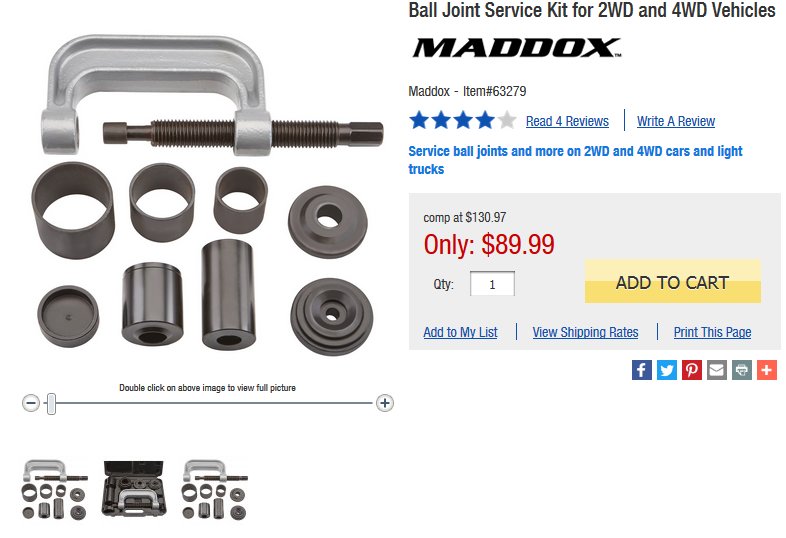

    You guys have inspired me. I think I'll use my 20% off coupon for Harbor Freight and get these.. I do have a big hammer. Had to use that when I replaced the outer tie rods a couple of years ago. That's one thing I'm going to have to be careful about is not damaging the rubber boot on the tie rods.
    What are your thoughts on this? I wish I would have had this when I replaced the bushings in my rack.

    The press is good for the uppers when replacing them. The pickle fork is for gm cats not toyota. Grab a 5 pound baby sledge give the knuckle 2-3 whacks and the joint will fall free
