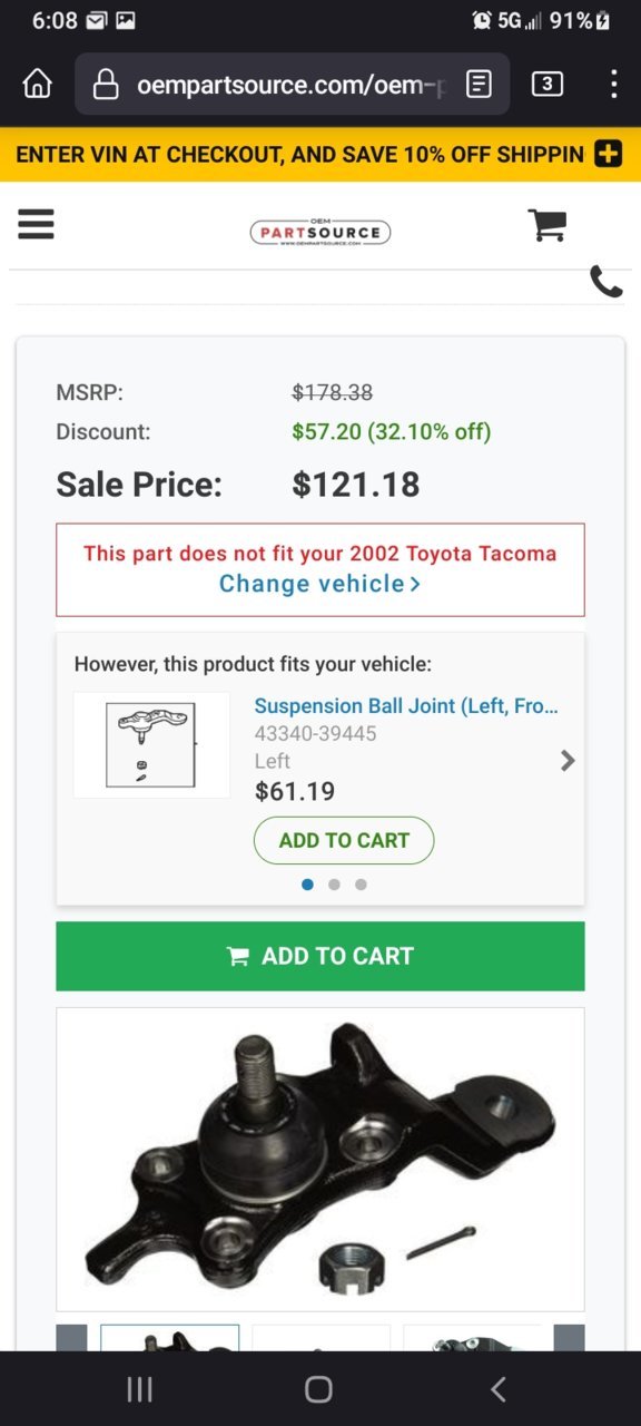

    Are prerunner and 4x4 lbj's the same part #?

  9. Mar 10, 2022 at 3:05 PM

    Wierd. When I check fitment, its fine on prerunner but it doesn't give 4x4 as an option.

    I tried running base. Says doesnt fit.
    I'm assuming that's 5 lug base, but still no option for 4x4 base. Anyway...i'll order them.

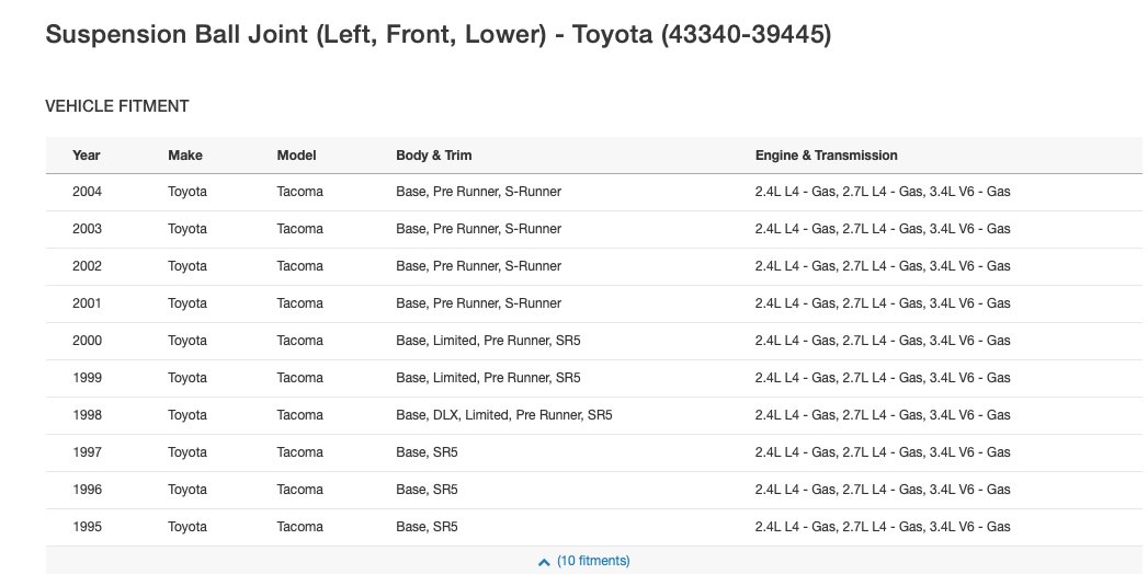

    On McGeorge it shows that part fitting the base models
    It also says S-Runners and 2.4l which are 5 lug so maybe I was wrong about 5 lugs being different...I could've sworn they were. Hmm

    Yea, thats where i'm looking. It does show below
    "Applications"
    4wd coil spring.
    I was confused at the chart because 2001-2004 only showed prerunner and srunner.

    Yeah their fitment charts can be weird and confusing. There's also part number differences based on LBJs with bolts and without, which I believe pertains to the 1st gens that came without dust cover boots vs those that did. But that just adds to the mess. Another good reason to just plug your vin into Partsouq lol.
