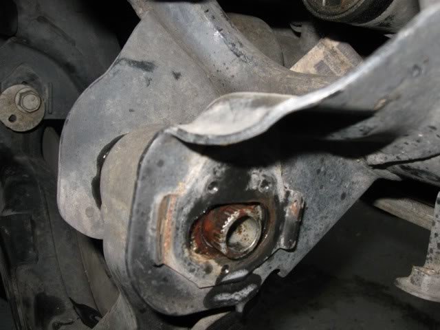

    Mine seized up too. Ended up cutting them off and replacing the bolts and cams when I replaced the LCAs.
    Check your alignment cam tabs while you're poking around. There's a good chance they're flattened.

    is that spacer sticking out part of the bushing?because when i took mine nut and cam off it was just the cam bolt sticking out!! also why is everyone replacing the control arms?

    That's the cam bolt sticking out. Mine was seized in the LCA bushing and had to be cut to remove the LCA.

    my cam bolt dosnt look like that ,its just threaded dosent look like a spacer,maybe year/model. so are there any tips to change this??

    When you remove that threaded bolt you'll see what's in the above picture.

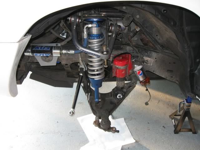

    No need to remove the ball joint. There are 2 bolts that attach the spindle to the piece that pivots below the ball joint. Just undo that 2 bolts and the bottom of the spindle will swing free.
    Shot of my truck, sans spindle, in the middle of some work I was doing so you can see where the bolts are and how it comes apart:
