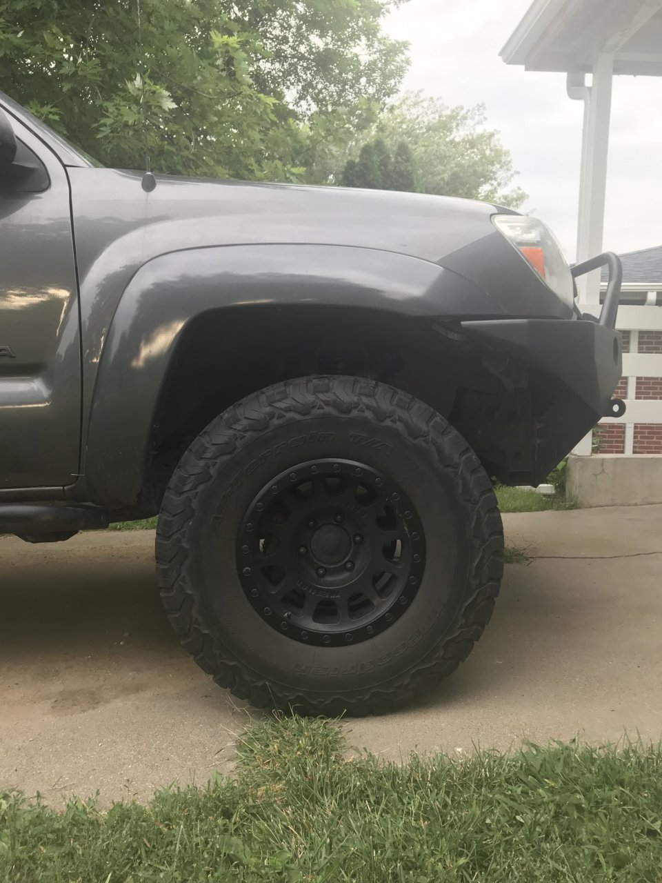

    I have this problem too. My trucks at the shop to push the caster forward and they say it'll be 3-4 hours of labor but thankfully not a new LCA.. at least yet.
  8. Aug 2, 2019 at 8:03 AM
    #28
    TheDevilYouLove
    TheDevilYouLove You can’t polish a turd, but you can polish a TRD
    May 26, 2016
    #187953
    2,883
    Steve
    Marylandistan
    2010 Tacoma TRD Sport Access cab 4x4 silver streak
    Let us know how this turns out. I’d be amazed if you don’t need new LCA bushings at least.
  9. Aug 2, 2019 at 8:48 AM
    #29
    BraskaTaco
    BraskaTaco Well-Known Member
    Jan 11, 2016
    #174711
    2,150
    Midwest
    2013 Tacoma TRD OR
    Oh ya they are going to do bushings. All in the name of a little more tire clearance.. ha. They did say the wheel is as far back towards the cab mount as possible, I wonder if it came from the factory like that or if some alignment shop along the way decided to.
  10. Aug 2, 2019 at 8:49 AM
    #30
    BraskaTaco
    Jan 11, 2016
    #174711
    2,150
    Midwest
    2013 Tacoma TRD OR

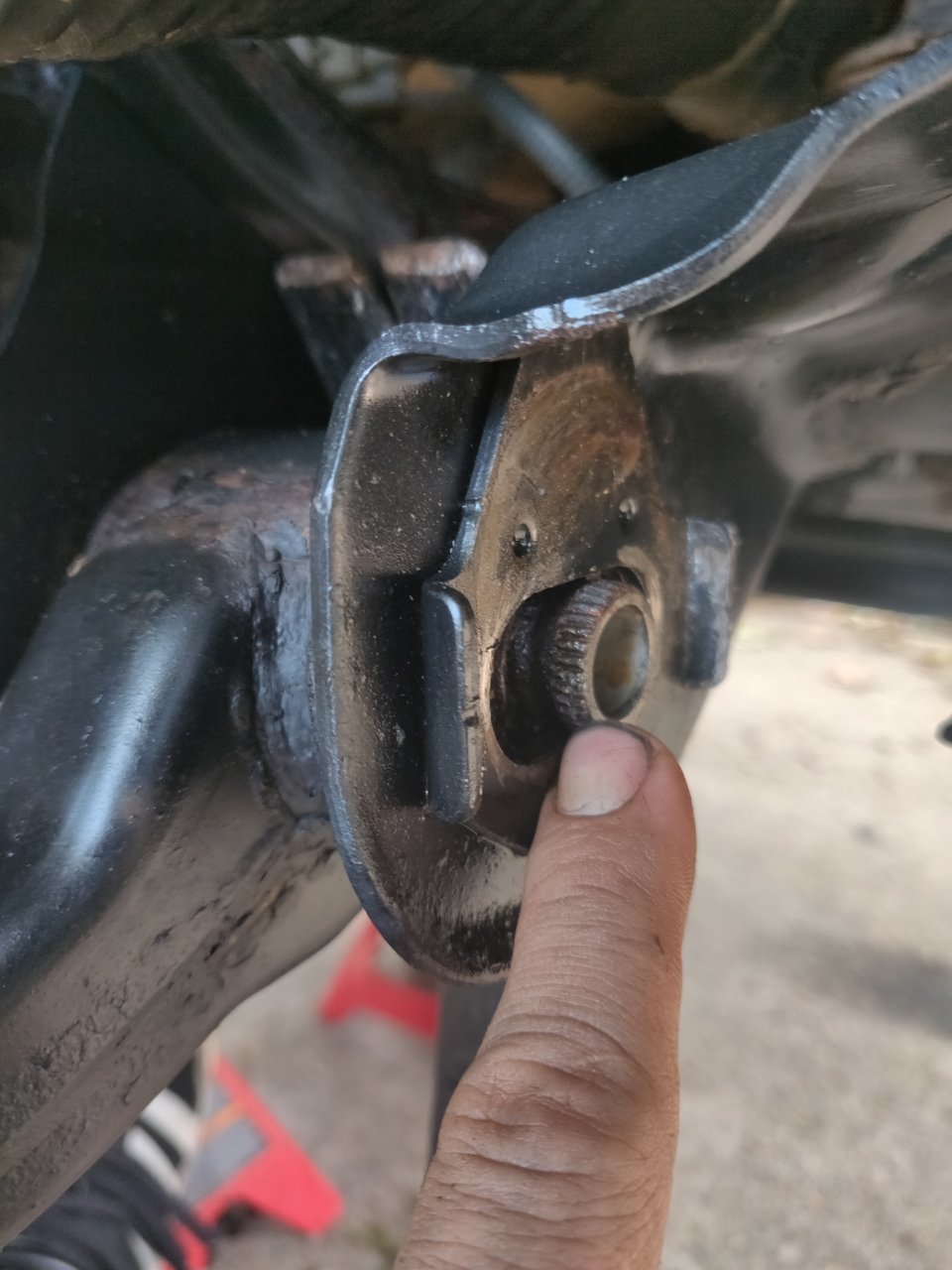

    I'm in the middle of this issue now. With everything connected, all I could do is try to break them with an impact wrench and a breaker bar on my back under the truck. Not much room to do anything.
    In the rear, I was able to get the set nut off of the rear cam bolts, but unable to actually turn or remove the rear cam bolt. Impact wrench (1024 ft-lbf), breaker bar, and hammering the shit out of it accomplished nothing.
    For the front, I was able to get the front cam bolt out. However, the front sleeve is seized inside preventing the installation of new cam bolts and the front cam splines that attached to the sleeve got stripped off.
    Failing to really accomplish anything, I retorqued all the nuts back on so that I could at least drive and decided to just buy new Moog LCAs and cam bolts. Everything including shipping from rockauto was $275. My Moog LCAs and new cam bolts should be in the mail today. This weekend I'm going to try again to break the bolts loose just because I know trying to cut through them will be a bitch. I think if I unbolt the ball joint and the shock mount and swing the control arm down, I'll have enough room to access the cam bolts with a breaker bar from outside the truck. Previously I was doing all the work on my back under the truck. I have a feeling that I'm going to have to cut through the bolts anyway and now that I'm getting new LCAs, I don't care about the old bushings...so I may try some heat before I grab the sawsall.

    If you have access to a welder, put a few beads on those alignment tabs before they flatten out.
    Good luck getting the bolts out. :fingerscrossed:

    Another one here but I was able to heat the bolts and pop them out, without cutting them.
