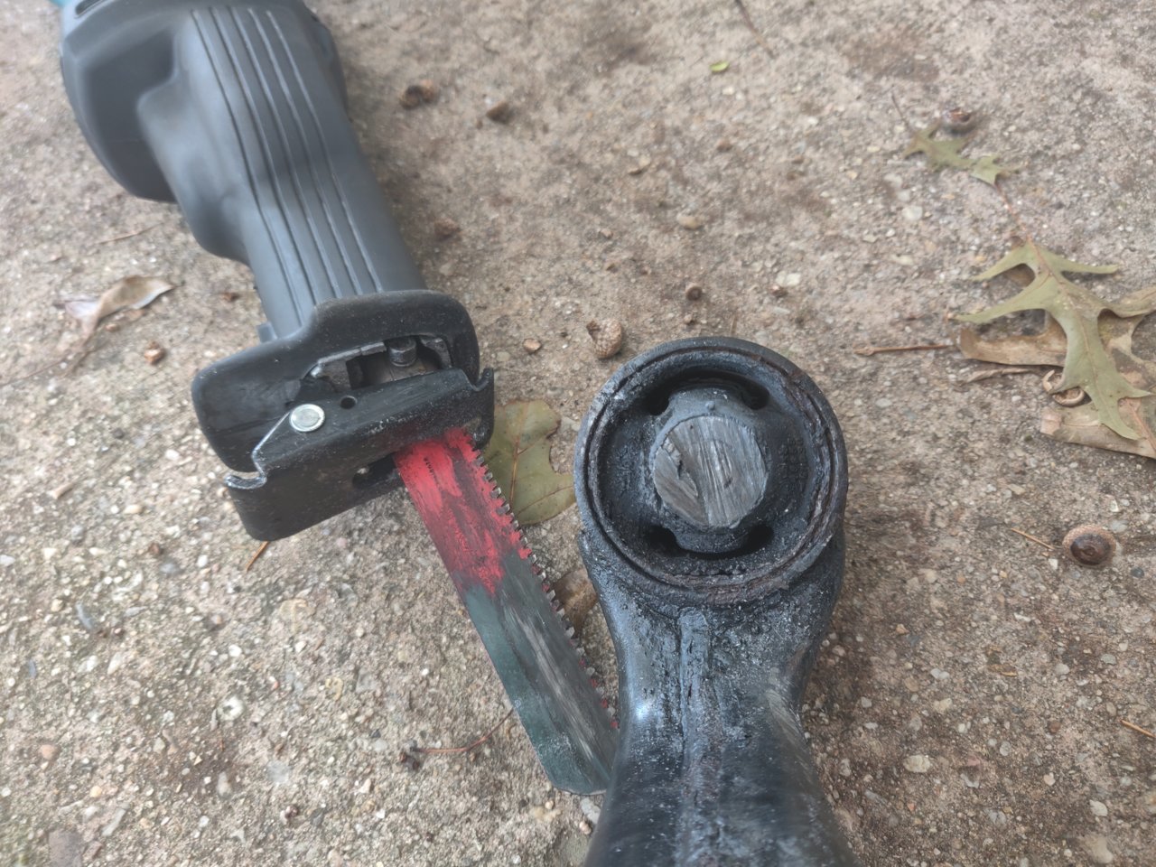

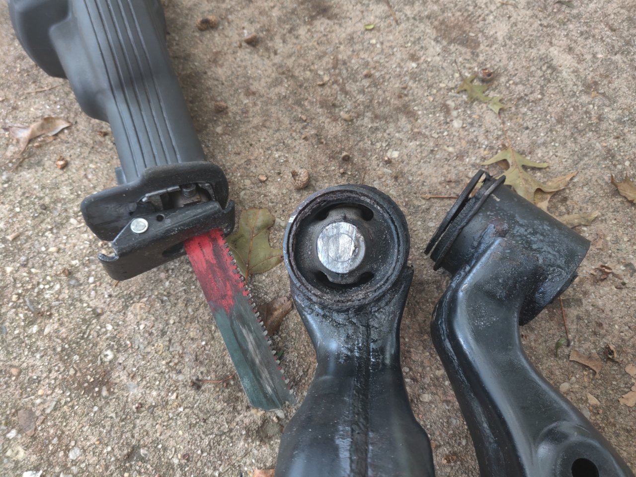

    I got the job done this weekend. I ended up having to cut them off, too. I was hoping that when I disconnected the ball joint/lower ball joint attachment and the shock mount, the lower control arm would swing down so that I could get the angle grinder in there. Even completely disconnected from the suspension, the LCAs were locked in place and wouldn't hang down like in MYKOSPRO's picture. I bought a pack of the Lenox blades from Lowes and went through one and a half blades for my first cut that took about an hour. I ended up going to Home Depot to get the Diablo blades and that blade is amazing. I made the other seven cuts through the sleeves in no time and the blade is still good to use. I just kept it lubed and cooled with some WD-40.
    I put anti-seize on the cam bolt sleeves and along the cam bolts that go through the bushings. I also put some anti-seize on the back of the cams.
    Time will tell how well the balljoint on the Moogs hold up.

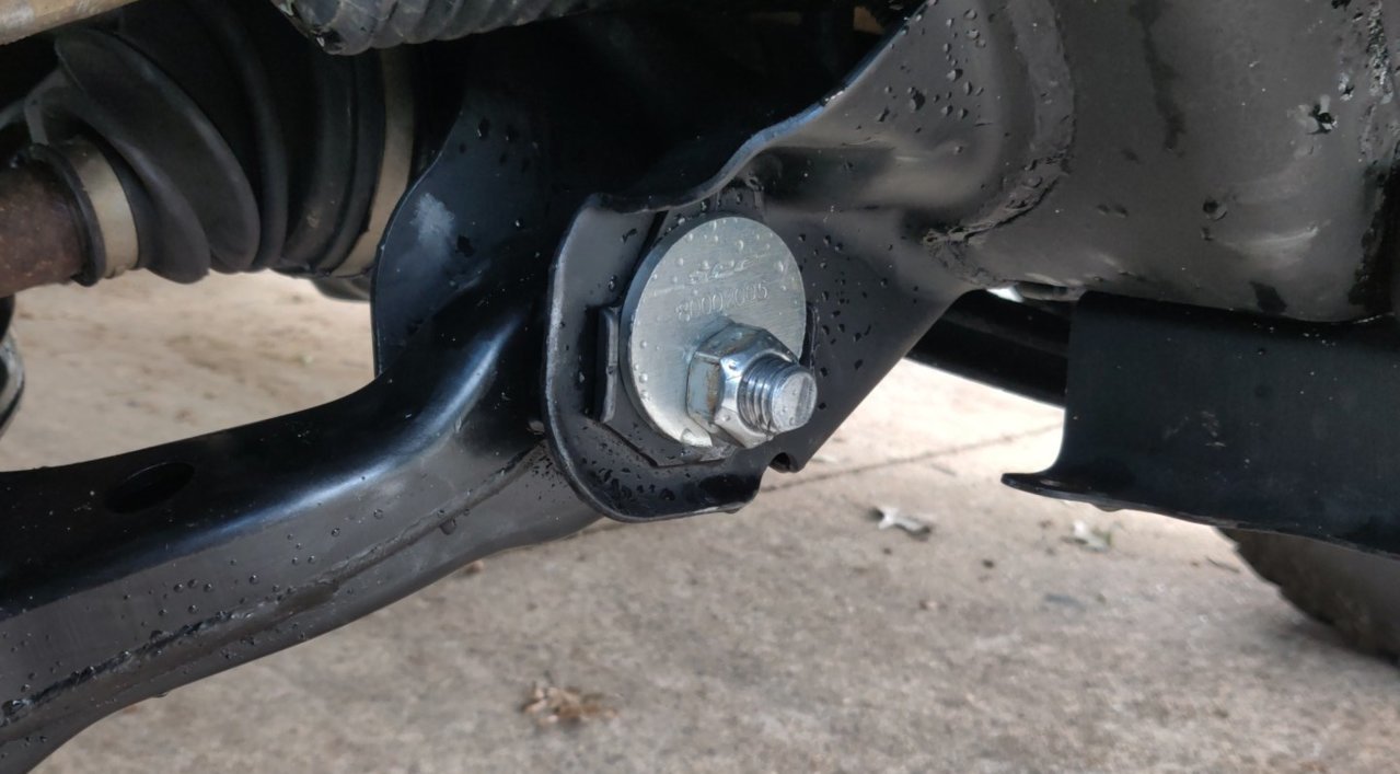

    I got sick and tired of changing my LCA's every few months (moog) and wasn't willing to fork out the $$$ for OEM (which is good but the spacer that runs through the bushing is molded in place which will eventually cause the bushing to take a crap) so I reworked oem LCA's with whiteline bushings & new moog BJ's - I also welded up and in the TC Gusset kit as the alignment shop accidentally flattened the OEM sheet metal trash.
    I haven't had an issue with the MOOG cam bolts yet.. but when/if i do, i'll give this https://www.polyperformance.com/poly-performance-taco-tabs-alignment-cam-delete-kit-for-toyota-05-15-tacoma-03-09-4runner-gx470-07-09-fj-cruiser a try.

    I got the MEVOTECH MS86036 cam bolts off of Rockauto.com (one set for one LCA). Rockauto also has some AC Delco ones for twice as much that come with zirk fittings in the sleeves. I opted to put anti-seize inside the bushing sleeve, on the cam bolt, and then on the cam faces instead.
    I can't recommend the Diablo blade enough. It was night and day from what we were trying to do. I was tempted to take the angle grinder to the LCA and cut everything off except the bushing to make room for the angle grinder to get to the bushing. No need to do any of that if you just get the right blade at the start. My son sprayed the blade with WD-40 whenever it stopped smoking during the cut. Keeping the blade cool and lubed made it very quick, too.
