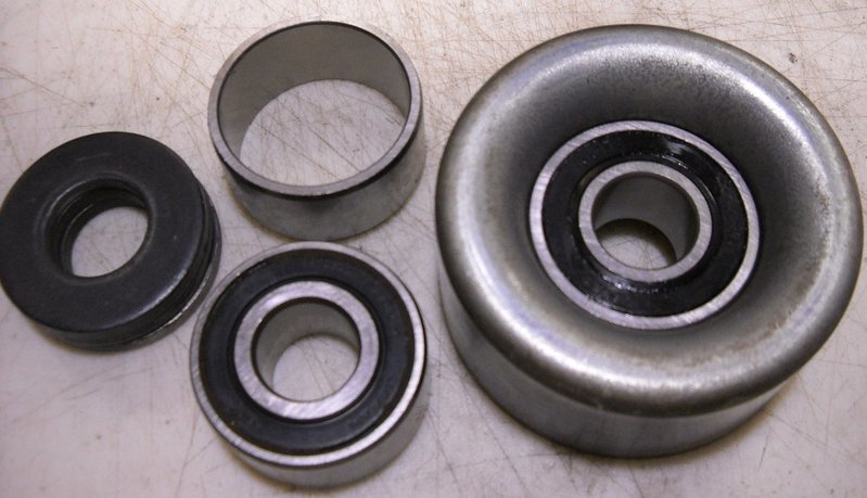

    The Nachi bearing, #5203-2NS was a direct fit for the tensioner pulley bearing. Replacing the bearings in the other pulleys is more of a challenge as they appear to use proprietary sized inner races. I could not locate them anywhere. The sizes are 10x42x13 for the PS and Alt idler pulleys; and 10x42x26 for the AC idler pulley. It appears I can fit 15x42x13 bearings by inserting a 15mm - 10mm bushing and using two bearings for the AC idler pulley. I have ordered the parts I think I will need and will post a how-to if it all comes together.
    Here is a pic of the tensioner pulley with the new bearing pressed in. I bought a 40mm outer race ($5) to push in the new bearing. You can probably use the old bearing but I didn't want to risk damaging the new bearing as you don't want to put any pressure on the inside race as you press it in.

    Yes, replacing the bearing in the tensioner pulley is much easier than replacing the assembly. Just make sure the assembly is not damaged and doesn't need replacing to begin with; it likely will not as the tensioners use an internal spring to maintain tension and the springs are pretty sturdy.
    Once you remove the bolt holding the pulley (turn clockwise to remove), the pulley slides right out. Then, it's just a matter of removing the bearing and pressing a good quality bearing back in. I'll be doing this on the wife's Lexus; looks like it's tensioner may use the same model bearing as the Taco.
