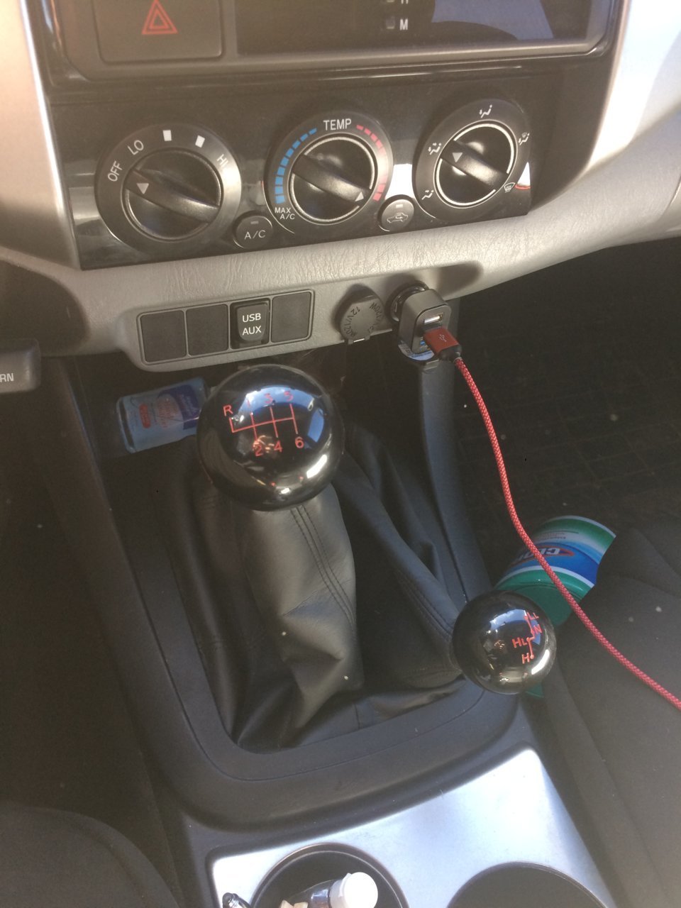

    I'm running the SOS 2"/3.5" drop on mine. Very happy with how it rides. Mine is a gen 2 but they make a similar kit for the 3rd gen

    Looks great! Love that side exit exhaust!
    Your truck is AWD?

    2009 Tacoma AWD Turbo 2TR-FE
    Full-time AWD & BorgWarner EFR 6258
    Thanks brother! and yes sir, i swapped it to a m/t FJ cruiser t-case so it's full time AWD with a 40/60 front/rear split.

    Damn!!! Super cool man!
    How much of a pain was the install?
    BassAckwards[QUOTED] likes this.
  10. Jul 13, 2021 at 12:29 PM
    #30
    BassAckwards
    BassAckwards Well-Known Member
    May 3, 2016
    #186002
    27,953
    It was a very easy install since i ran the Auto version of the FJ case before hand. So basically it was bolt up, and swap driveshafts to the DCSB v6 automatic ones since they were the right length. Took maybe two hours at most but i had done the ADD delete already previously

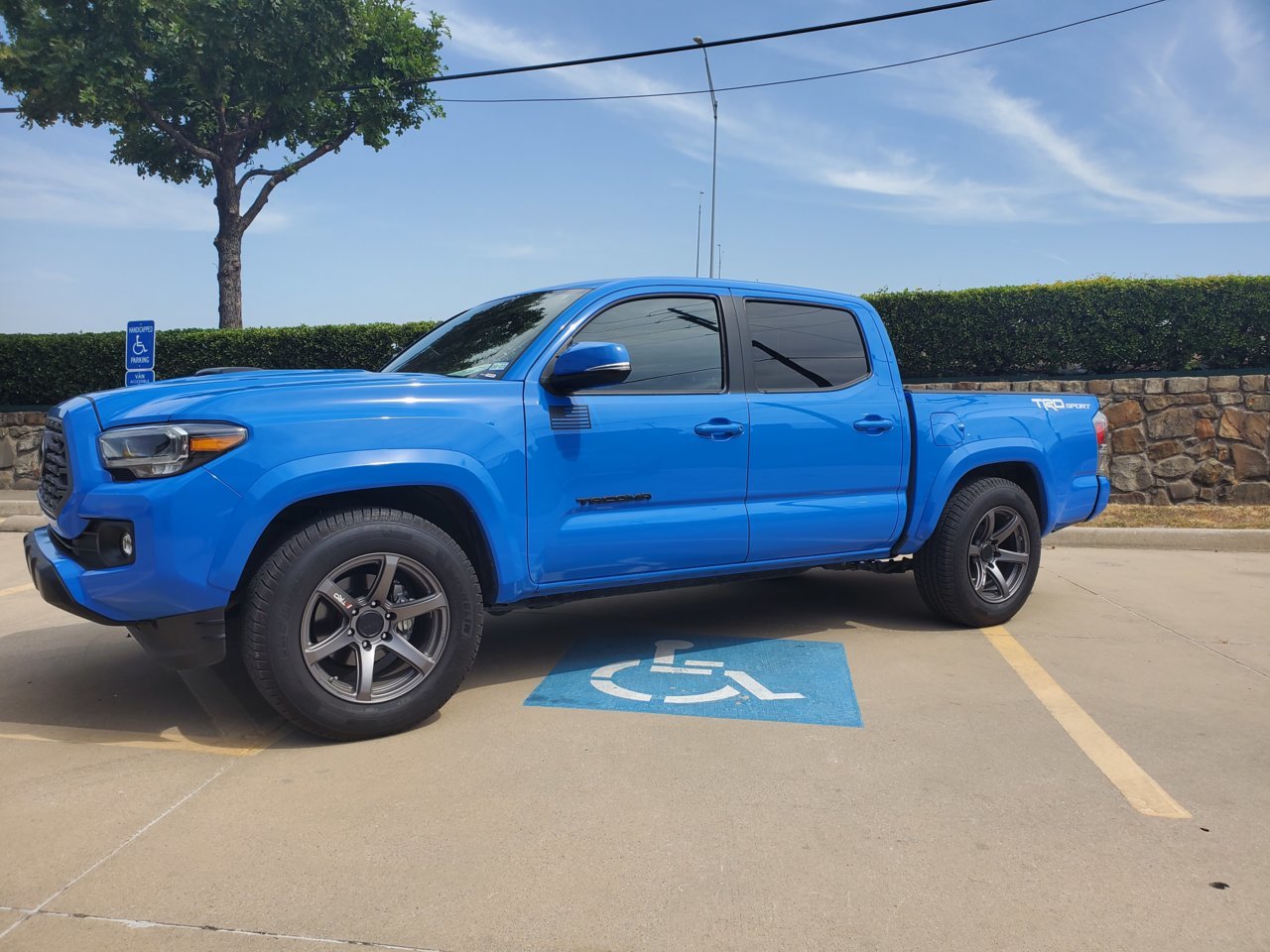

    Done! SOS Performance 2/3.5 drop kit. Love it! Looks awesome, handles great!
