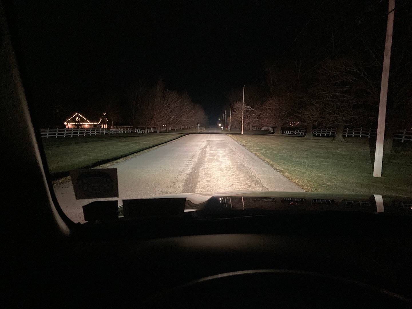

    I searched google for output shots of the LP9 and these were the best pics I could find (no telling how many pods are being used):

    That top LP9 still shot screams oversaturated camera settings lol. Without a direct, head to head comparison with the same camera and camera settings, there's no way to even begin to use pictures for fair comparisons.

    It does look oversaturated. But it's one of the few pics I could find so I just threw it up there. Hopefully someone in the know will be able to decipher everything and give us a real comparison and legit breakdown of both. Especially head to head.
