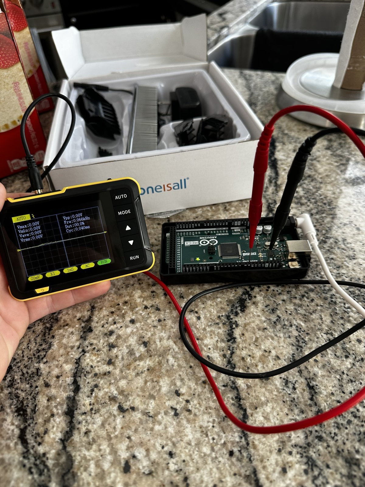

    First code revision from the Fiverr dude doesn’t work. lol.
    maybe soon I’ll have some working waveforms.
    this pocket oscilloscope is pretty cool.

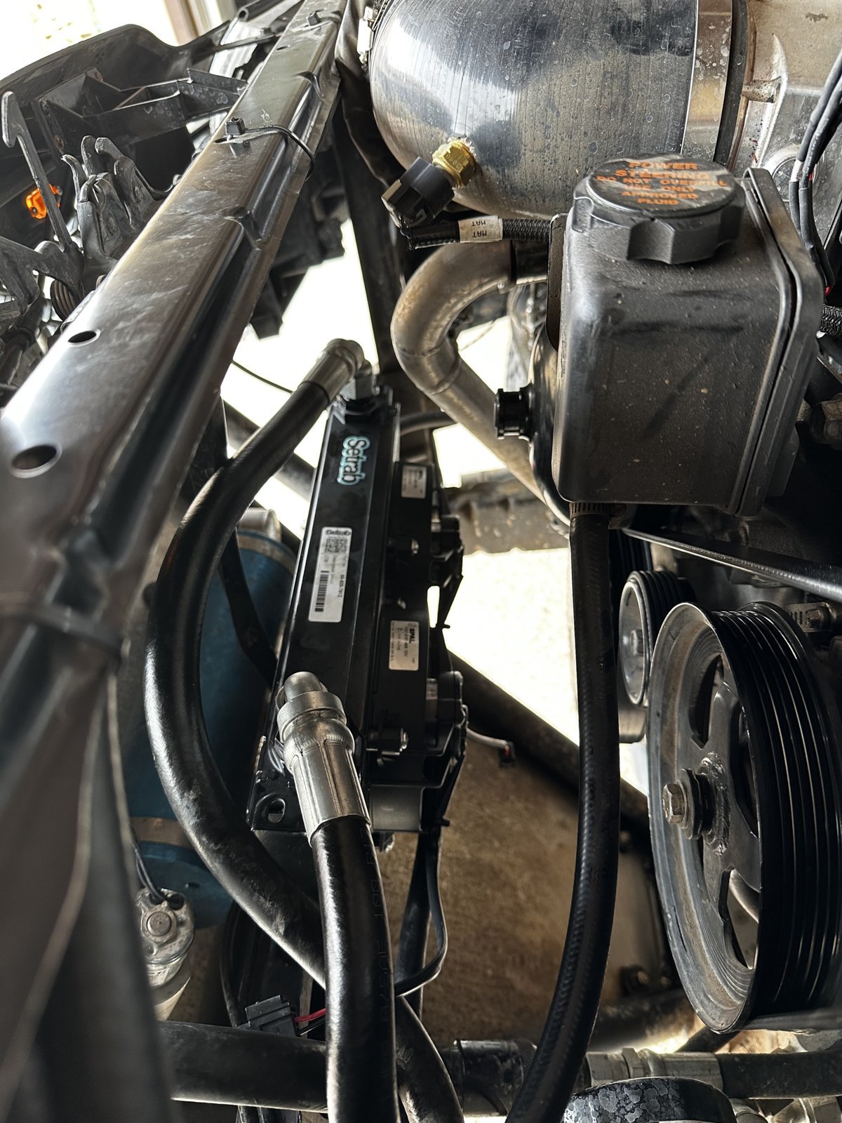

    Also in other small additions, I’m swapping out the 15 row oil cooler for a 20 row, so I can slap some spal fans on it. Also adding an oil temp gauge for the Holley, as well as driver side bank o2 sensor. Holley only comes with one for the passenger bank.

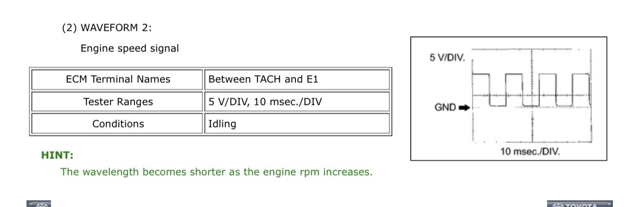

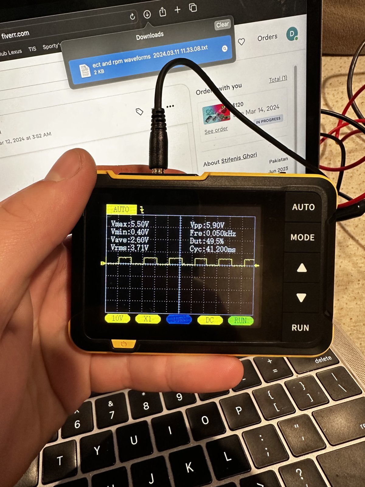

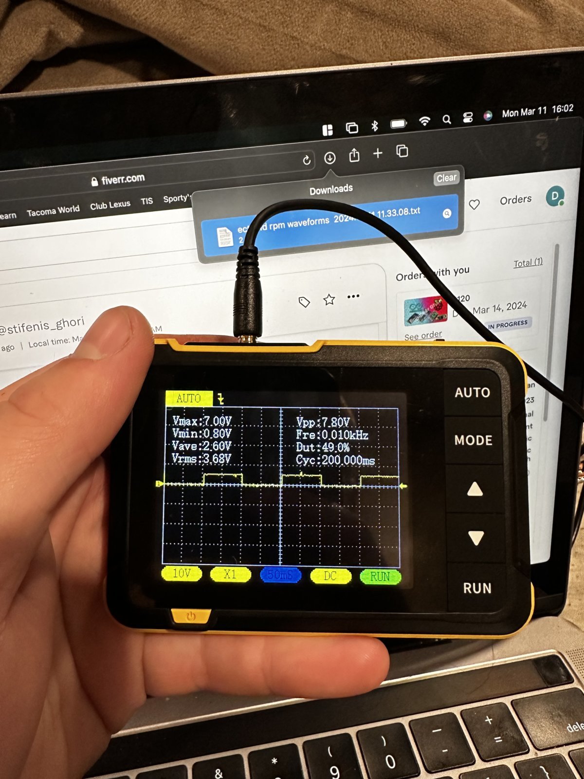

    ECT:
    RPM:
    he’s still working on the compressor lock waveform.

    Just have to try it and see, the factory signals are 0-12v but depending on where the threshold is in the module 0-5v may work

    Doesn’t the waveform call for 5v?

    It's 5v per division, each of the tick marks on the graph is a division.
    You can see it more clearly on the waveform I posted in Post 1247
    I'm not saying it won't work, I'm just saying it's not the same.
    The lock sensor signal can be a square wave as well, it doesn't have to be a modified sine wave. 0-5v would probably work here

    I guess I have a fundamental misunderstanding of how a scope works and what I thought I was looking at. lol. Now I don’t really understand or know what I’m looking at.

    I told him it needs to be 12v and he’s asking for this info:
    Give me peak amplitude values, duty cycle and time period of each waveform

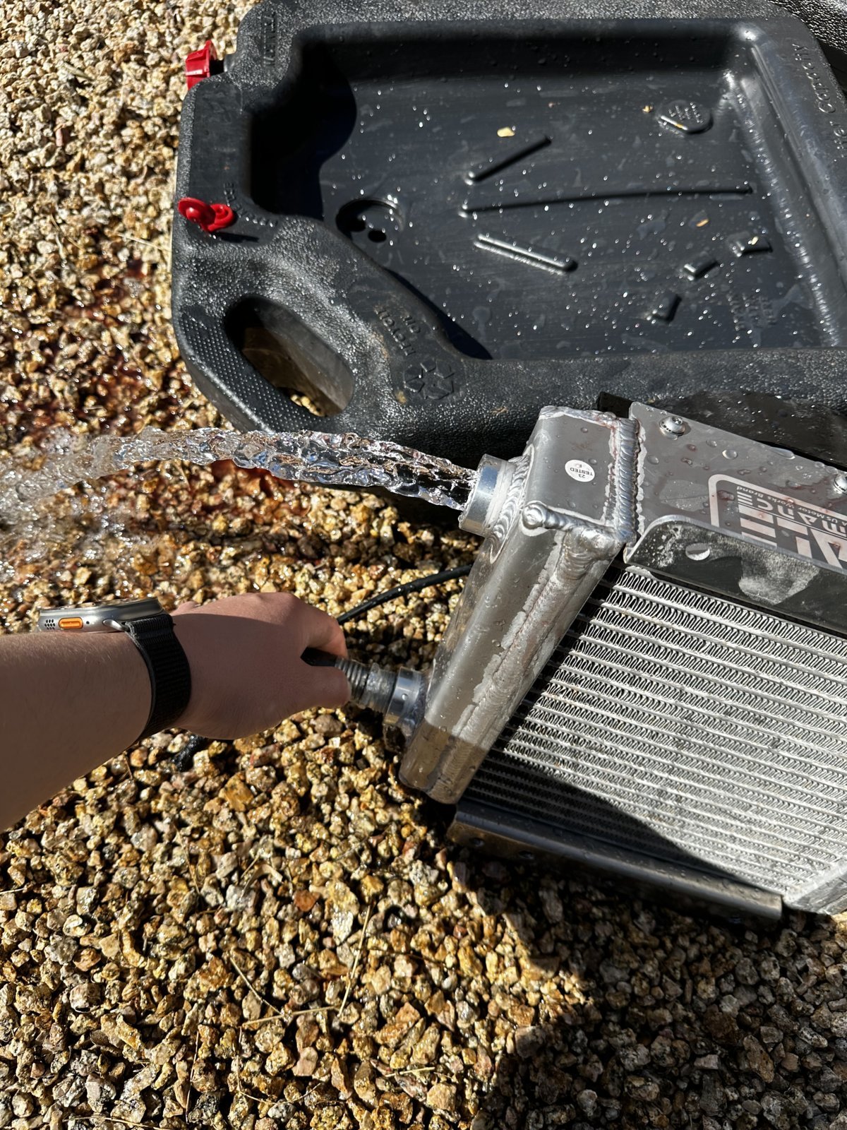

    Flushed the trans cooler with a garden hose and filled full of 99% isopropyl. Will let it sit like this for a while.

    Swapped out the 15 row for a 20 row Setrab cooler with a set of spal’s on it. Gonna wire these up to be triggered by the Holley once my oil temperature sender is installed.

    This should be what you need, Pico file is also attached in the zip file. It can be opened in the Pico 6 software which can be found here
    Idling @ 800 RPM Temp 180F
    Tach signal:
    0-12v square wave
    50% duty cycle
    12 ms high/12 ms low
    Temp Signal:
    0-5v square wave
    43% duty cycle
    180 ms high/238 ms low
    Lock Sensor:
    2.4-2.7v sine wave
    50% duty cycle
    55 ms peak to peak
