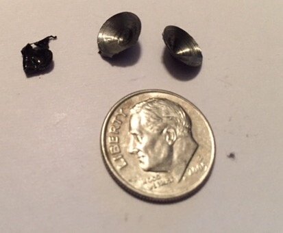

    A few of the pieces from my rear differential magnet.
    Alexely999, Torspd and shakerhood like this.

    I thought you pulled a dime out of your rear diff for a second there, lol.
    Those pieces of metal look concerning...I've never had anything like that come out of my rear diff on my 2004 Tacoma, and I wheel it pretty hard.

    You put those back in there Mister!

    And that is why we follow preventive maintenance. So that we don't do costly repairs instead. Good job OP. :thumbsup:

    i had the same pieces in mine!! as a machinist myself, i diagnosed them as a drill tip breakthrough during the manufacturing process. they're heavy enough they should have gone straight to the magnet.

    Damn dude, you have a coin mint in your diff!

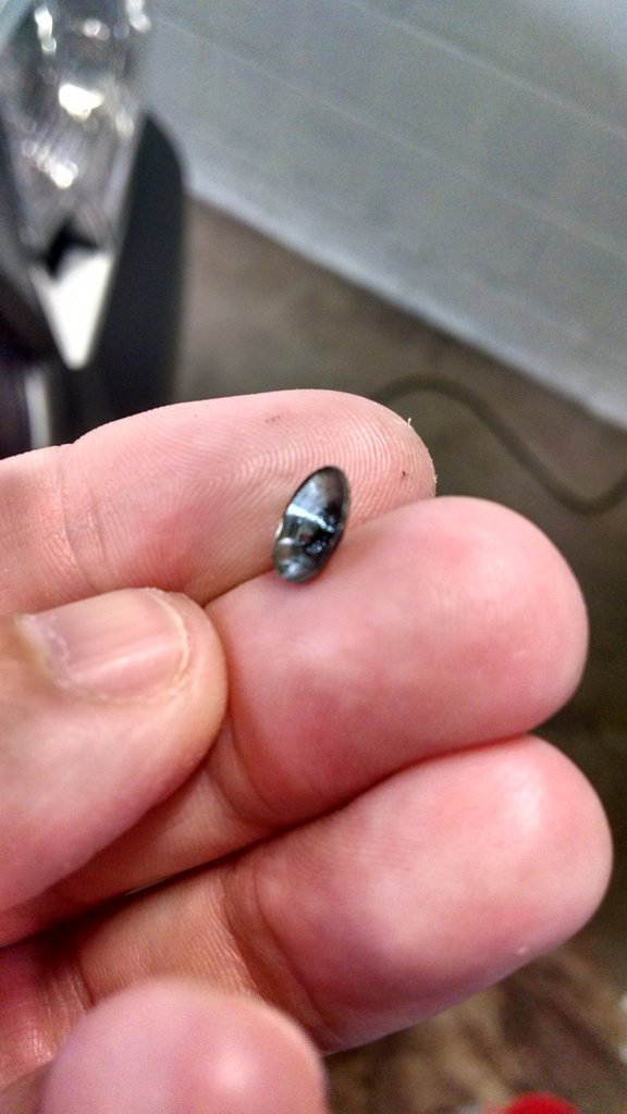

    Changed the drive-line fluids today (~27,xxx on the clock):
    -transmission: Red Line MT90 75w90 (GL-4 is required)
    -transfer-case: Mobil 1 75w90 (Gl-4 or GL-5 is required)
    -rear differential: Mobil 1 75w90 (GL-5 is required)
    -front differential: Mobil 1 75w90 (GL-5 is required)
    Used Red Line MT90 75w90 for the transmission, then put the remainder of 3rd bottle into the tranfer-case and mixed it with the Mobil 1 75w90. In total 9 qts are required to do the full drive-line.
    These were great resources for fluid choices:
    -GL-4 v. GL-5
    http://www.widman.biz/uploads/Transaxle_oil.pdf
    -Toyota's outline of capacities, capacities, and viscosity requirements for the Tacoma
    http://www.ttguide.net/maintenance_data_fuel_oil_level_etc_-158.html
    All-in-all, super easy job. Just had to buy 10mm hex socket and 24mm 6 point socket as those aren't typically included in most tools sets.
    Typical sludge was on magnets and fluid was no dirtier than anticipated.
    Found this in the rear differential, attached to the plug's magnet:

    That piece of metal looks just like what the guy posted a few days ago in this thread, up above. Guess it's common...I've never had any thing like that come out of my diff
