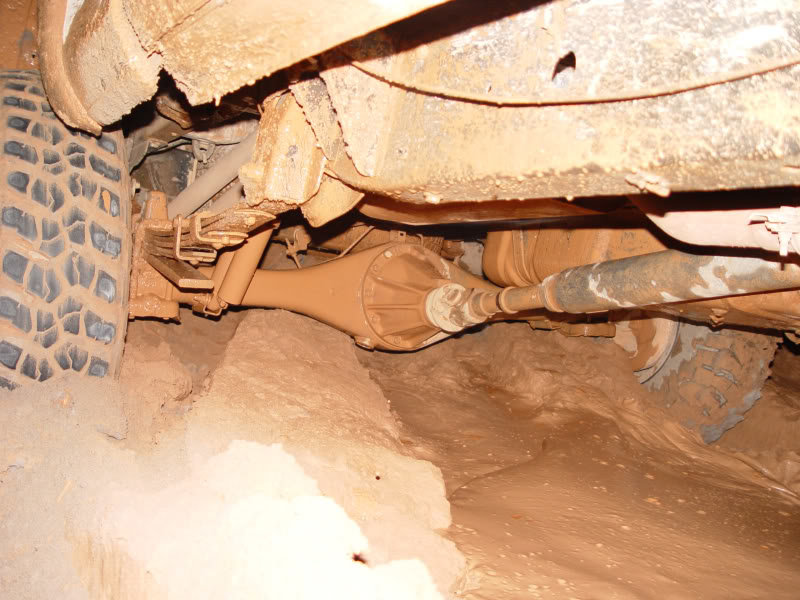

    Imagine Auto LSD in this mess...that is abrasive muddy clay ..it eats drum brakes for lunch and dinner!!!
