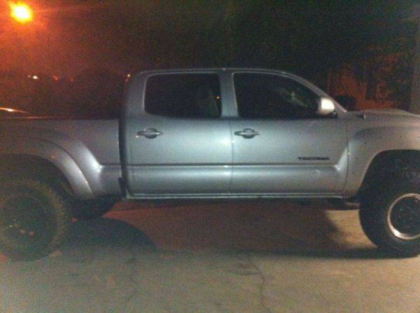

  5. Jun 27, 2012 at 10:50 PM
    #965
    jlvhrse
    jlvhrse [OP] Well-Known Member
    Aug 8, 2009
    #20838
    3,067
    Jen
    SoCal SGV
    2009 TRD Sport 4X4 Long Bed
    LSK front and rear LT and stuff
    leaf springs installed
