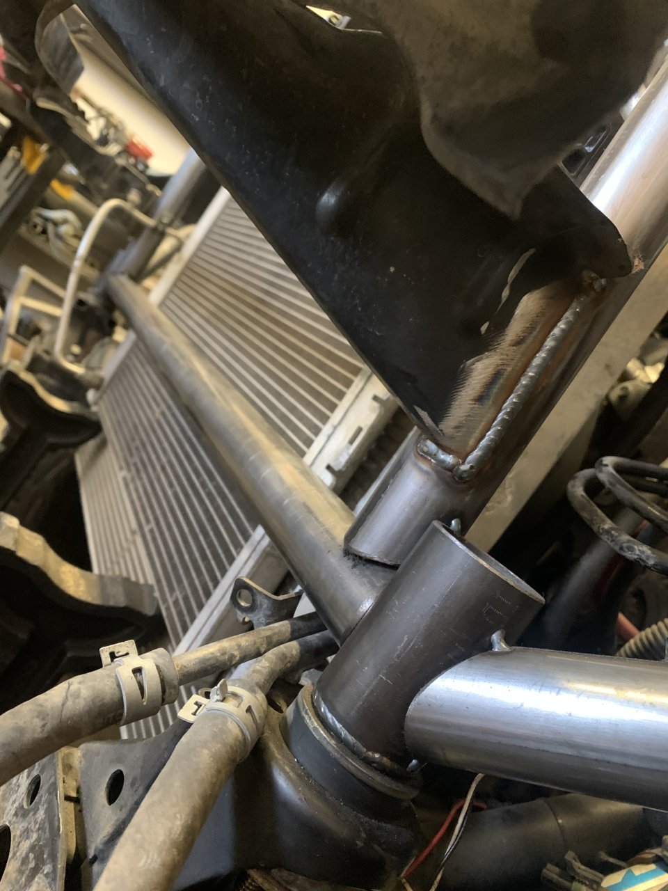

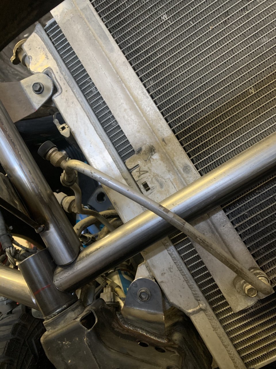

  6. Oct 29, 2020 at 8:35 AM
    #46
    lemons6245
    lemons6245 [OP] Well-Known Member
    Oct 23, 2018
    #270396
    73
    2012 Tacoma Prerunner 4x2
    LSK race long travel, King 2.5x10 coilovers, 2.5x10 bypasses and 2.0 bumps. 2.5 Tundra fox rear DSC shocks, Icon RXT pack, Icon bump stops. 4.88 w/ TruTrac. AFE Y Pipe, URD cat-back. CSF radiator, OVT 91 tune, Ripp coil packs.

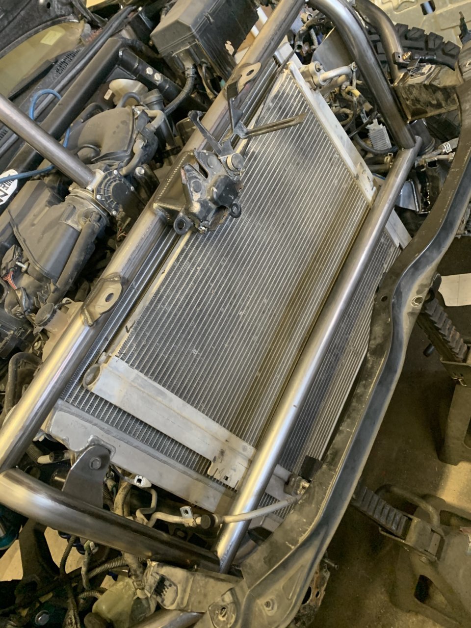

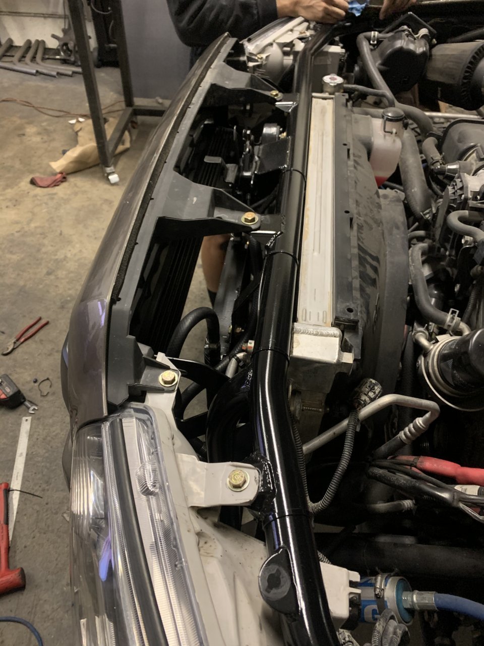

    While this kit is awesome and can take whatever you can throw at it, the flimsy core support unfortunately can not. Problem solved though!

  7. Dec 23, 2020 at 12:02 PM
    #47
    Sterling_vH111
    Sterling_vH111 Go do something real instead.
    Oct 4, 2015
    #165793
    3,008
    Sterling
    socal
    2012 DCLB Prerunner V6
    Secretly Long Travel & Supercharged
    Any more updates from the core support Devin ?

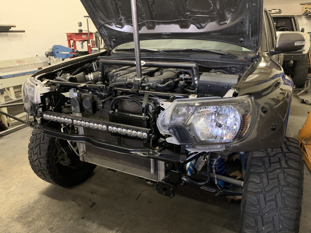

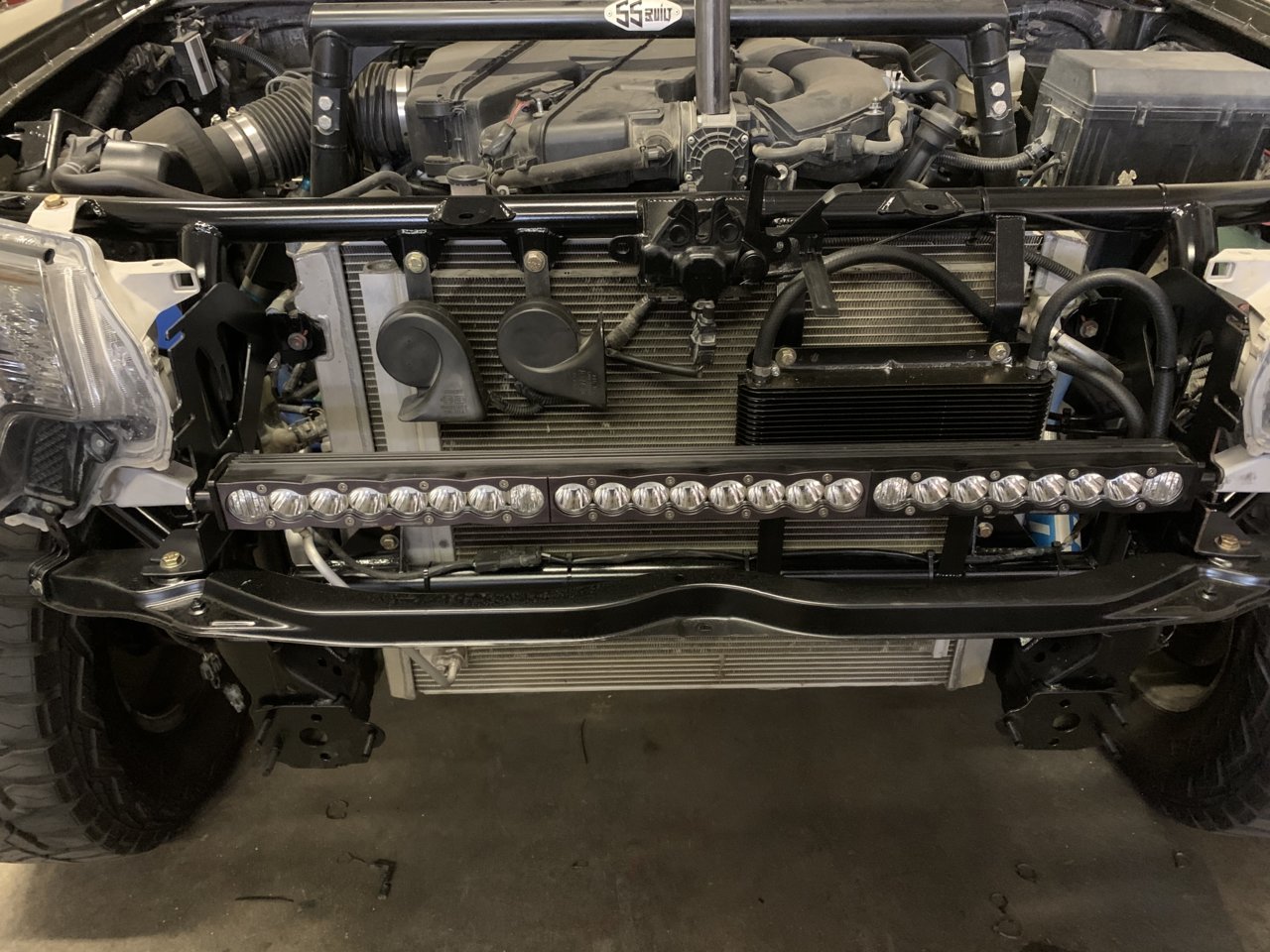

  9. Dec 23, 2020 at 1:37 PM
    #49
    lemons6245
    Oct 23, 2018
    #270396
    73

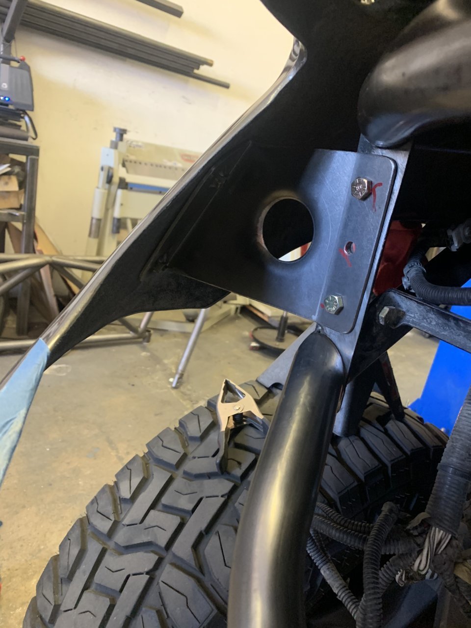

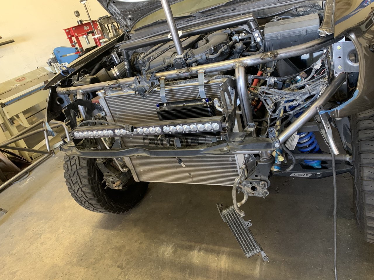

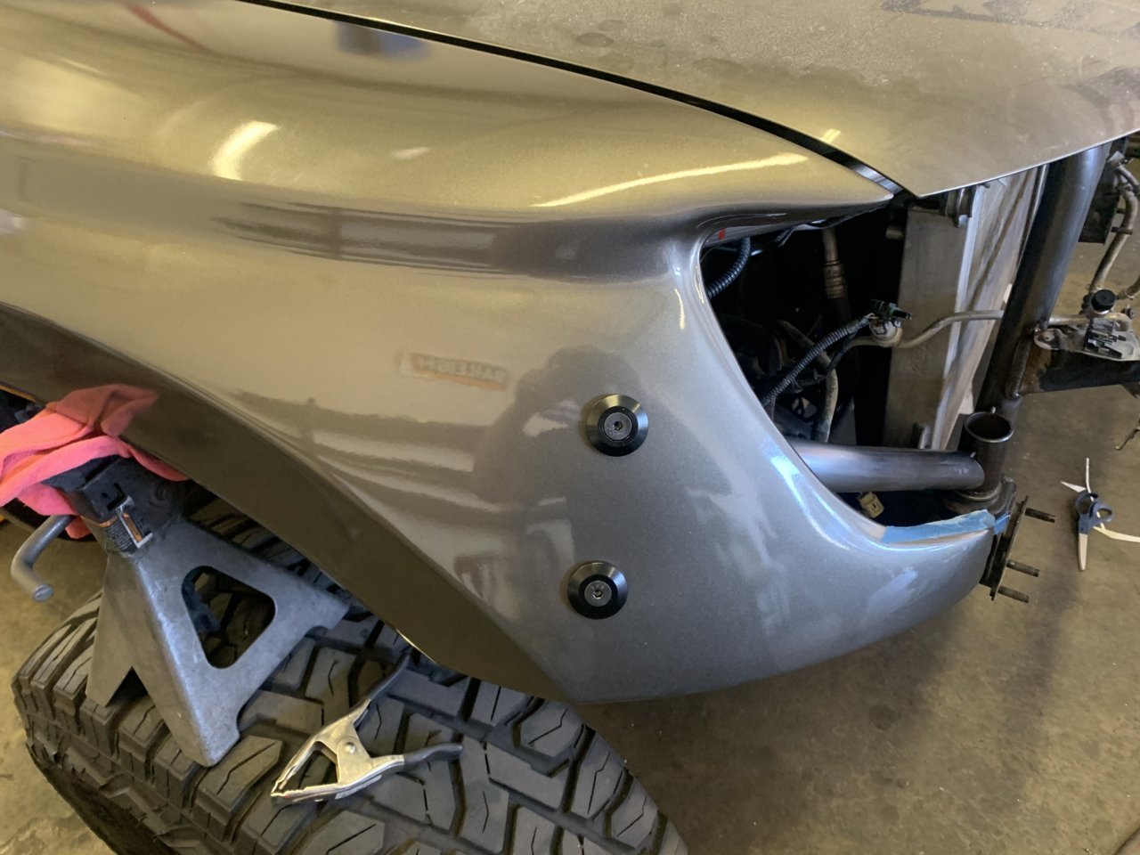

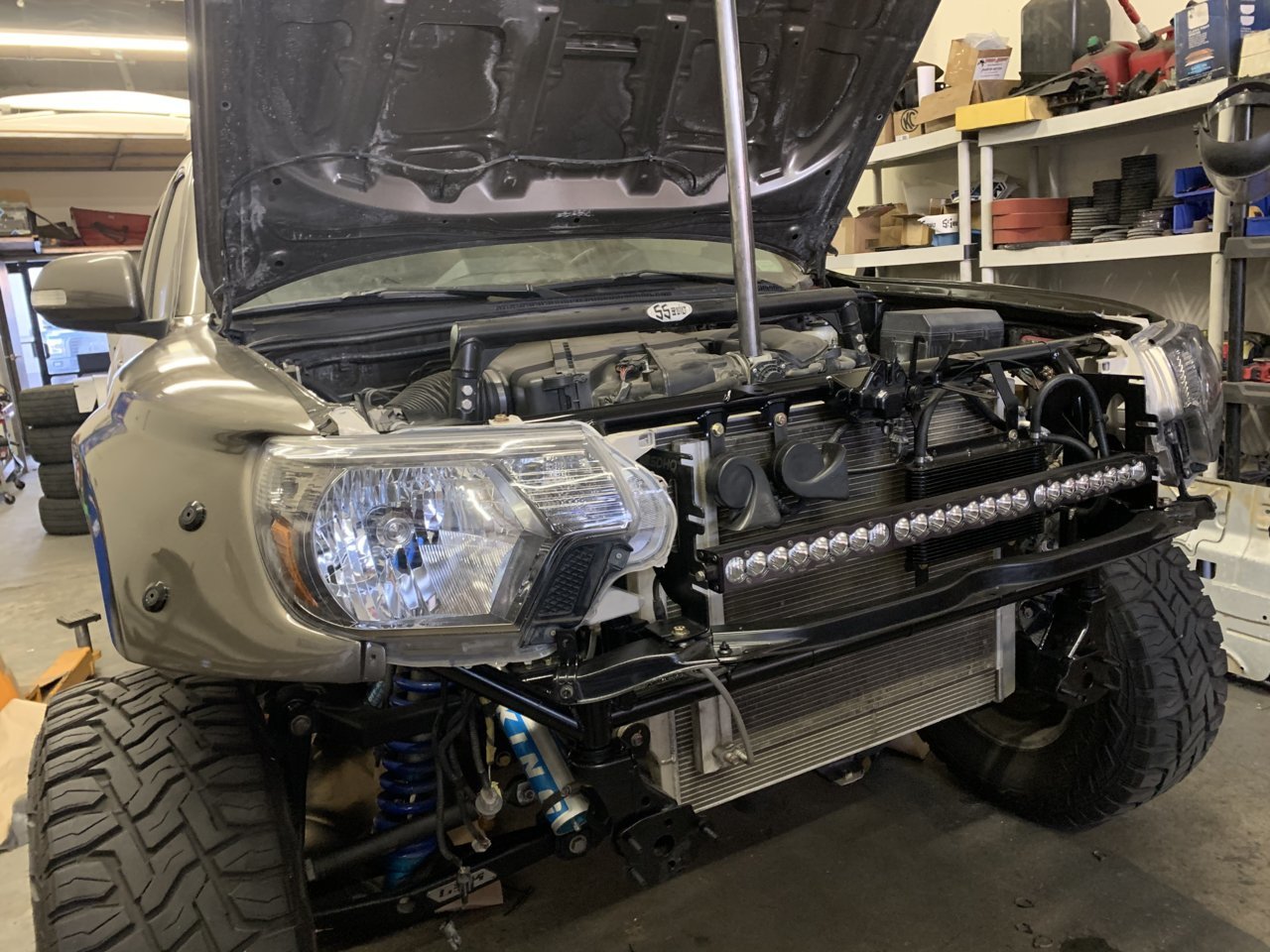

    Yeah core support is finished. Turned out great. The truck does vibrate more with my solid motor mounts but ‍Race truck i guess? Hahaha
    Had to trim the inner fenders, last time out in Johnson valley I was at lock and hit a bump and caught one. We were going to go with hood pins not knowing if factory hood latch would work but it did. Upgraded the factory trans cooler to a new B&M one and moved the horns over to passenger side. Part of the old support was used for the bottom of the headlights and also for the light bar. Where the new support meets the side supports was welded to each other now so if I need to take the front clip off it is 8 bolts for the assembly and the the 4 holding the radiator on and I would need to release the A/C line and the whole thing comes off. Only had part is the back of both headlight needed so there was a hole that was was then patched on the back of the headlights so they would fit with the new support.

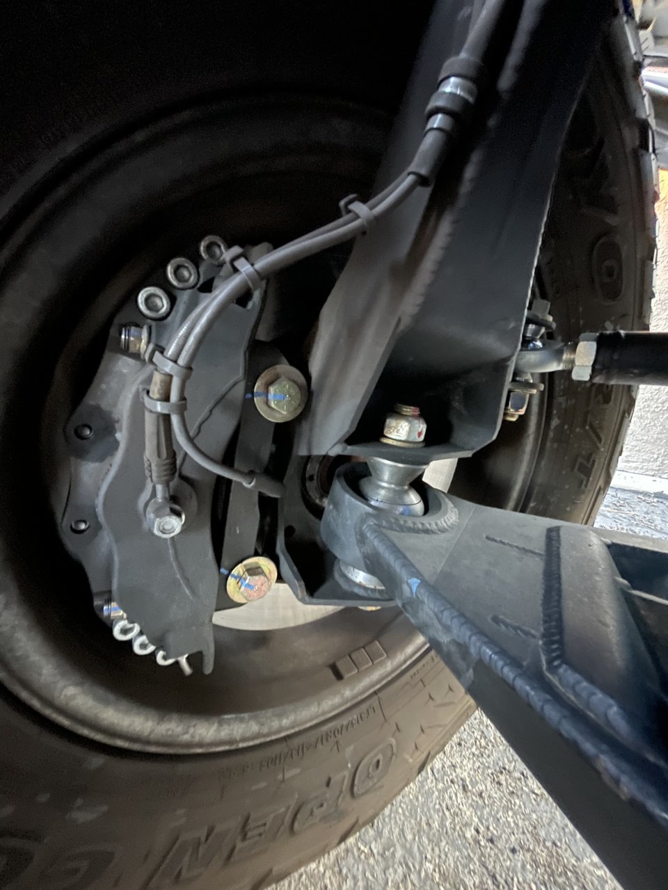

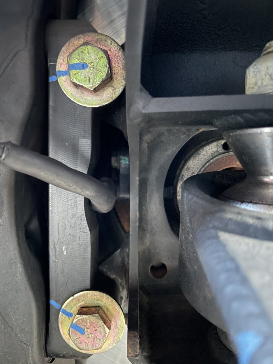

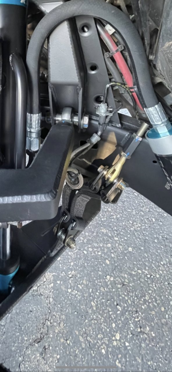

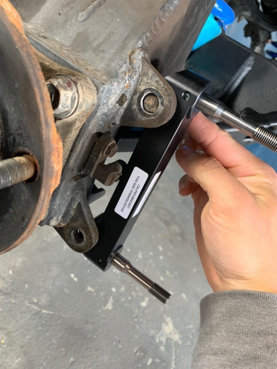

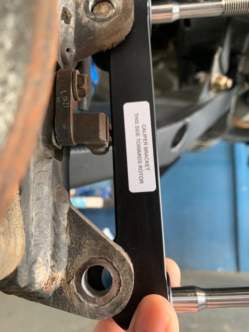

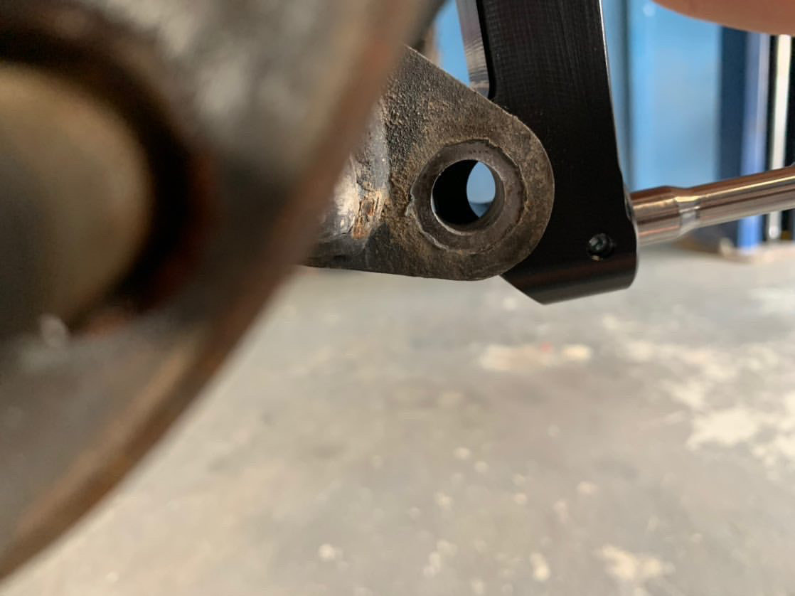

    Just wanted to throw this out there for people who were thinking about the LSK kit and possible big brake kits. The LSK race kit first of is fantastic, they did move the abs sensors to the back side of the spindle I believe due to location with the steering link and also to protect against things hitting and damaging the abs sensors. I was so worried about making sure the calipers were going to clear the wheels I didn’t even think about the sensors. I purchased the SOS 6 piston stoptech kit and the abs sensors do hit the bracket that mounts to the spindles. I have posted pics below. My fault for not double checking everything, but just though for anybody that is thinking about doing big brakes with the LSK race kit.

    What did you do to get the big brake kit to work with the LSK long travel spindles?
    -B
  15. Mar 23, 2021 at 9:00 AM
    #55
    lemons6245
    Oct 23, 2018
    #270396
    73
    The shop I had it at Kaizen off-road had to modify the speed sensors. So he cut the plastic connector ends off the sensor and the harness side. Hardwired the wires straight to the pins on the sensor and then used high temp glue to make sure no moisture got in, and shaved down the mounting bracket a little. I’ll see if I can grab some pictures later

    Here are some pics of it on the truck.

    Damn that's a TIGHT fit!

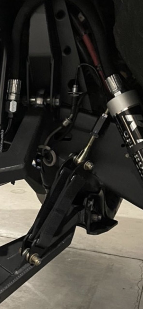

    There is a tab on the backside of the lower control arm for a limit strap. It does not give you any top portion for because there are so many different set ups. I have actually changed mine from the original post. The first set up was with an 11 inch single strap that was non adjustable. I have since switch to the TMR adjustable with duel 10 inch straps to fine tune the limit of droop. Kaizen really helped dial that in and make sure that the tie rod ends were not binding at full droop.
