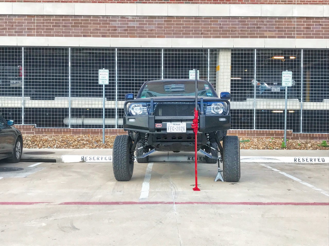

    Thanks! I drooped it for the first time on 33s and it isn't disappointing:D. I havent put limit straps on yet, this is where I plan to limit it.

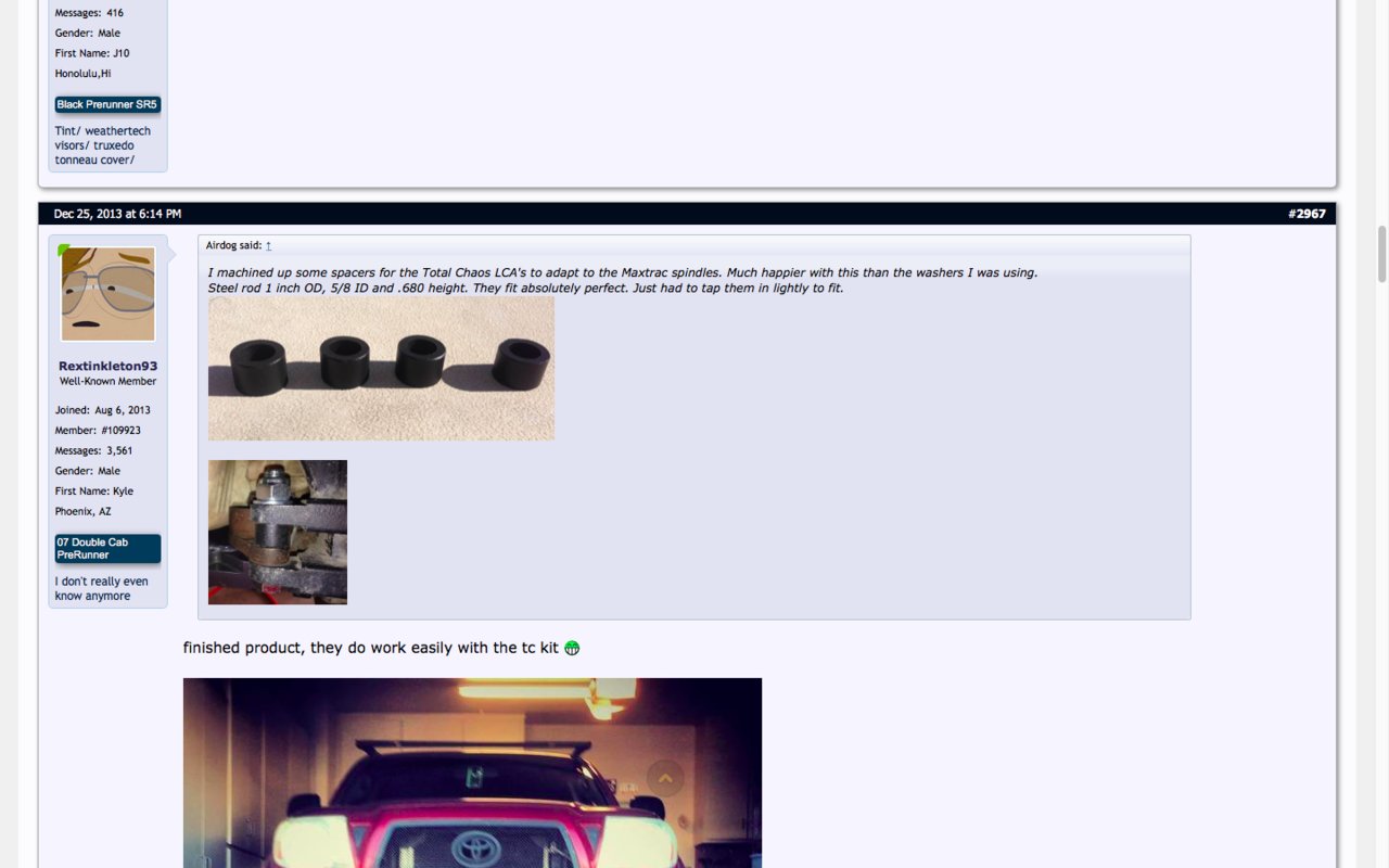

    Does anyone have a picture of the spacer I would need to make my Camburg kit work with my maxtrac spindle?
    Ordered the kit and I’m arill a little confused at what I need to do.

    Camburgs uniball adaptor is 3/4" thick, measure the spindle to see how big the ball joint attachment is on the spindle. If its bigger than 3/4", you just need to come up with a sleeve around the bolt to take up the slack. Ive seen a picture but i cannot find it and ill let you know if I do

    Ok thanks for the info! If you come across the pic I’d love to see it

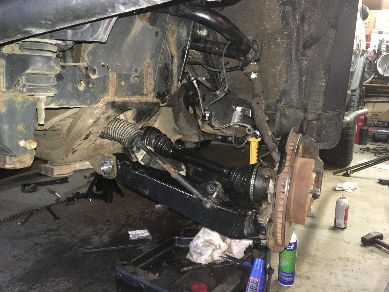

    Hey, anyone have issues with axles contacting their LCA’s?
    This OG Camburg kit is kicking my butt.
