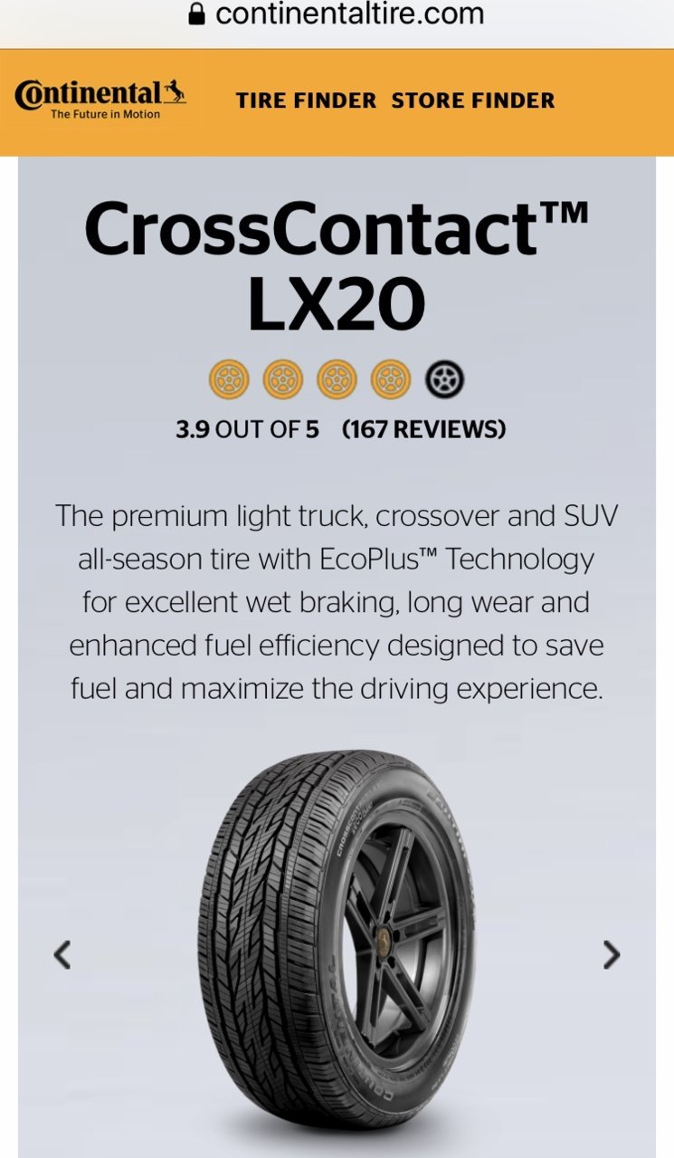

    For premium tires (I know, Michelin blah, blah, blah). I’d like to try a set of Conti D908BD12-406F-4F2C-B4FD-8B99C5FC3C79.jpg and maybe get even better highway fuel economy
    Fightnfire likes this.
