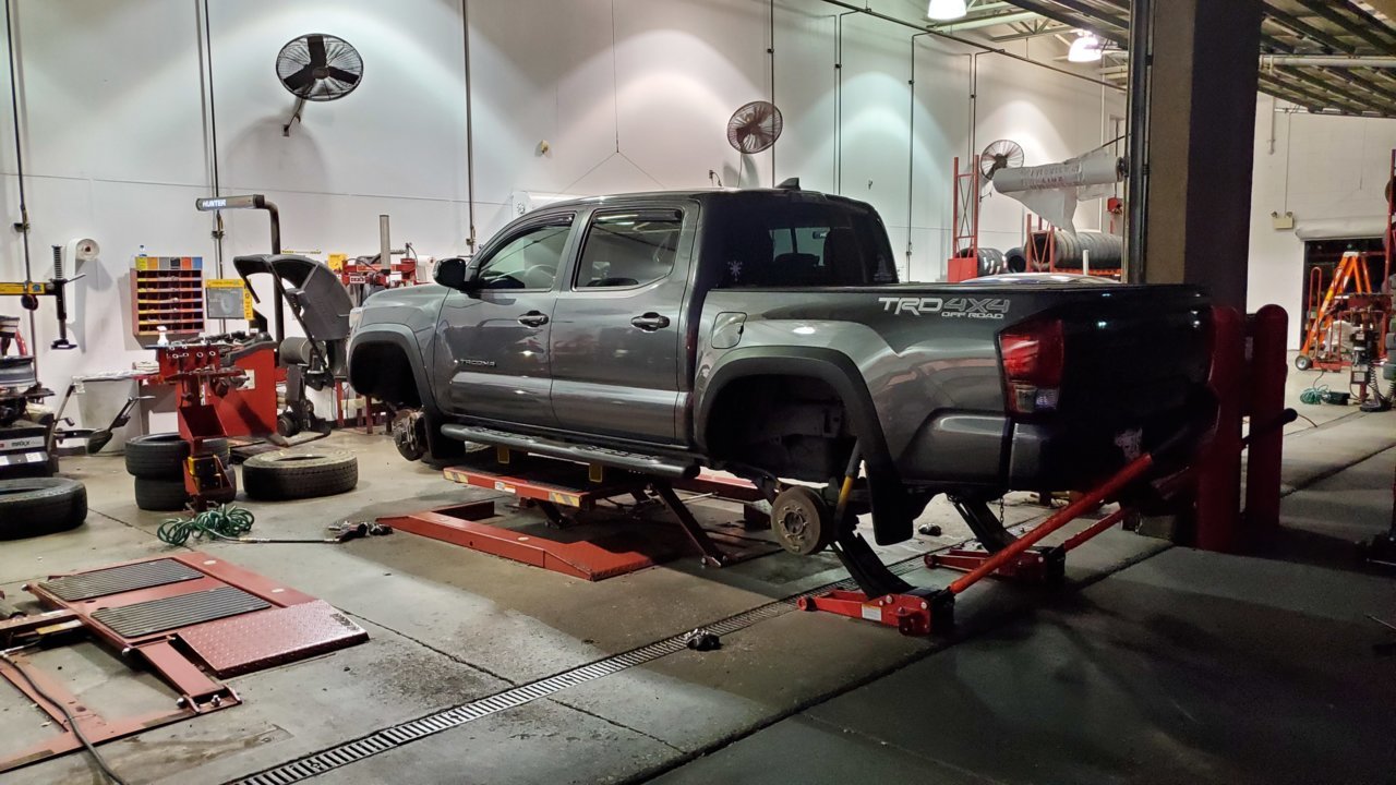

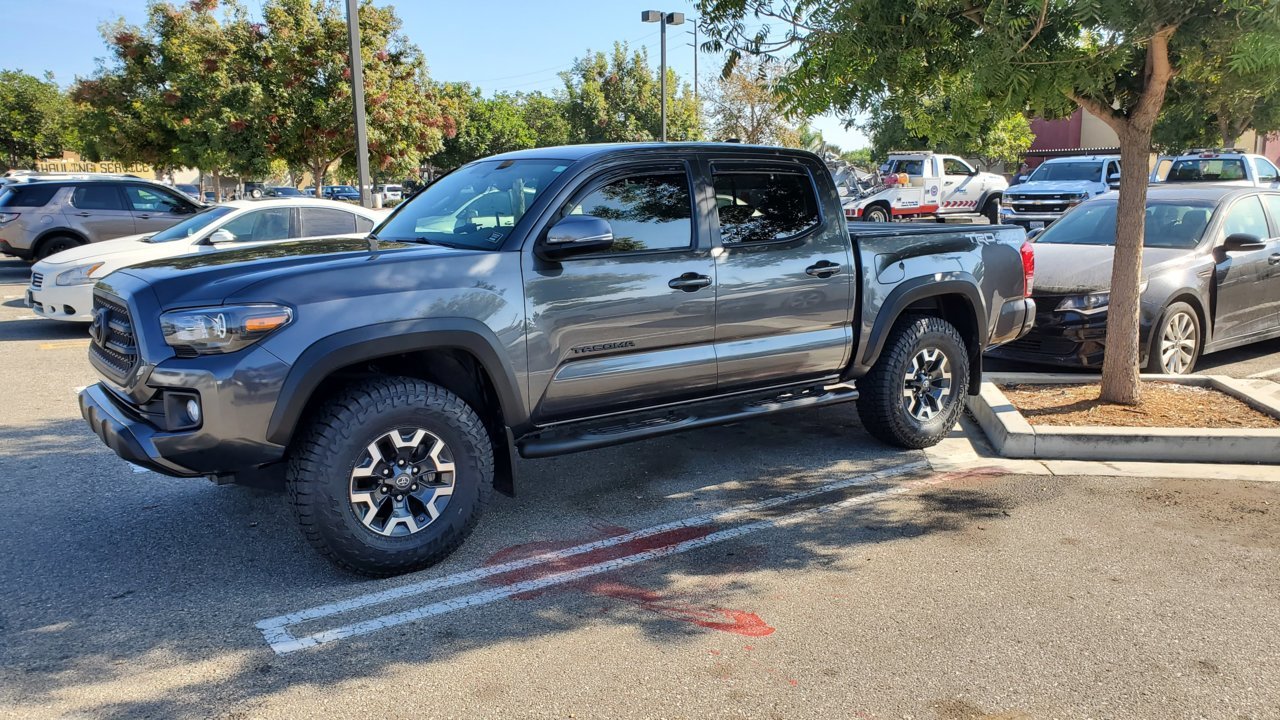

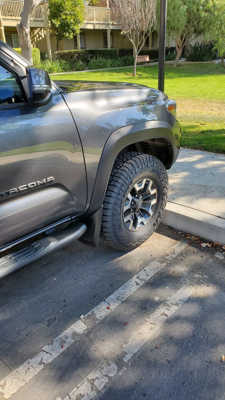

    BakFlip tonneau cover. Rexing front and rear dash camera. Leather seat covers Dessert Does it seat jackers TRD Pro Front grille OTT ECU 285/70/R17 Falken Wildpeaks AT3W. Methods 703 Bronze 0 offset Fox 2.5 with Remote Resi with DSC adjusters front and rear ICON Tubular UCA Cab mount chopped Superbump bumpstops with Ubolt Flip kit Meso customs interior black out kit with LED white/red map light and dome light and TRD shift knob with hidden buttons Kustom 45 headlights with rgb halo ring.
    Welp, gonna see how the 265/75r16 Falken Wildpeaks A/T3W 10plys are gonna be.
