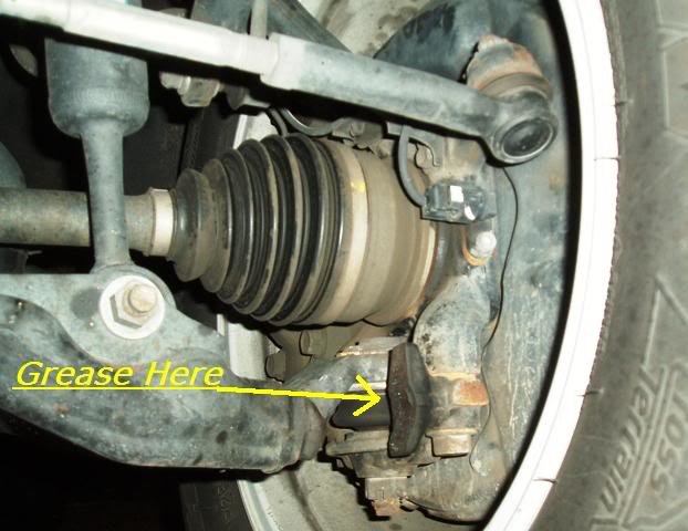

    BTW the steering stop also needs to be greased:
    If the creaking happens when steering wheel is turned all the way you need to grease the bump stops:
