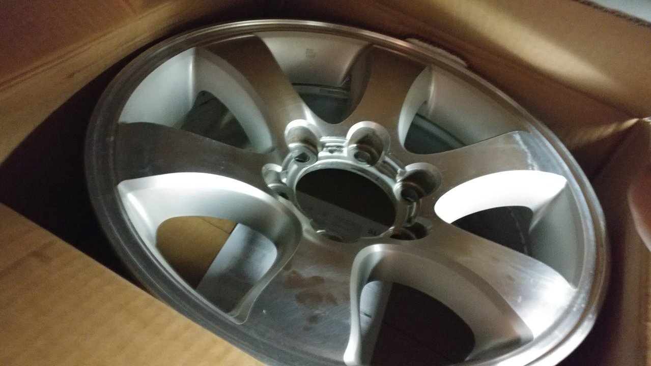

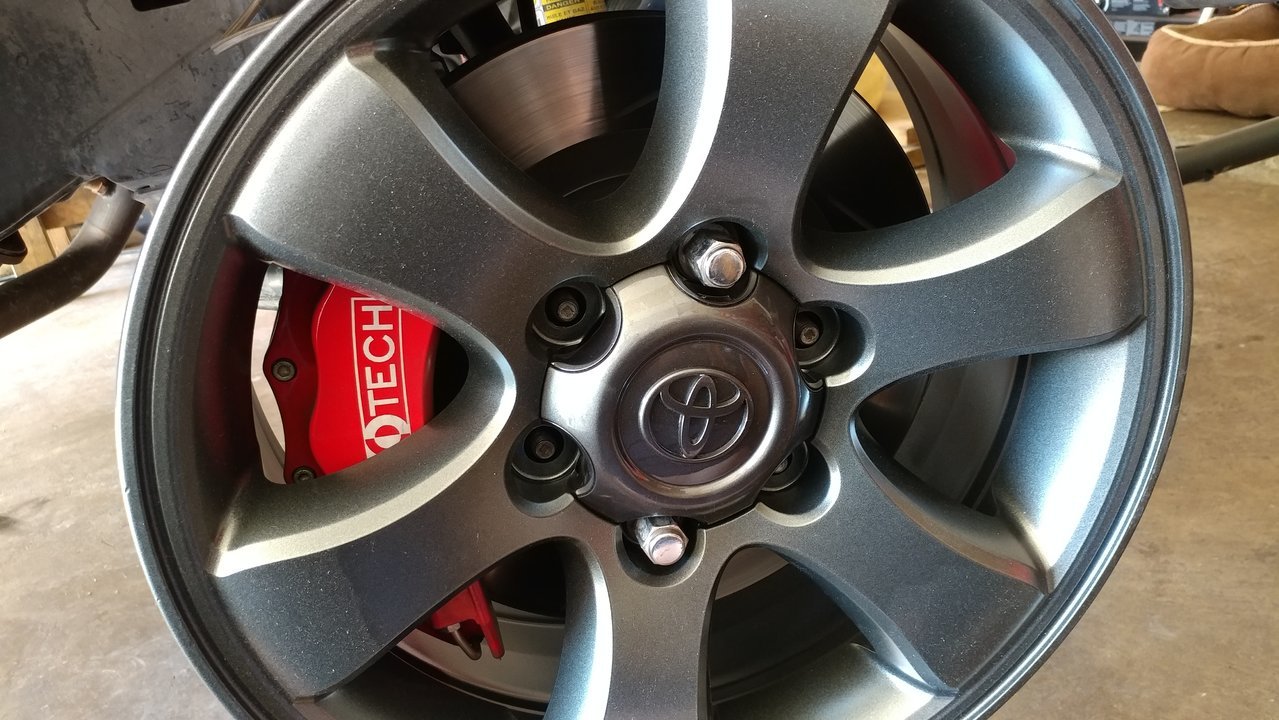

    Went from this
    Currently looking at new 265/65/17 tires. Thinking of trying michelin tires.

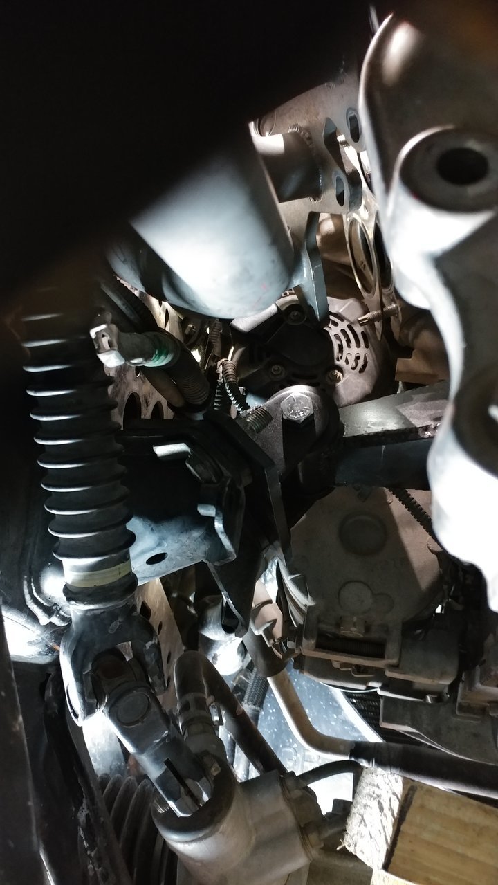

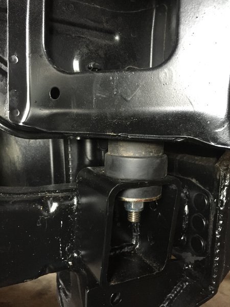

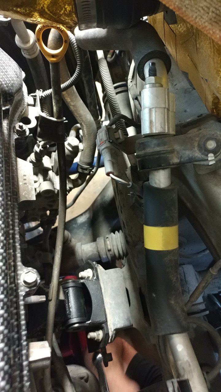

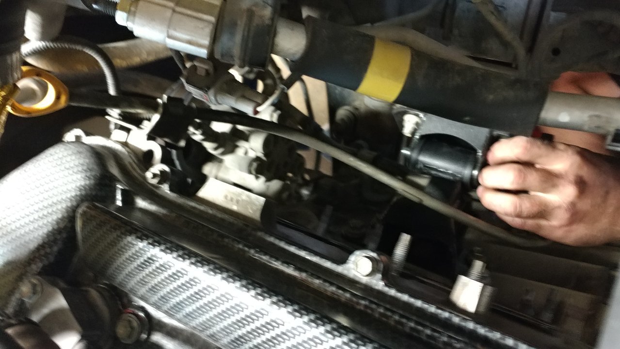

    Figured id post my review on the motor mounts Torspd and I installed. Pros - less weight on the nose and the response does feel better, be it coming out of a corner or accelerating from a roll. Makes engine installs a bit easier and access in the bay is better to work in. Cons - I do not like the rattle coming from the dash. I think something is loose so ill look at it and try a good quality gasket, remove whatever is reverberating, or try that sound deadener. There is also the vibrations but I can tolerate that. It is the nature of the beast. So would I do it again? If this was my daily driver, more than likely not. Since it isn't my daily I can troubleshoot the rattle and enjoy the pros.

    Which mounts did you use?

    @Bonzen made them.

    Correct, and I'm currently looking at mounts for the transmission and size out poly body mounts.

    Cool, that's what I thought they looked like. Need to do something with my mounts soon, probably buy his for the motor and make my own for the trans.
    Poly body mounts have been impossible for me to come by for our trucks I have found, I did a custom job for the radiator but I think that led to major cracking in my core. Found a company that does OEM like replacements, but they are still rubber, let me know if you find something in poly, I would be all about that.
    https://www.febest.us/catalog/rubber-parts?body=&brand=TOYOTA&model=4-RUNNER&p=4&year=2004
