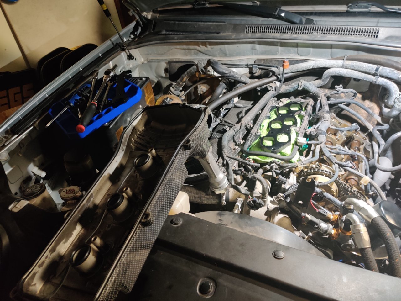

    Also I did finished up the gasket swap last night. Plugs were oily but were cleaned up.

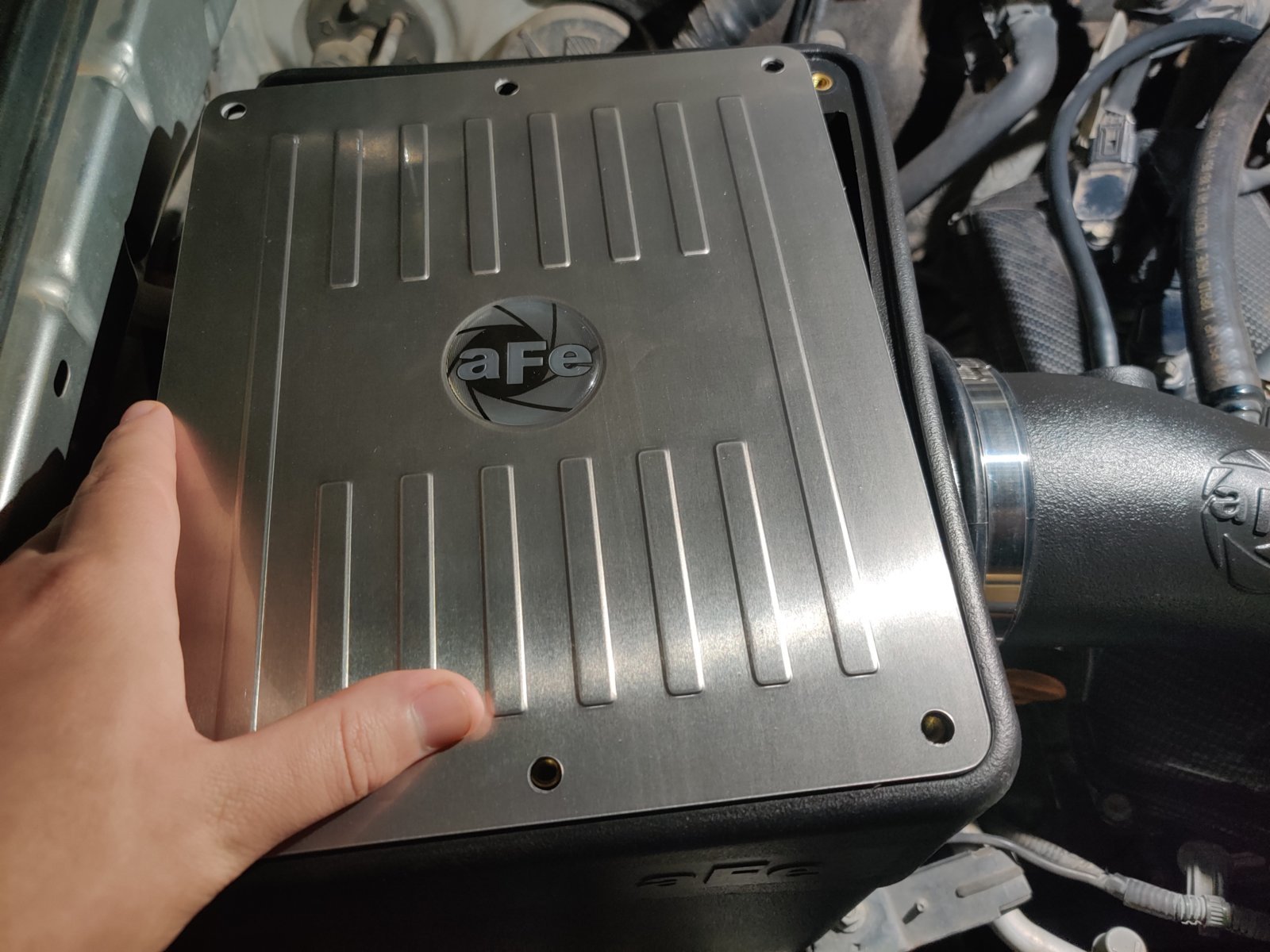

    New intake for the 4runner as I had commandeered it for the Tacoma to help smooth out the maf signal.

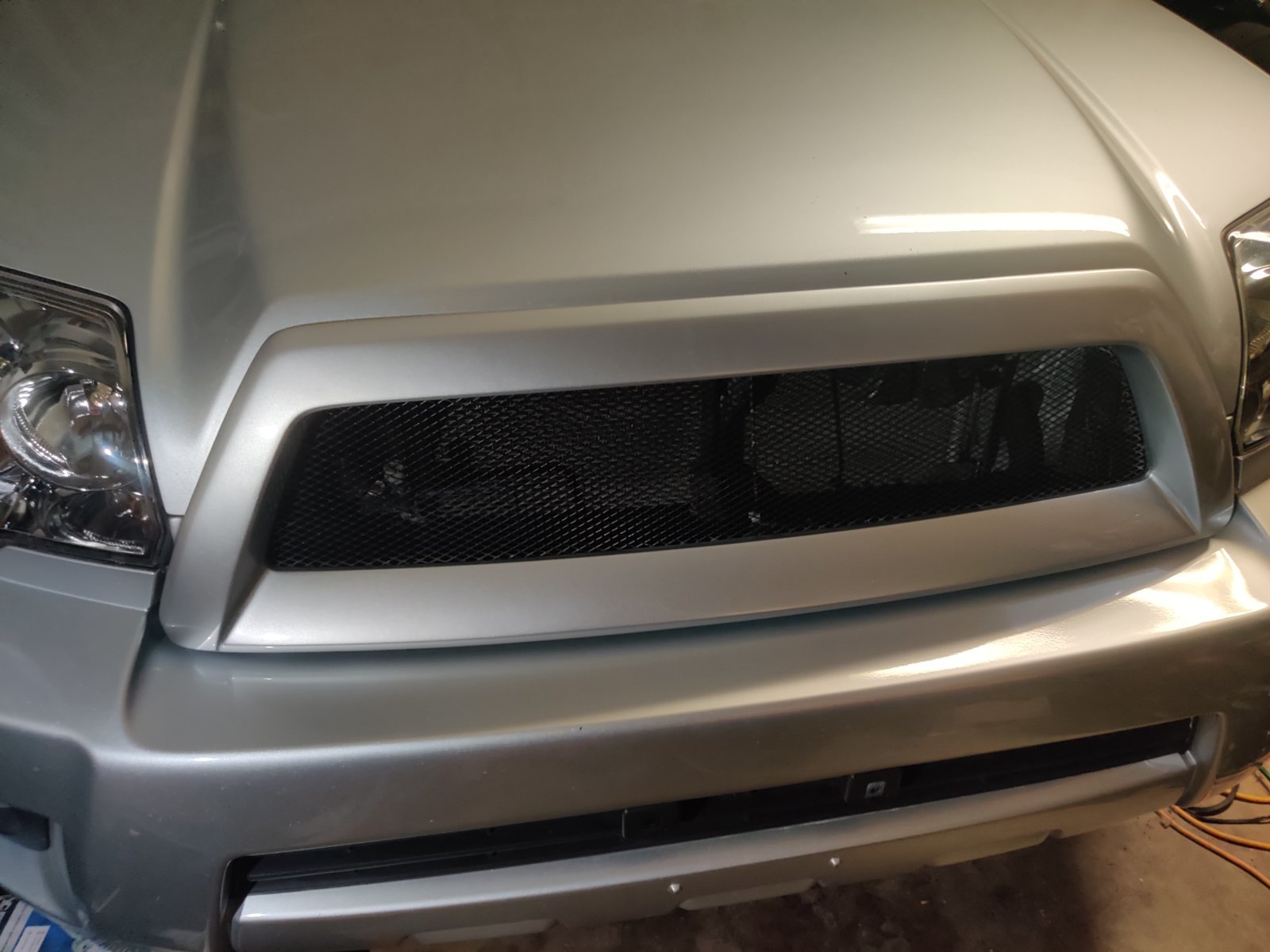

    Back from paint

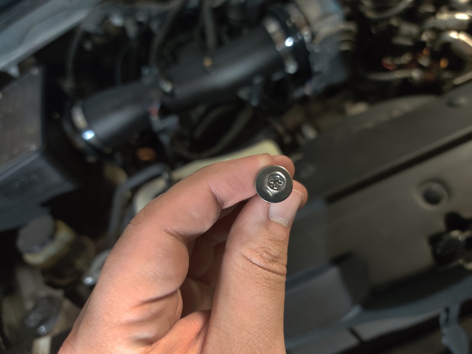

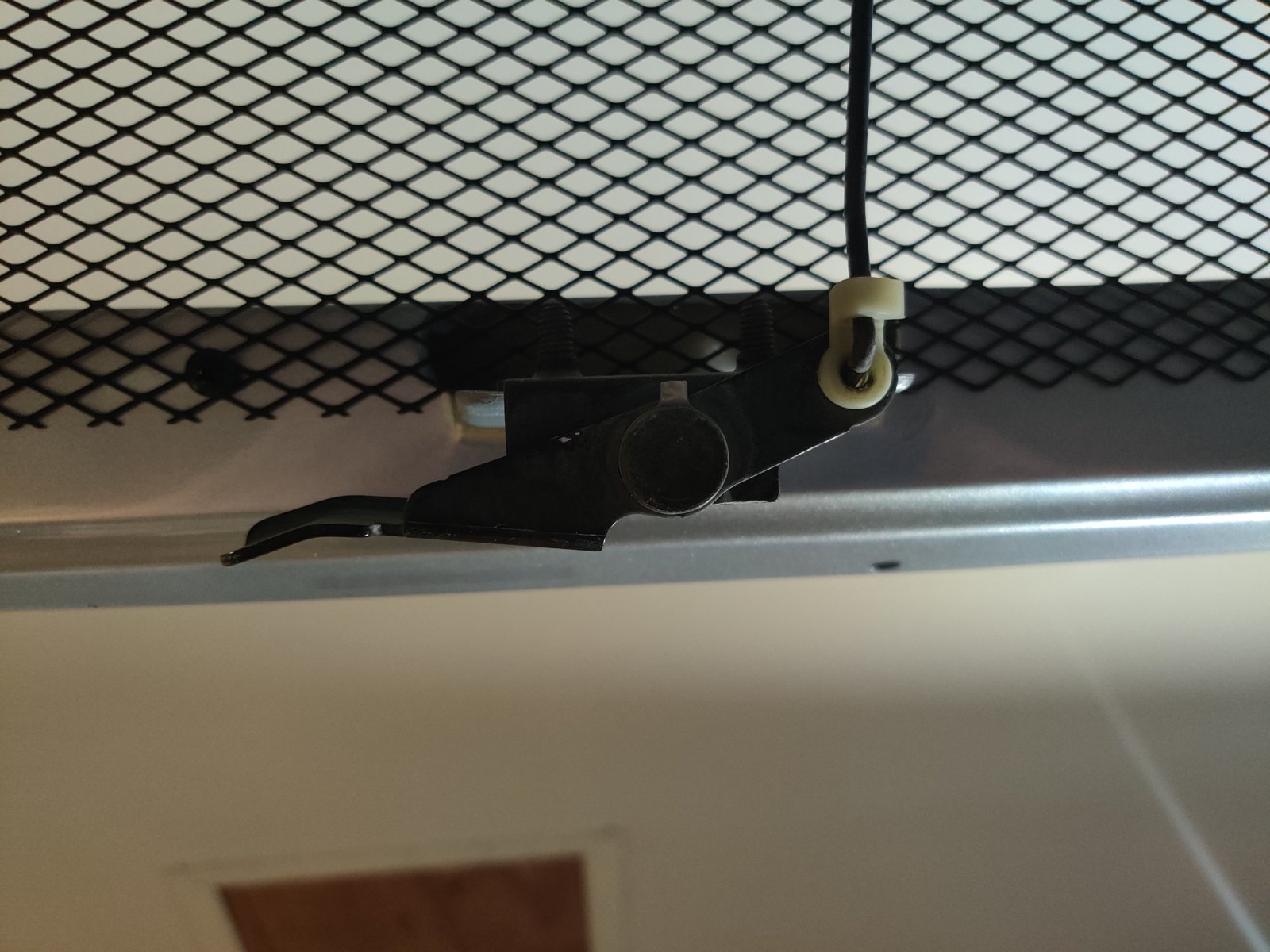

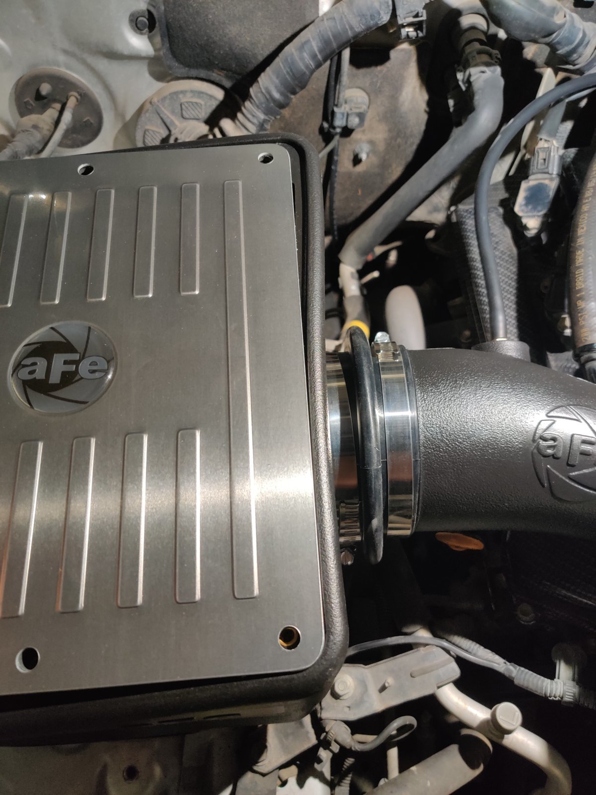

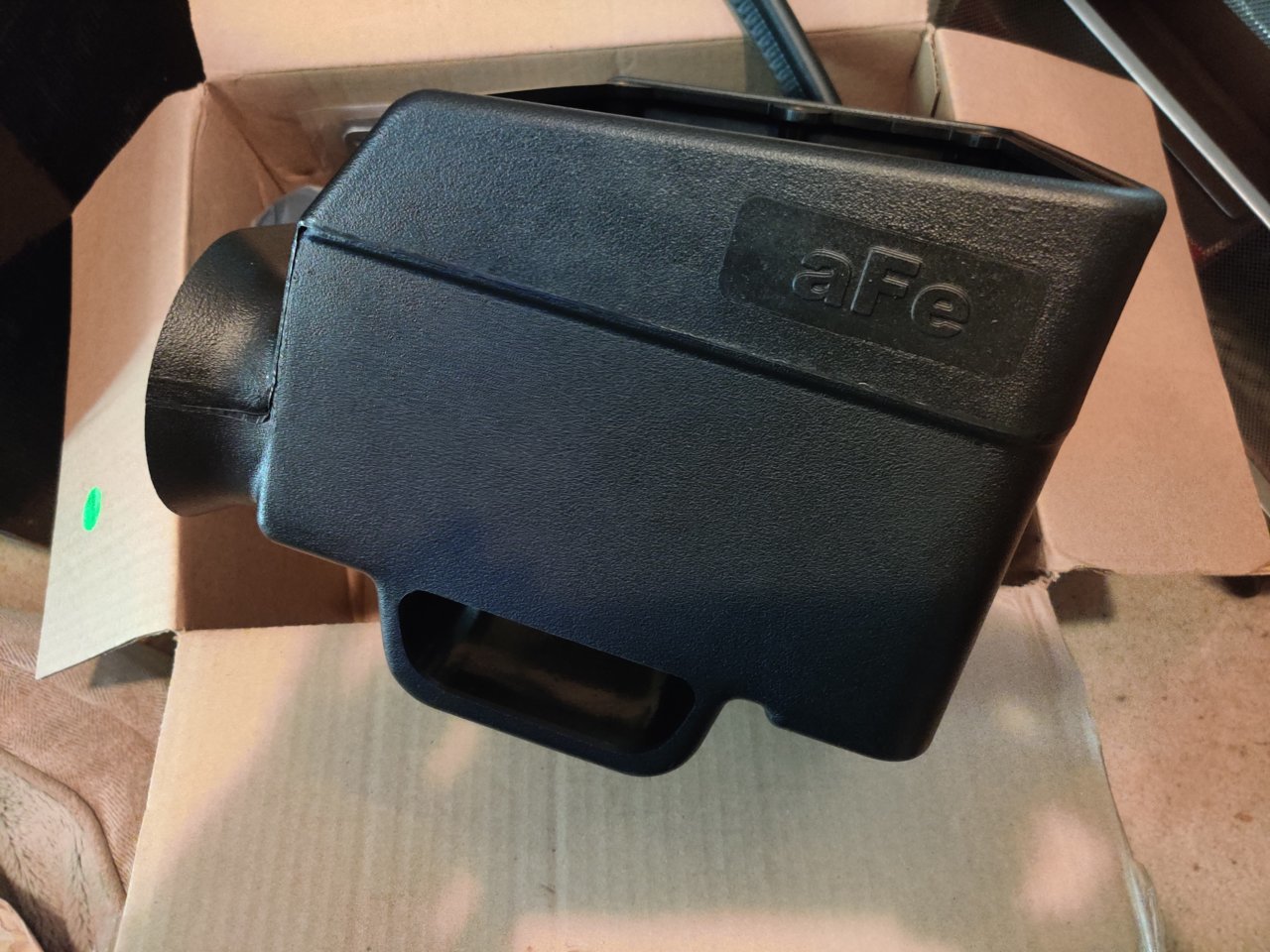

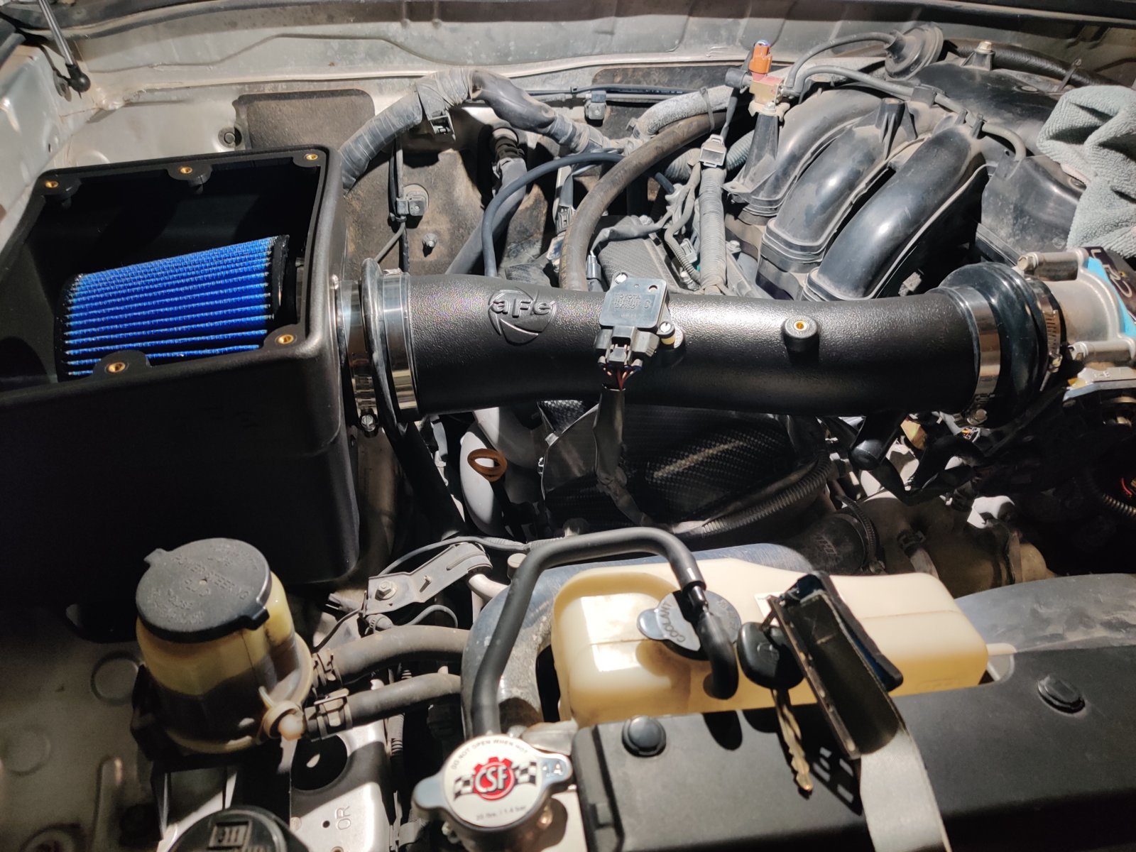

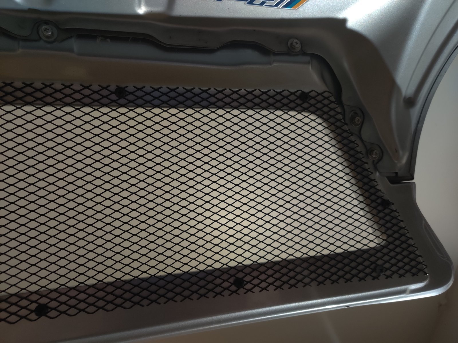

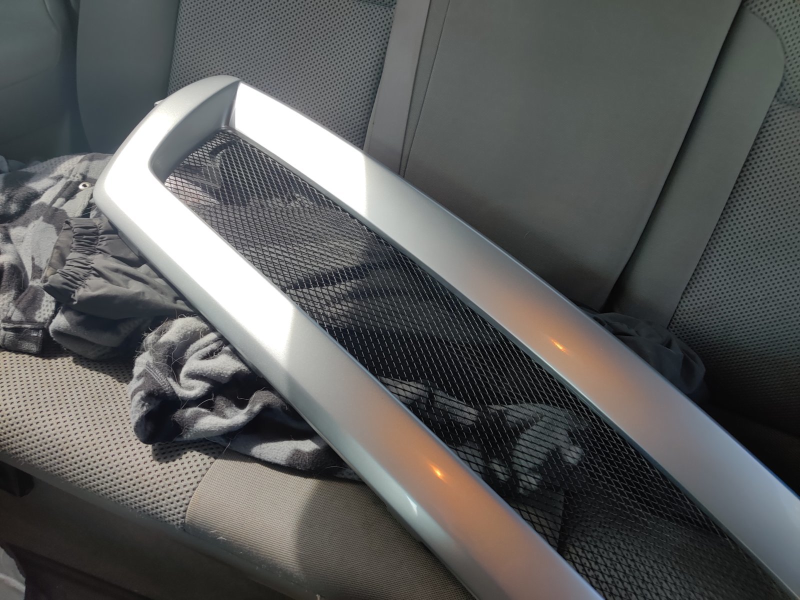

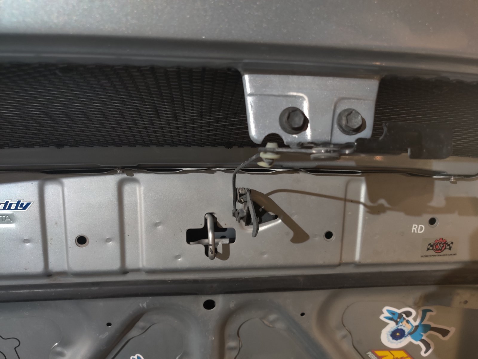

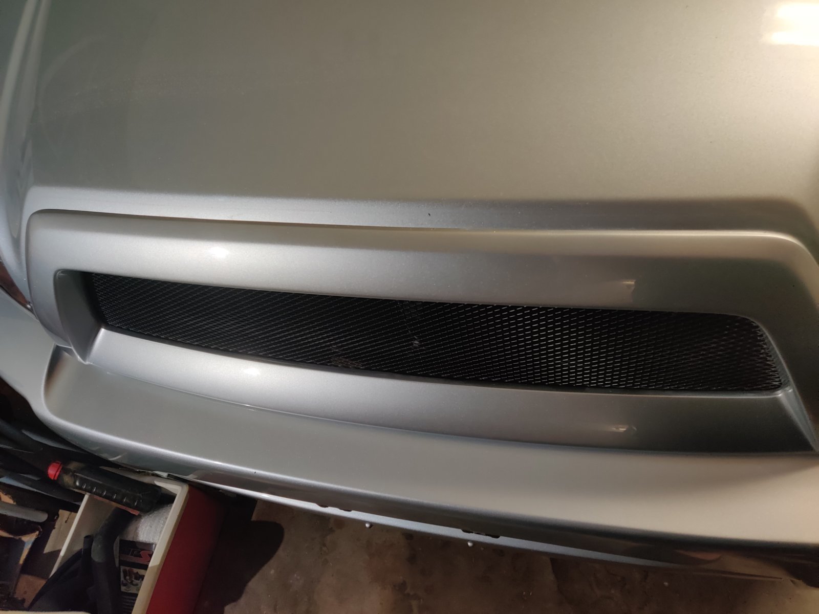

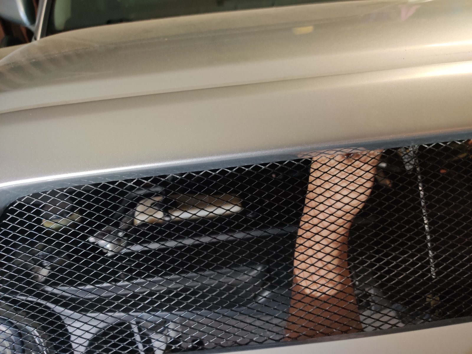

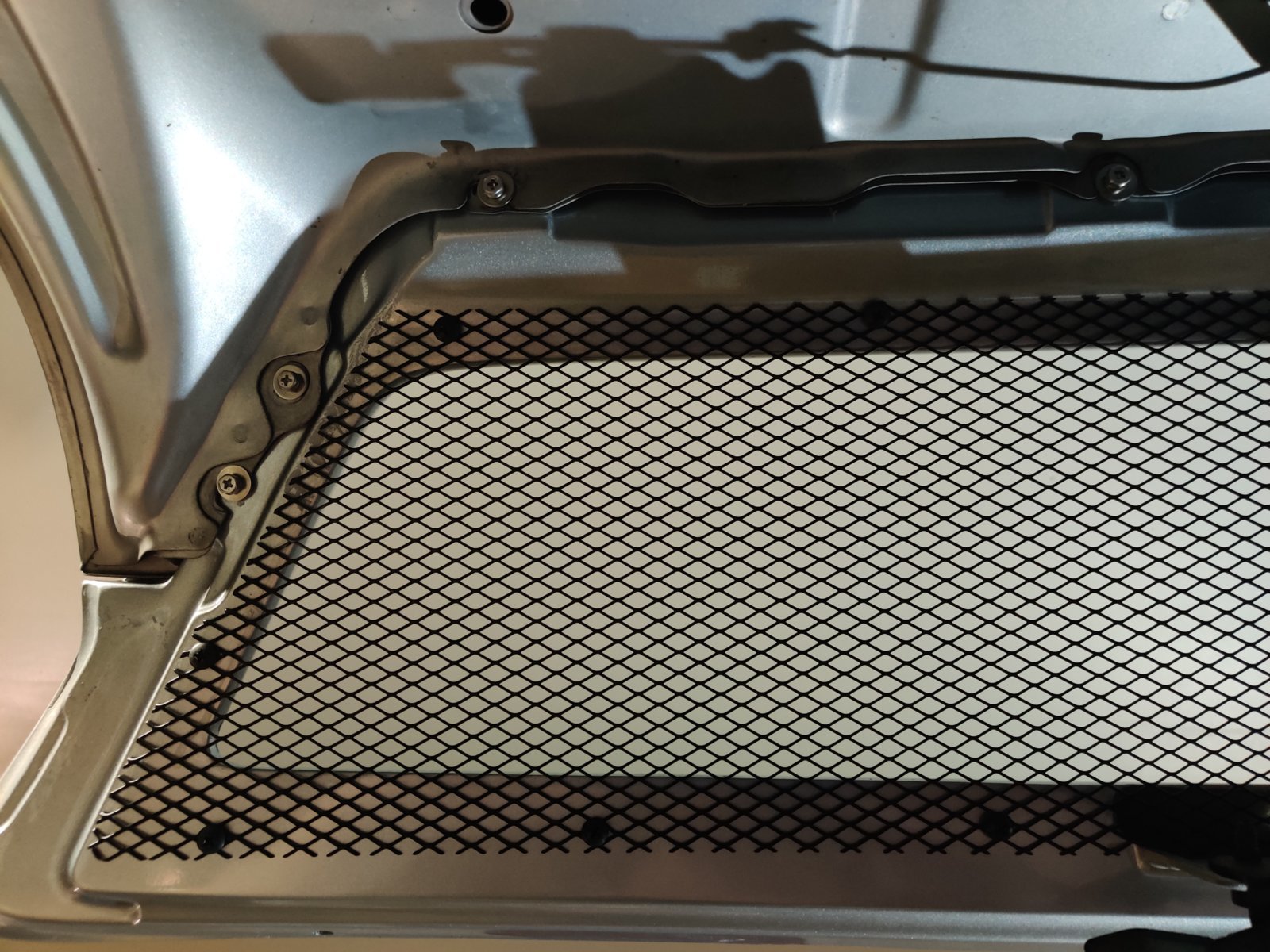

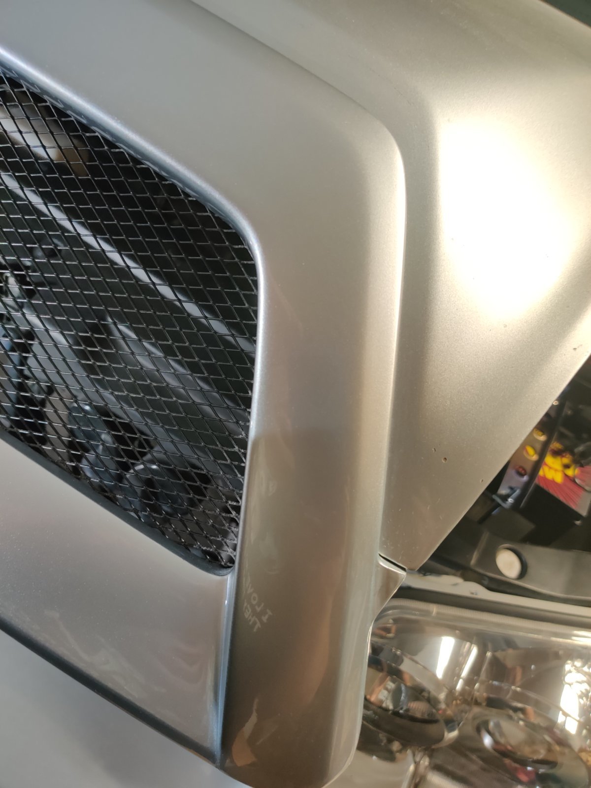

    IMG_20231007_135618.jpginstalled thale second intake. The qc at afe seems to be going downhill. On the seal to the fender there is no lip for the weatherstripping to grab just a smooth section so the seal always wants to lift off, second the box itself was warped so I used a heat gun and some physical persuasion to make it true to the lid.
    Reinstalled the spare 70mm throttle body.
    So the jaos grill uses these tiny bolts, maybe 5mm definitely a 1.0 thread, and washer to help clamp down the grill to the hood. After completion it feels good but now I feel like I need to invest in some hood latches like on the Tacoma. I was pending to see if seibon is making a carbon hood but I don't think it'll happen for the 4th gen. Never say never but I'll cut up this hood in the meantime.
    The jaos covers at lot less of the hood than the OEM grill for those interested.

    Is this the aFe stage 2 si intake? And did your tune require any rescaling for the MAF? I’ve heard some of the aftermarket intakes require a little fine tuning
  18. Jan 11, 2025 at 8:00 AM
    #358
    Lucario Runner
    Lucario Runner [OP] Resident Truck/SUV racer
    Jun 29, 2011
    #59067
    7,182
    Robert
    San Antonio, TX or nearest race track
    06 Toyota 4Runner
    AFE stage II intake, APR X1, URD 70mm Throttle Valve (ported and knife edged), NST intake manifold spacer, URD spec U headers, Denso IKH20, URD fuel pump, APR fuel rail, URD Y pipe, URD spec u catback, lightweight water pump pulley, Greddy sandwich cooler plate, Earls oil cooler, IPT valve body, FJ TRD shocks, Cusco front and rear sway bars, Energy Suspension rear track rod bushings and rear link bushings, Carbotech pads, Stoptech ss brake lines, Stoptech slotted rotors, Motul 600 rbf, Limited Grill, Painted hatch cover by me, Painted valve covers by me, Cobra CB, TRD rad and oil cap, Escort 8500, Autometer oil psi and temp gauges, AEM wideband afr gauge, Flexpod, Pioneer 400w speakers.
    no need as where the maf sensor is placed is the same as oem and it match the i.d as well.
