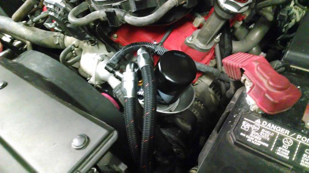

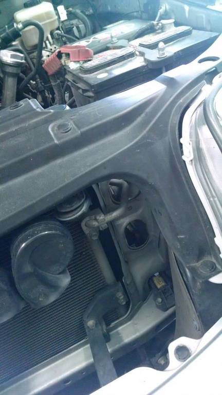

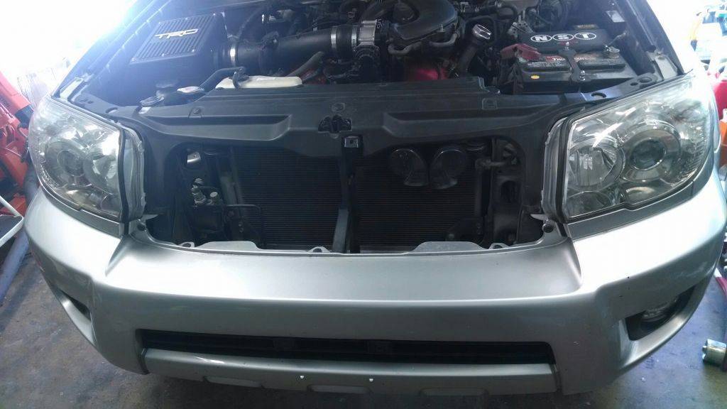

    ^these photos are to give an idea on where we were routing the oil lines.

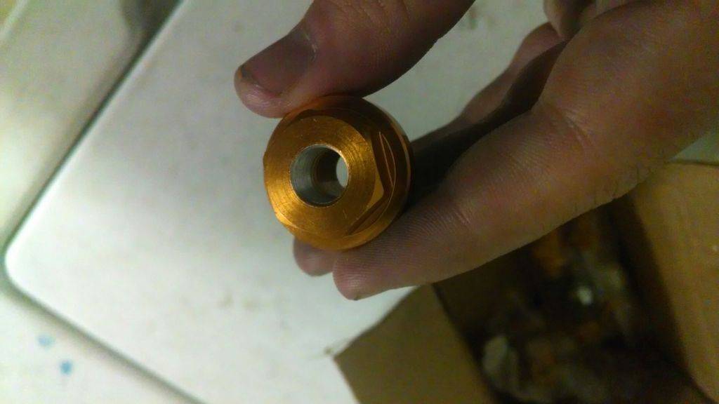

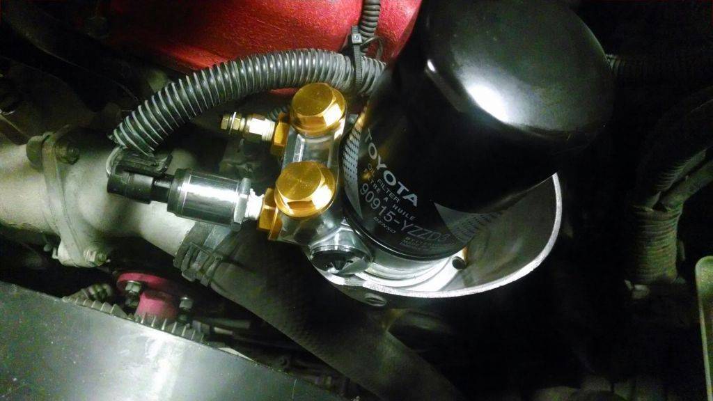

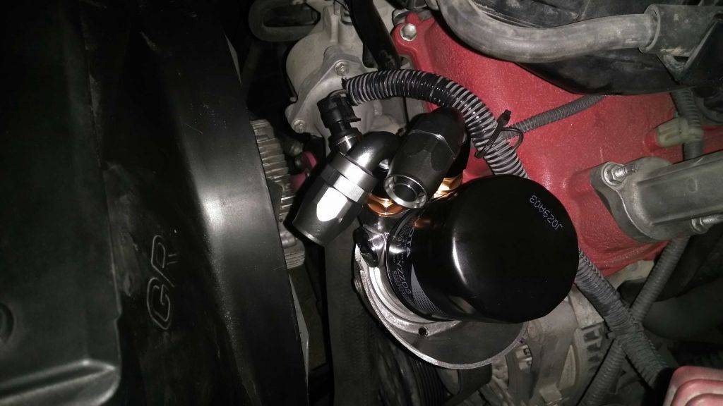

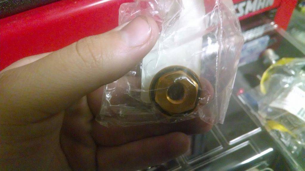

    First I needed to install my Greddy oil cooler adapter. The fittings for the oil pressure and temperature sensors were too small being 1/8 pt so I tapped them to 1/8 npt.

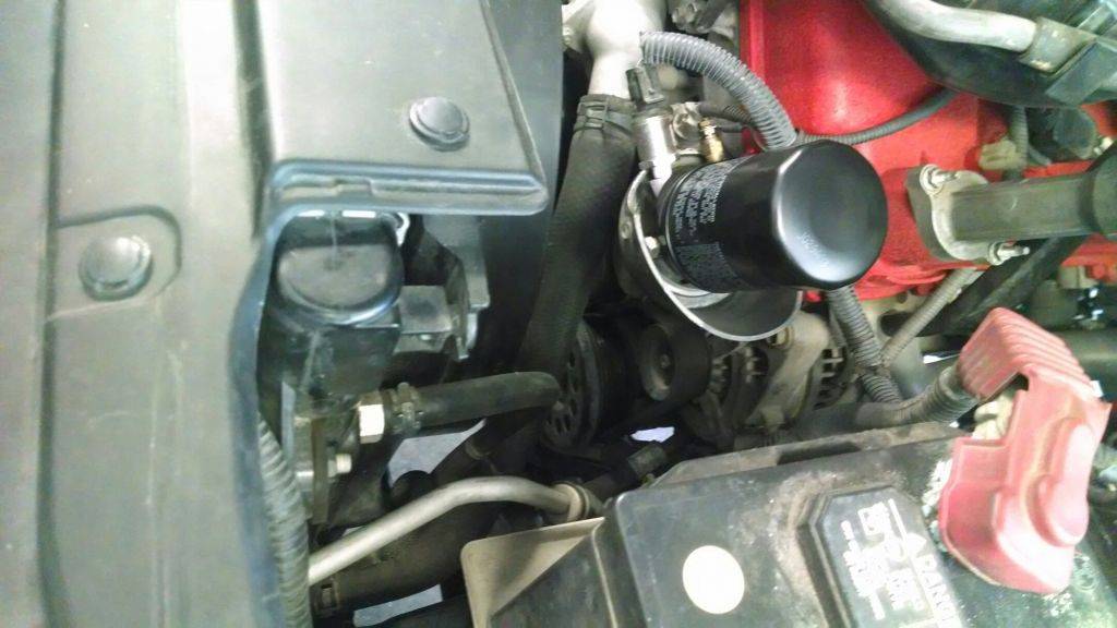

    Greddy adapter installed.

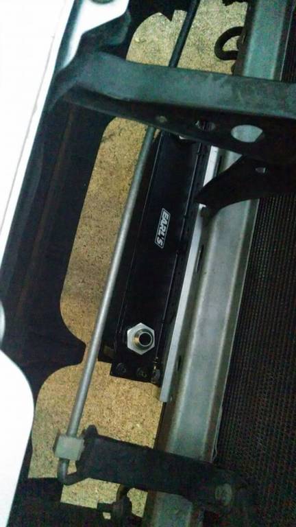

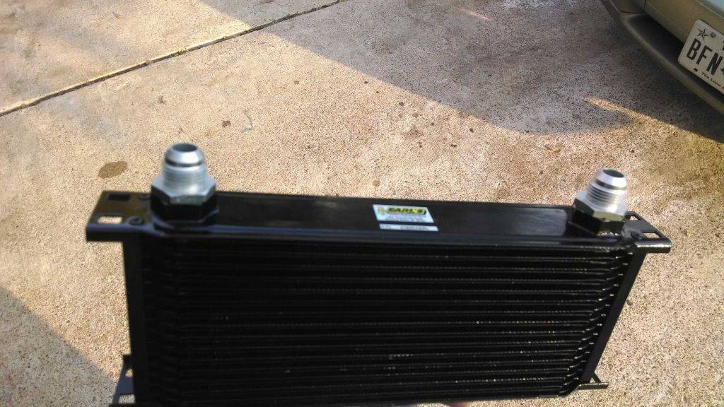

    ORB fittings installed on the cooler.

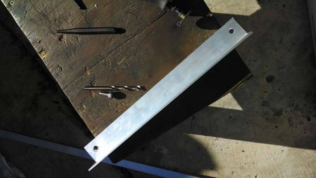

    Bracket made thanks to Torspd.
    oil cooler mounted.

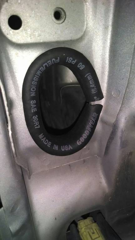

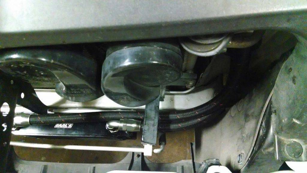

    fittings being mocked up.
    lines installed.

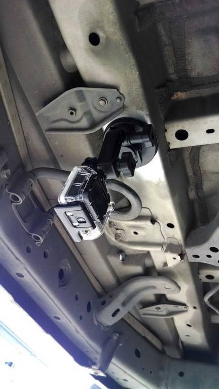

    Gopro mounted to watch the rear axle.

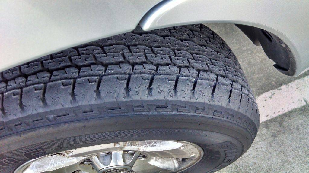

    Tire wore good.

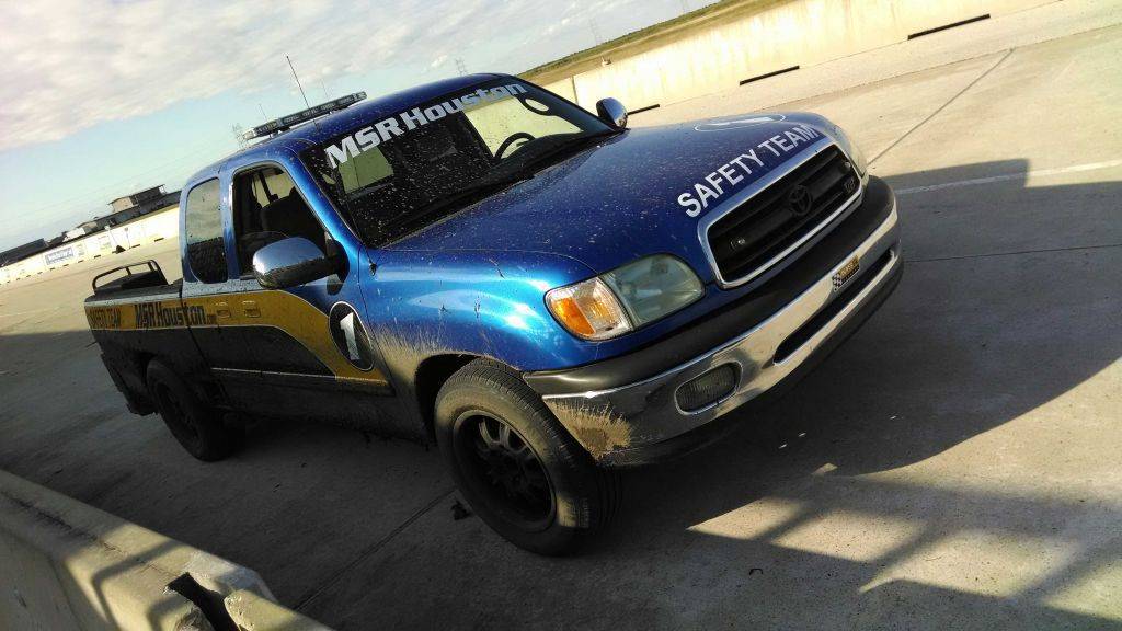

    And this guy went far to recover a car.

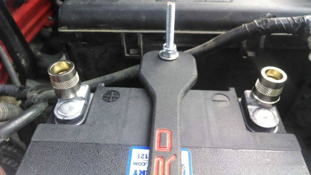

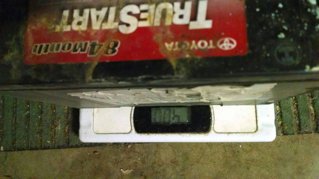

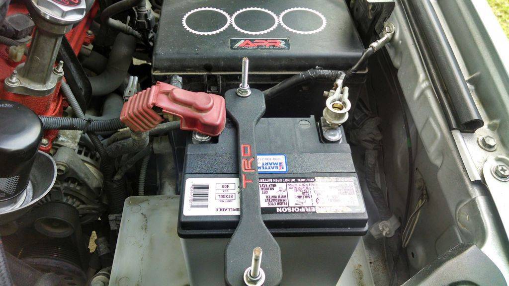

    As for mods I got a new "racing" battery. Its a Deka etx30l. Weighs a 21 pounds. My old battery weighed 40-41 pounds. (scale was inconsistent) This is basically a braille without paying the braille tax. So far it has performed great. Also interesting note my friend Camerons tacoma battery was 50 pounds. same kinda toyota truestart battery. interesting little tid bit there.
    To complement a light weight battery I got these.
    http://batterystoreonline.com/product/m6-to-sae-battery-terminal-adapter-kit-aluminum/
    I also need to install my cusco sway bars before msr.

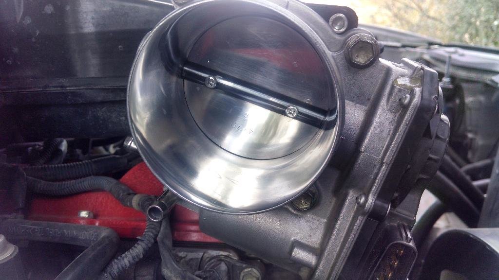

    Ported, polished and knife-edged 70mm tb from Bobber Bill.
