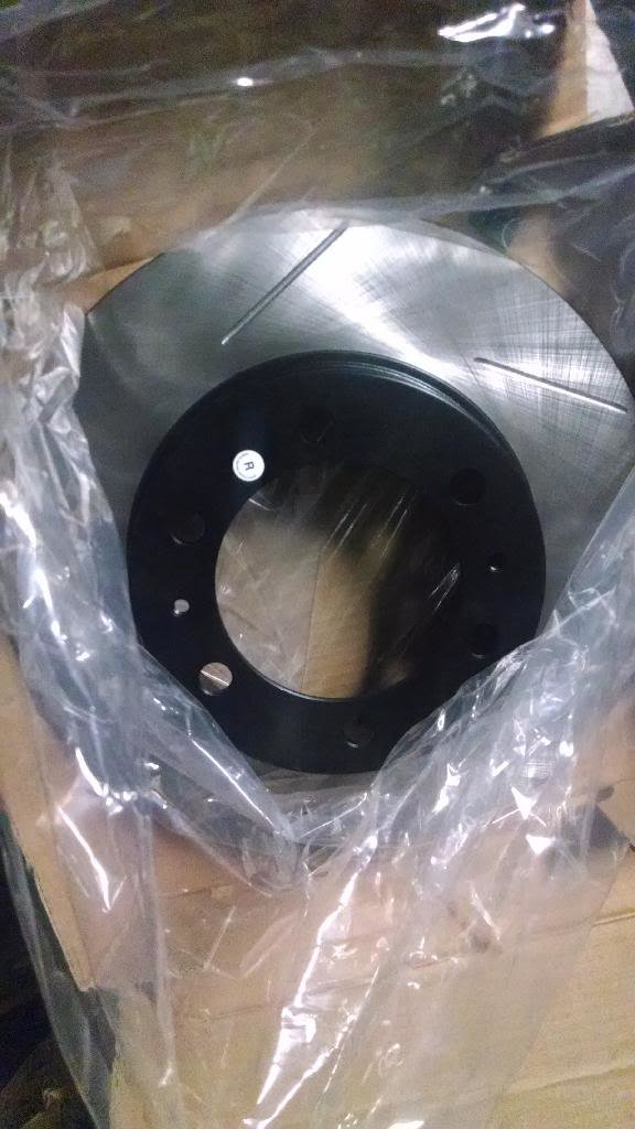

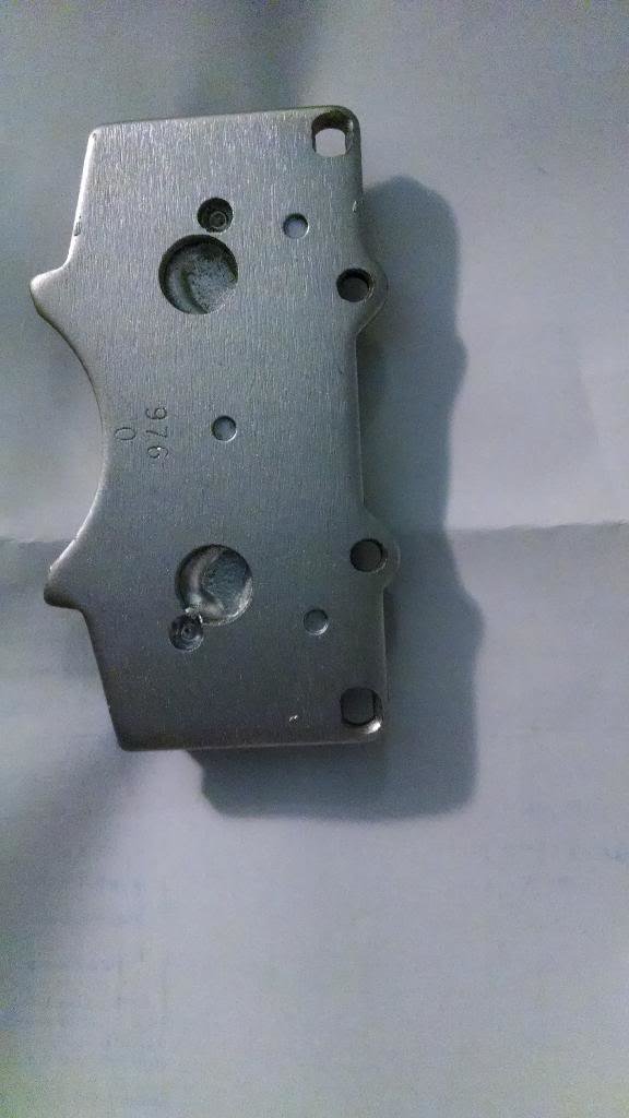

    Got some new brake parts for the upcoming track day ahead. The previous one I still had ok bite but I could feel fade after a few laps. So now it's time for an overhaul. I ordered some Carbotech XP8 race pads and stoptech slotted rotors. Also broke the bank with some motul 660 dot 4. ;)
    And here is the bed in sheet.

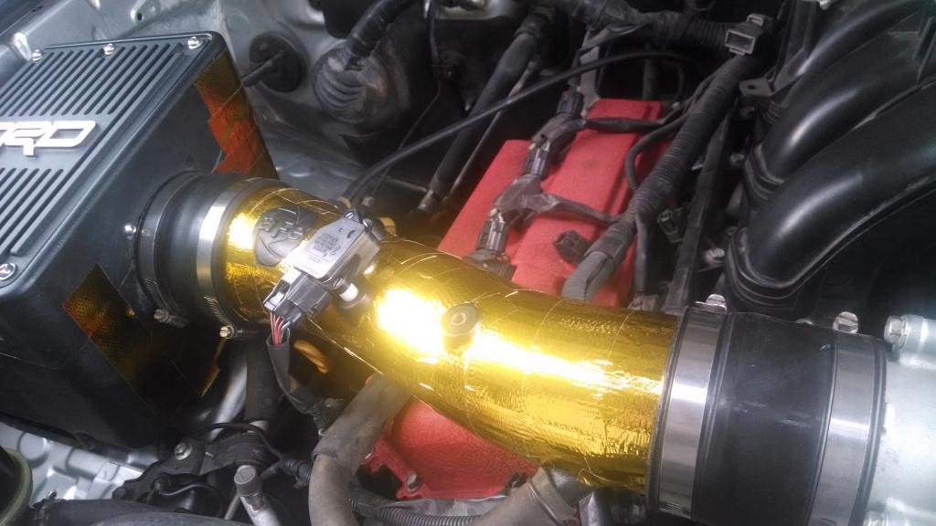

    As far as mods go, not much has progressed, I dei wrapped the intake, not fully as I ran out but another roll should finish the box. I have not yet test it in racing situations but it seems to help the iat's cooler down a little bit fast after sitting in traffic. Still have my doubts but I would like to fully test it.

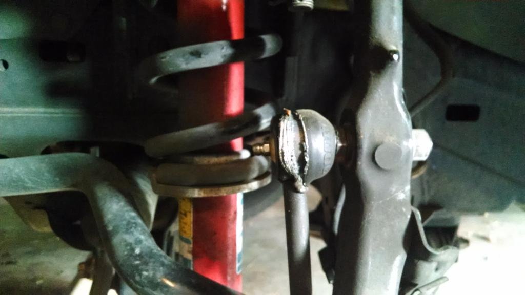

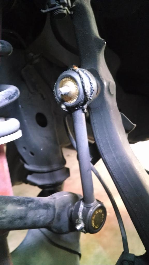

    Also as a bit of a heads up I had busted one of my front sway bar links (was in bad shape for awhile) and a friend had a moog replacement so I got it on before the track and this is the result after maybe 1,000 miles.
    As the grease is allowed to get pass the seal ( I called this before I installed it) I would not recommend this piece for anyone's ride. Although since most just remove the sway, who cares right? Also if anyone is selling a dual vvti 1grfe upper intake manifold for cheap let me know.

    What is that dei stuff? Never seen that before....

    So that roll of magical gold really keeps things cooler or do you just want it there to make sure your MAF lines don't get too hot? Lol "magical" it looks cool if nothing else! :D

    well, I'm trying to keep the iat's as low as possible and considering how hot my oil temps go ( up to 126c or 260f) I can only imagine the egt's. All that heat will travel to the intake warming the iat's and less power is the result of that. This is supposed to help reduce that heat soak. How effective it is, haven't really put it to the test, but at least driving around town and sitting in traffic the intake temps seem to come down a bit quicker then they used to. My testing is pretty unscientific, just an ultra gauge. Others however seem to like it, I have seen alot of spec miata's running it.
    http://www.iwsti.com/forums/2-5-lit...diy-heat-managment-cobb-sf-intake-airbox.html
    I was also thinking of getting an APR carbon hood vent but I do not have the balls to cut my hood. http://aprperformance.com/index.php?option=com_content&task=view&id=270&Itemid=44
