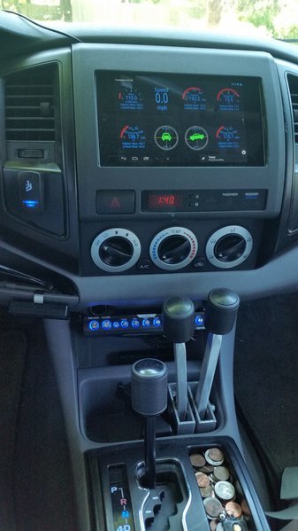

    Great build! What model head unit are you running? I like how your able to view your gauges

    Nexus 7 2nd edition tablet with Timur's kernel. App you see is Torque Pro. Tablet connected to powered USB hub via OTG cable. OBD-II module connected to USB hub and feeding telemetry to Torque app from ECU. USB DaC connected to Clarion EQ/Pre-amp which runs to a 4 channel amp behind back seat. Alpine speakers in the doors. No sub.
    Check out https://timur.mobi/.

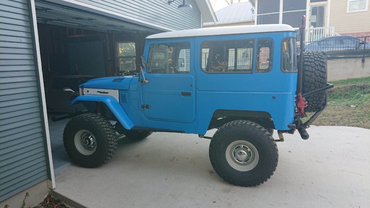

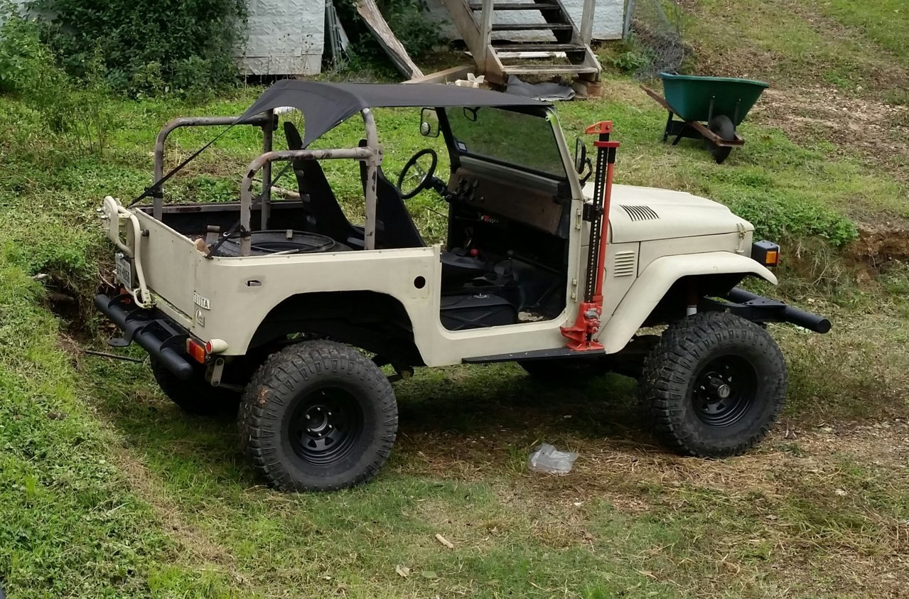

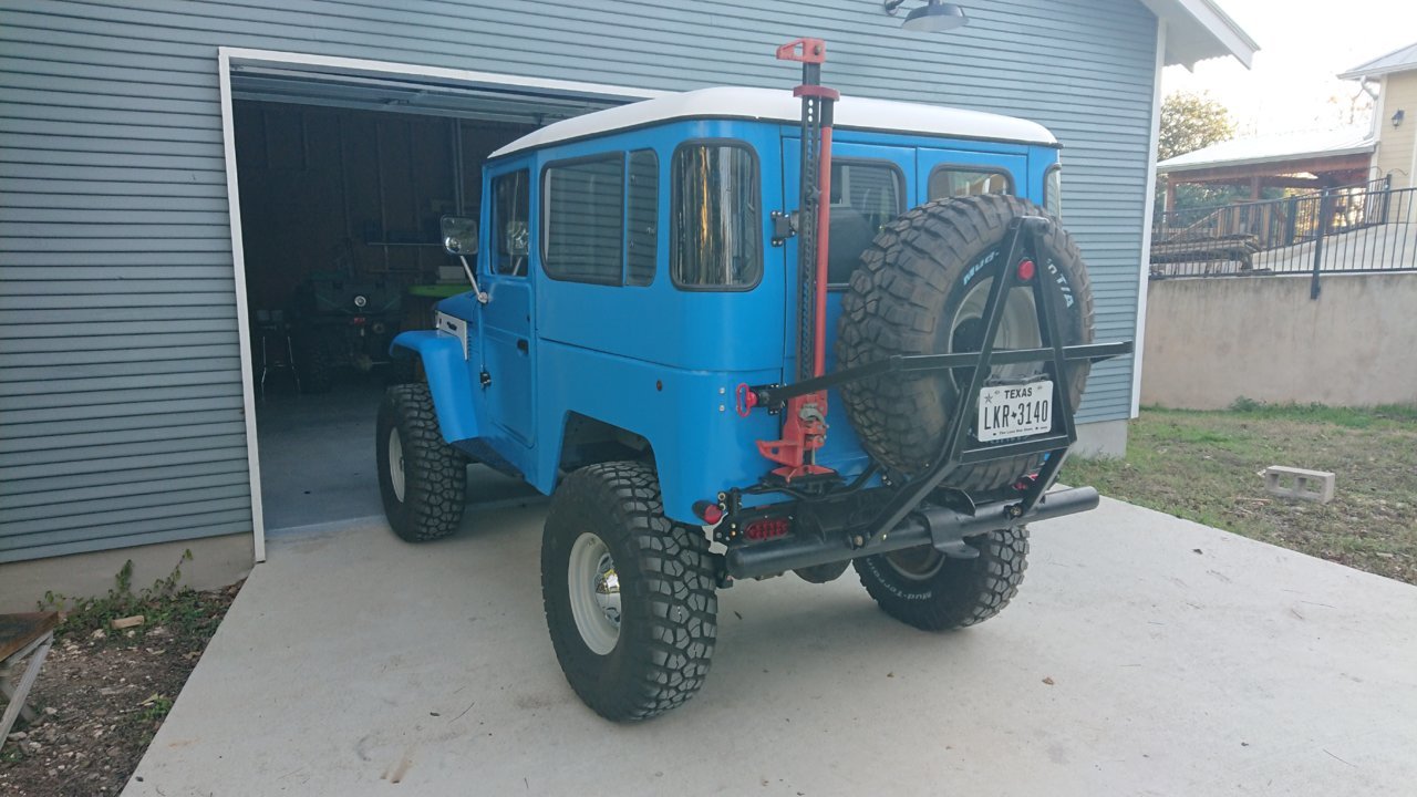

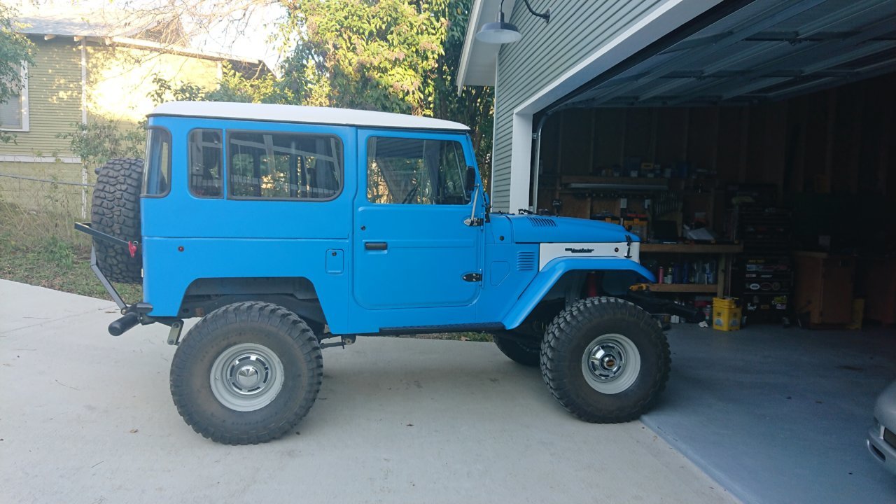

    Pics of the FJ?
    How many miles does your engine have on it now since you swapped it in?
    Sleipnir likes this.
  10. Mar 7, 2019 at 7:24 PM
    #230
    lucky
    lucky [OP] Well-Known Member
    Jun 21, 2008
    #7468
    488
    NB, TX
    07 PreRunnerX4
    I've put 120K miles on the 09 engine . The truck is at 203K. I think I have around 45K on the 4x4 conversion.
    stand by for FJ...
