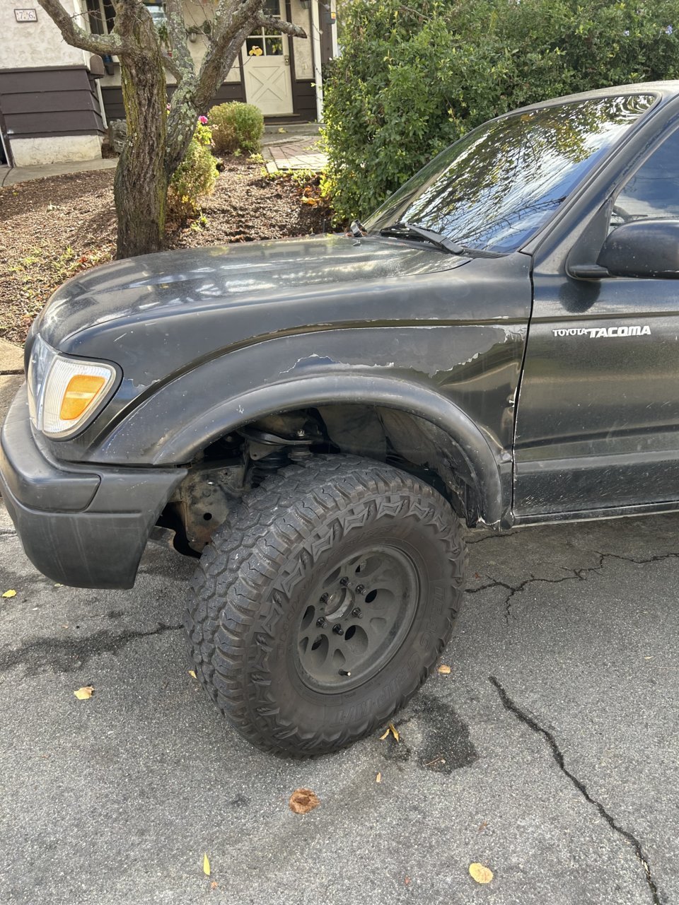

    This happened in front of my house the night before thanksgiving after running errands all day.

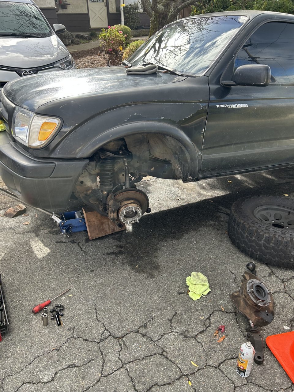

    My mechanic couldn’t believe how lucky I was that the bolts snapped at home.
    Anyways, he found me spare parts and was able to get me back on the road a couple days later.
    Shit happens, unexpected expenses are better when they are for your car instead of for yourself. I’ll call it lucky as it could have definitely been worse.

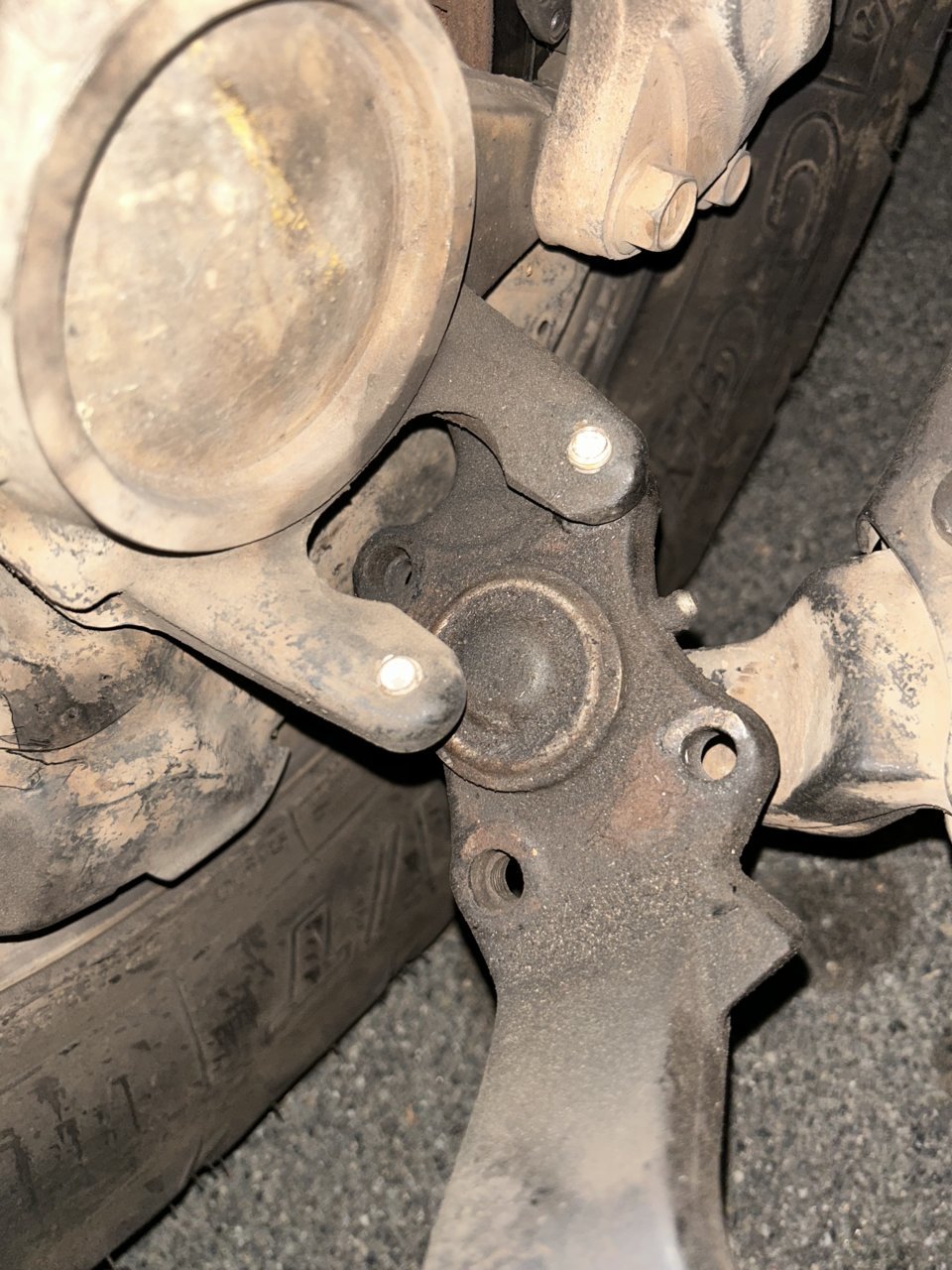

    Got the passenger side done about 1 month ago after I purchased the truck. The driver side looked fine, anyway the lbj held up the bolts holding it just crapped out. My mechanic tried drilling them out but two of them had seized in there so he just got me a replacement part

    Pretty sure those bolts are one time use, and the torque is much lower than you would think.

    One of the issues with first gen lower ball joints is the weight of the truck and the suspension components are actually pushing the opposite direction the ball joint is supposed to support. Not a great design, not an issue with other generations. I’ve changed my lower ball joints every 100k or less, especially important if you push the truck.
    Also, make sure to replace the 4 bolts when you change the lower ball joints
    https://www.toyotapartsdeal.com/oem/toyota~bolt-flange~90080-10066.html
    Also, use OEM lower ball joints, worth the added expense

    Additional up-to-date information on the various LBJ bolts and their failures is available. Absolutely worth the time reviewing and understanding just what is going on with the bolt you are selecting. Big thanks to @SpikerEng for putting this together.
    https://www.tacomaworld.com/threads...s-wanted-about-lower-ball-joint-bolts.772506/
    If you want to skip ahead to his results, link is here. I do suggest reading the entire thread though.
    *NOTE* If you are using the LBJ dust protector (2001-2004 had them) then you MUST use the toyota Black w/washer bolt (P/N 90119-10933). Torque for this bolt is 37 ft lbs. No more, no less.

    I got my 8 bolts (P/N 90119-10933) from Yota Performance. Quick delivery. Concur with 37 ft lbs...don't follow the FSM of 59. Use some blue loctite.

    Using loctite, you'll need to account for it when setting the torque value. Why I opted to install dry. Factory doesn't mention it in any of the docs (including the LBJ recall campaign), so I skipped it. We know these bolts are picky AF when it comes to torque. For those black w/washer it says 37, it's getting 37 on my truck.
