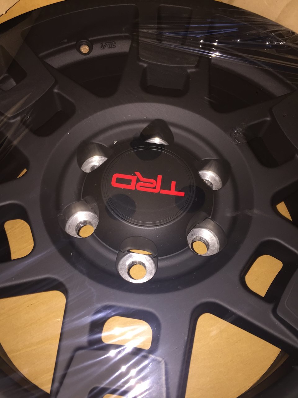

    I picked up some TRD pro rims for my 02 tacoma. I stopped by the tire shop and they told me I need new lugs for them. They said they need to be flat washer with a smooth barrel. Any idea where I could get these? I've looked around and i haven't found much of anything.
    These are the rims I'm talking about.

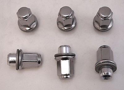

    The lug nuts you have on your truck now might work.
    Look something like this.

    He must have different rims than the ones shown in his avatar. The factory alloys use nuts like the ones I posted. At least I think they do. I sold mine and I'm pretty sure the lug nuts had washers.

    Ah. Steels rims use the acorn style. Alloy rims use the flat washer type with a chamfered tip so they also work with the steel spare. OP's rims look like alloys.

    The flat washer type is called mag style. These are what Toyota uses on all stock alloy wheels.

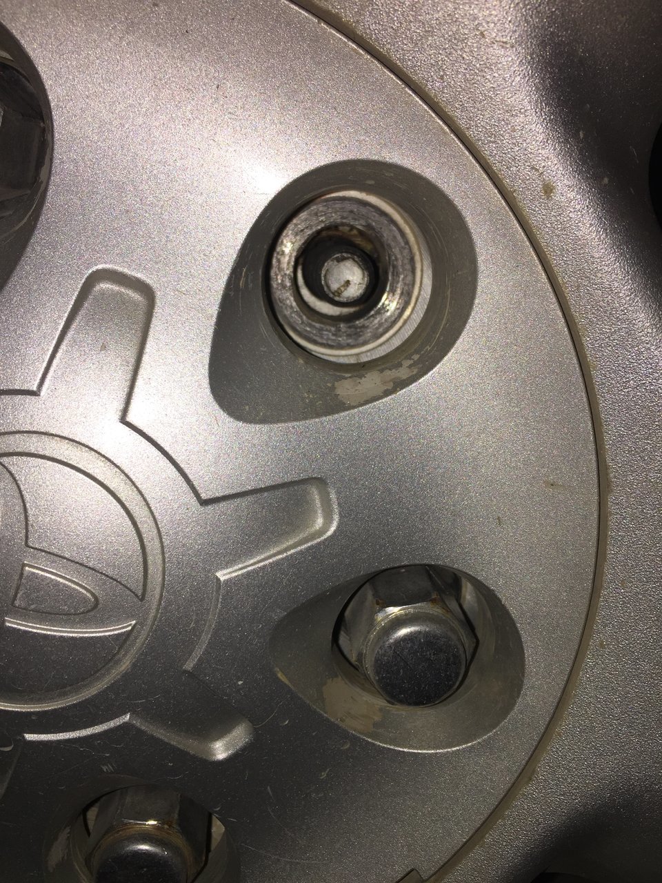

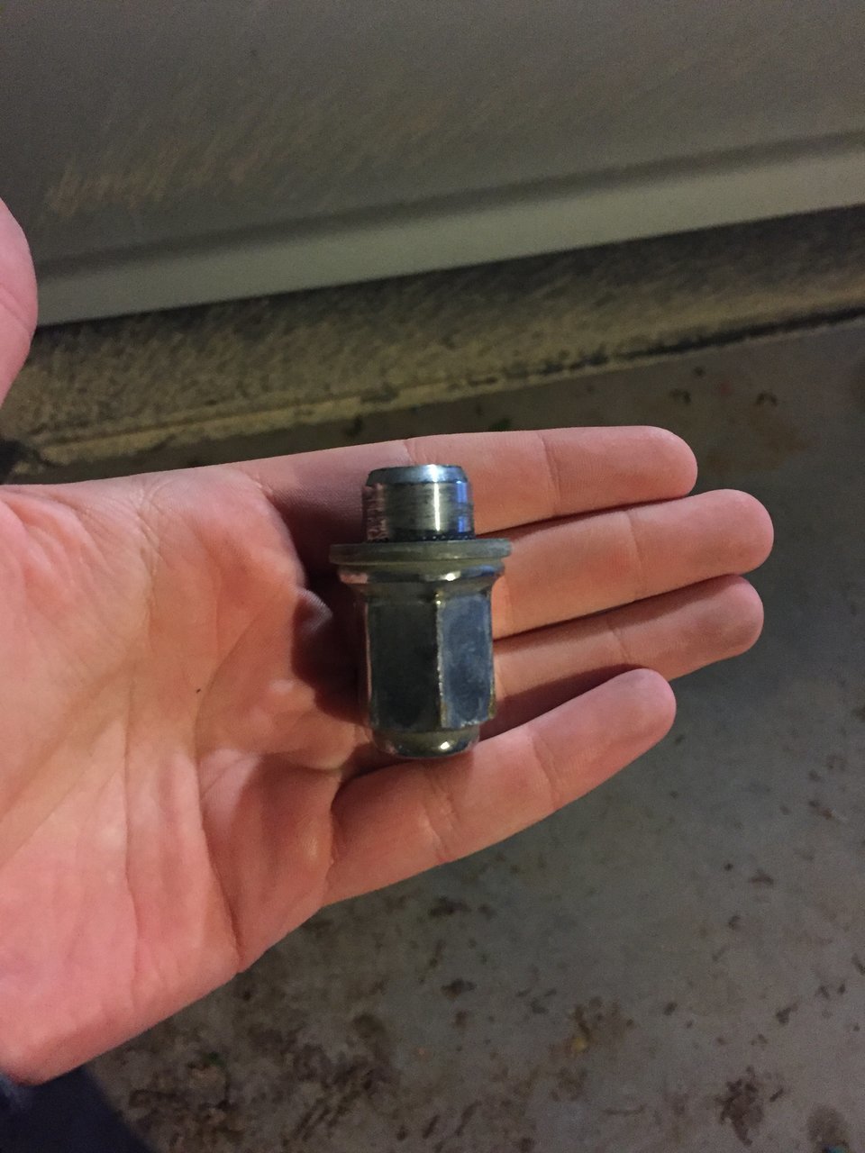

    Okay lemme clarify all this up.
    These are the lugs I currently have
    This is the place where these lugs go
    These are my new rims
    My question is what lugs will fit in these new rims. Will my current ones fit? If not, what kind do I get that will fit?

    Looks like the short shank Mag style should work
    Put the wheel on see if the lug bottoms out before it gets tight on the wheel

    Should work just fine.
