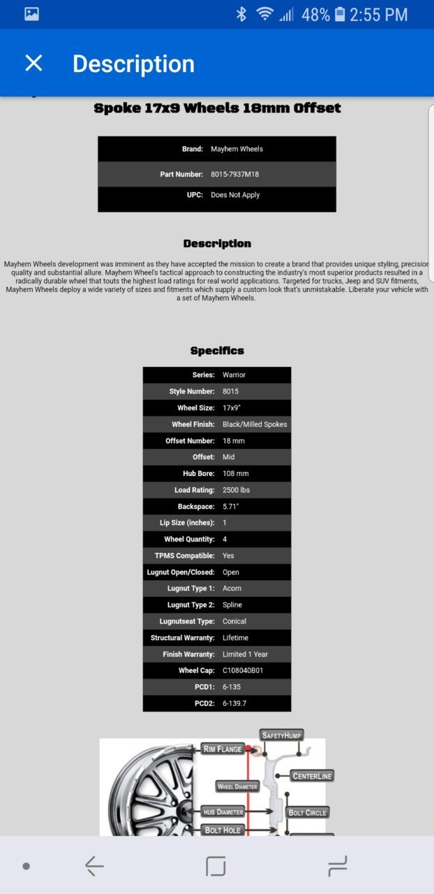

    If i get these wheels could someone point me in the direction of what lug nuts i need for them ? I have pic of them and all the messurments in the picsScreenshot_20190103-145542_eBay.jpg Screenshot_20190103-145549_eBay.jpg

    Did you check the wheel manufactuter's website?

    I believe we have a 106.1 Hub Bore and you will need hub rings to make sure it seats properly to not increase any possible vibrations.

    Emailed em but all they said was they had to be conical and the rims were lug centric.

    Yea i just saw that about the hub bore i just ordered it all lugs rims and hub rings
