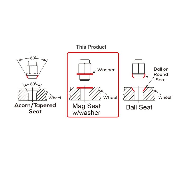

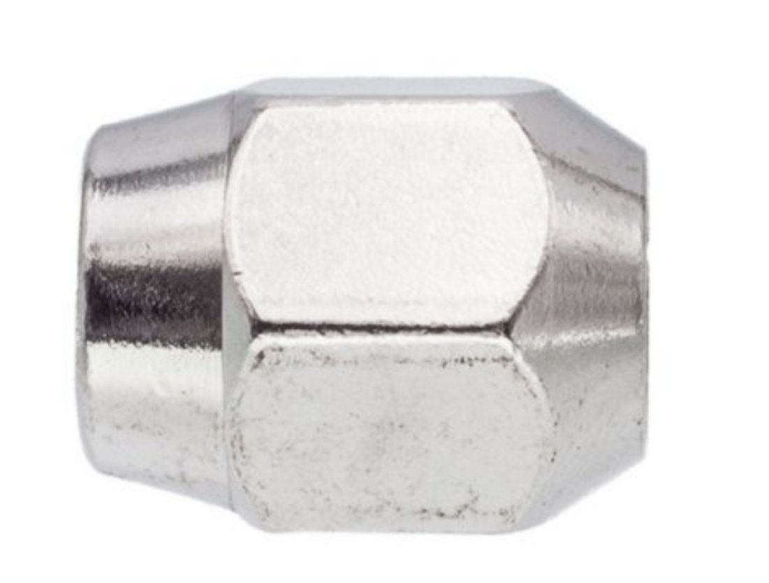

    There are only 2 styles available for a Tacoma. The steel wheel lugs nut, also known as an acorn.
    Or the mag style used on the Aluminum wheels. These will also work when using the spare steel wheel.

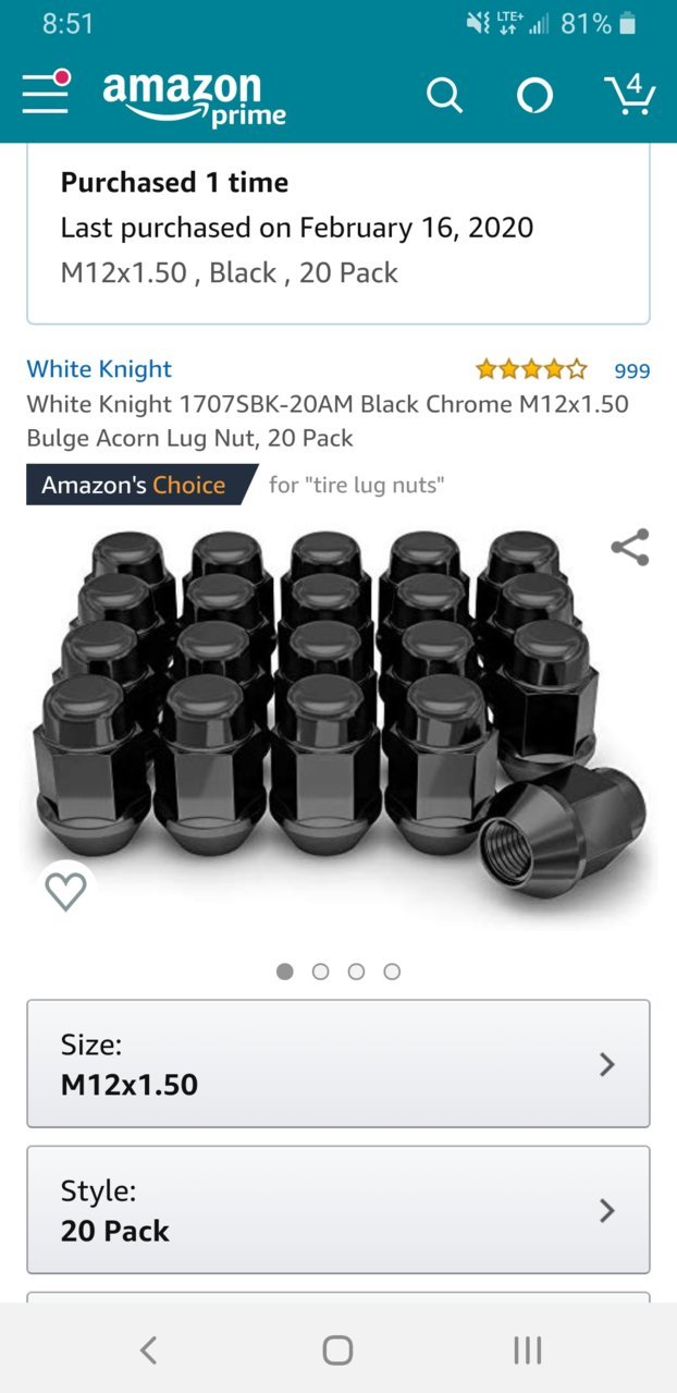

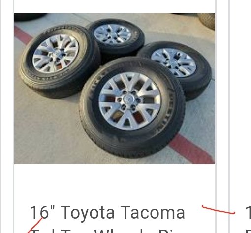

    I'm sorry but what are mag style? Can you explain this. I know very little about lug nuts. Attached are the lug nuts I ordered and the wheels I ordered.

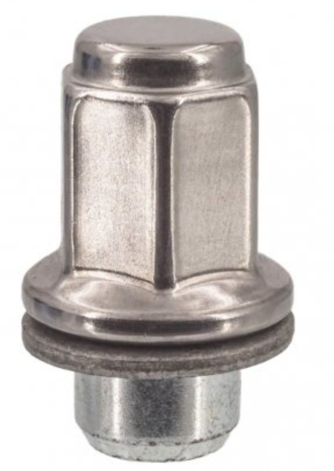

    Mag style are the style with the flat seat and washer. The bottom nuts in my post and @whatstcp post. The wheels that you have pictured are aluminum and to my knowledge require the mag style lug nugs. Not acorn. Maybe someone here with those wheels can verify this.
    Edit : an easy way to tell is if the lug hole has a flat face and next to no taper.

    Wrong lugs, you need these...
    whatstcp likes this.

    thanks all! I always learn so much from the community here. Originally I mistakenly ordered the acorn style M12x1.50. It seems like the oem lug nut wrench that came with the truck is a little too big for M12x1.50 lug nut. Can anyone tell me what size lug nut I should get for the OEM lug nut wrench that will fit the new mag seat lug nuts?
