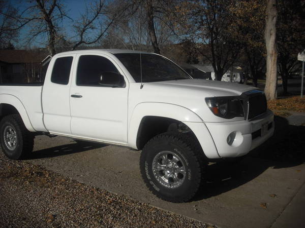

    anyone know where to get hub centric rings? not spacers...
    not sure on size off hand. I have slight vibrations at 45-50mph, thinking my after market rims may be the cause? I don't know the brand of rims, bought the truck used back in August. Replaced right front bearing and wanting to get rid of the vibes so I don't have to do bearings any time soon again.
