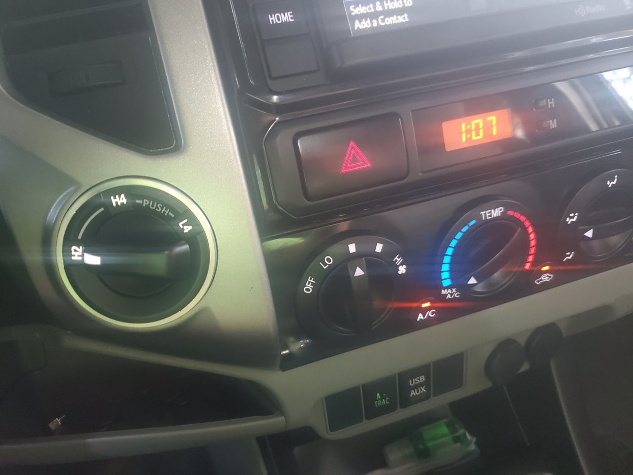

    Yep. Kinda odd the 2g's didn't get lighted 4WD knobs. Photo from a 3g Taco below
    Has anyone looked into whether a 3g Taco switch would fit?
  5. Jun 7, 2021 at 12:39 PM
    #285
    tacoman45
    tacoman45 Well-Known Member
    Feb 20, 2019
    #283801
    1,369
    Orygun
    2014 TRD OR DCSB - MGM
    That looks great. How'd you get the red LED on the clock?

    I'm pretty sure those are factory. They did orange and white clocks

    Didn't know that. Mine is white so I was wondering if he'd swapped the clock LED's too

    its factory.

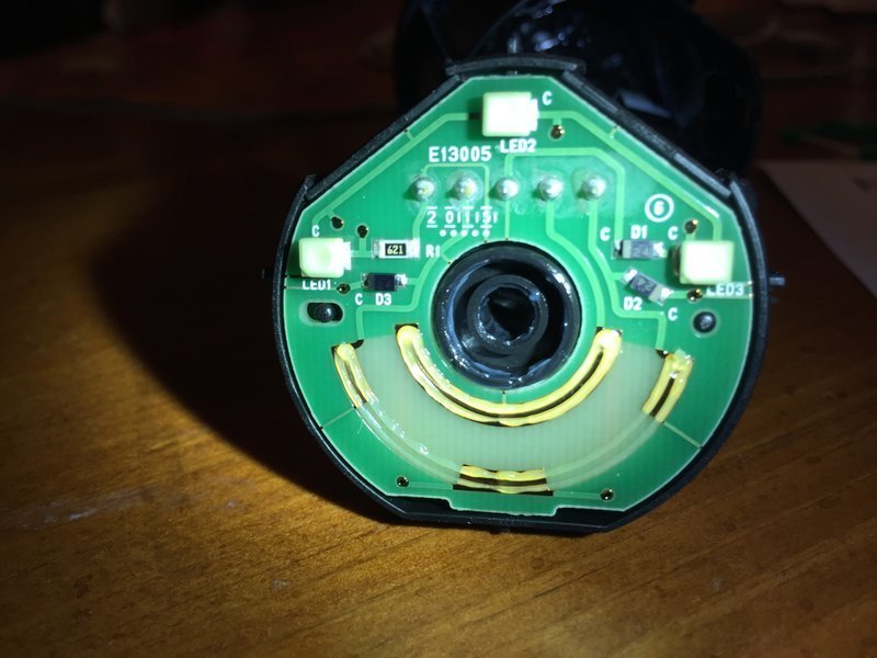

    You don't happen to have a picture of the inside of one of these showing what you change, do you? I think it was you who changed the lamp in mine for me several years back, and now it doesn't illuminate all the time. I think a connection has worked loose, and I was going to try fixing it myself.

    Each LED has a tiny notch in the corner which is the cathode end. In the image below the top left LED you can see the little notch in the top left corner.
    If you're holding the switch upright and looking from the front
    Left LED notch to the left
    Middle LED notch to the right
    Right LED notch to the left
    If I did do it for you though I don't mind at all repairing it and paying the shipping costs.

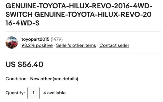

    This look right for the switch? 231835141416
    Got the emitters ordered up, thanks @nazlax10 for that one. Hope I can manage the soldering and not f up polarity. Man these switches are not cheap.

    That looks like the right part number, but the eBay link isn't pulling up anything.
    As far as polarity, the LED will have a notched corner, and that notch will line up with a white "C" on the circuit board for cathode.

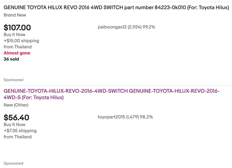

    Fixed up my link, sorry bout that, edited my post, looks good to you? Strange that there are two current auctions with such different pricing:

    Yep, the one in your link looks correct.
