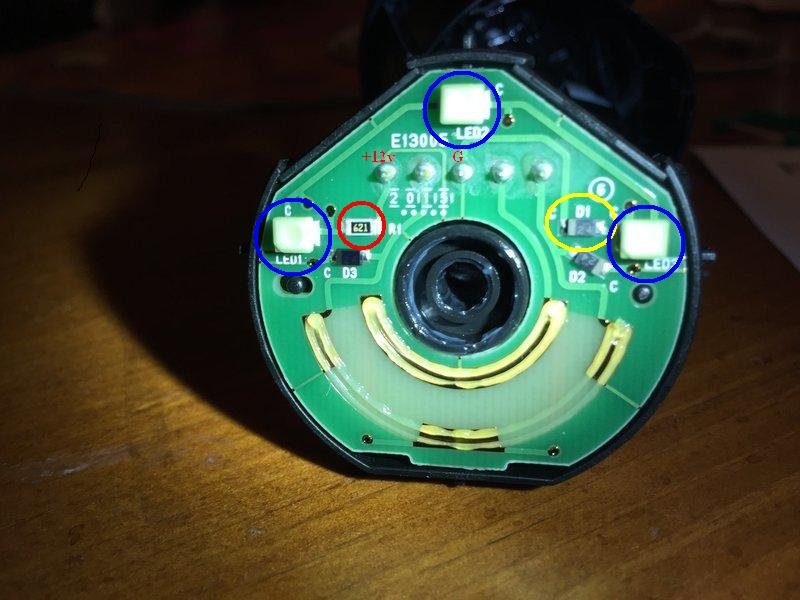

    @nudavinci64 If you are handy with electrical there isn't much to the lighting circuit on these...
    1 x Resistor (red)
    1 x Diode (yellow)
    3 x LED (blue)
    That's a picture of the inside of a Hilux switch.

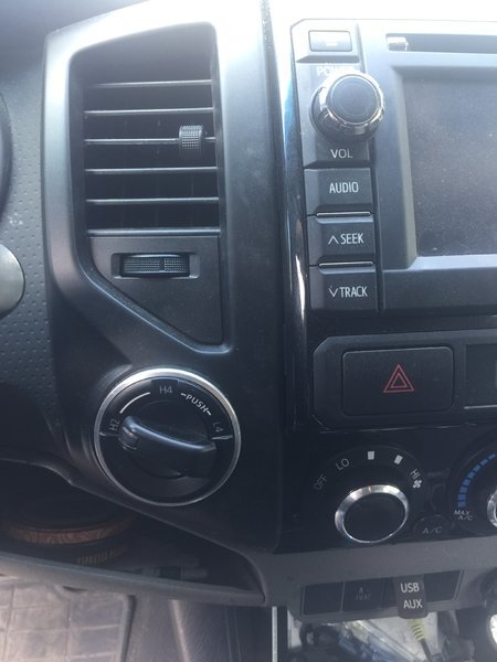

    Got mine setup. Does not light up but die to a gremlins bug. Been all over it and re wired countless times and it won't light up. The main HVAC unit is also very dim. It does light up via 9volt battery so I know the LeDS are sounds. It appears iv not getting th solid 12v going to the area. I'm stumped there.
    Quick photo of the setup. If folks do not want to use a glue or aduehisive I used electrical tape and wrapped to around a few times and wedge it in. Works pretty good. Hit the desert with otbover the weekend and it held up well. I did his as I was debating on a diff color for the ring.
