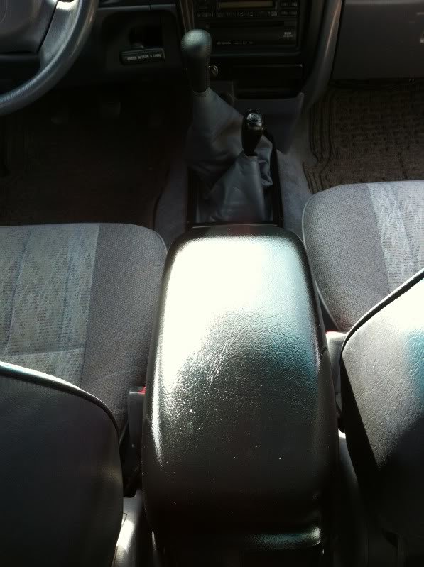

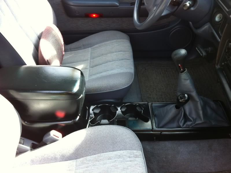

    You quoting those two pics reminds me that the shifter boots look much nicer black

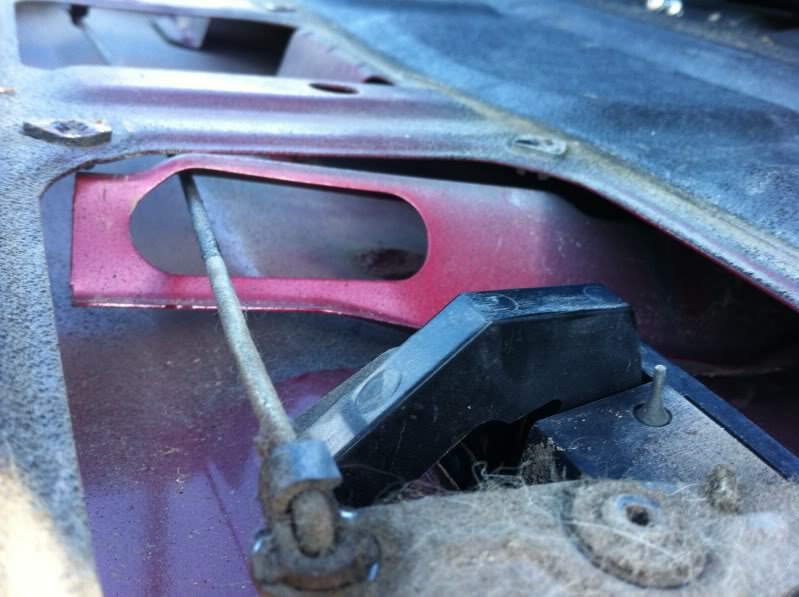

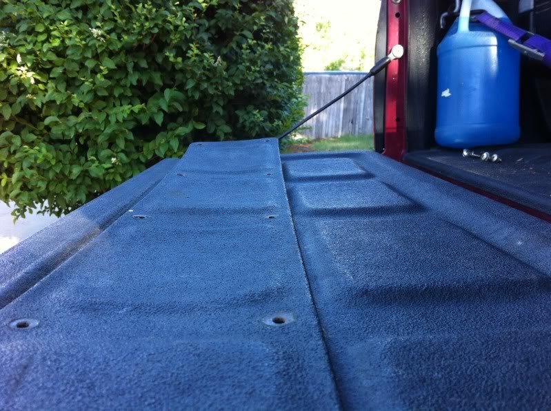

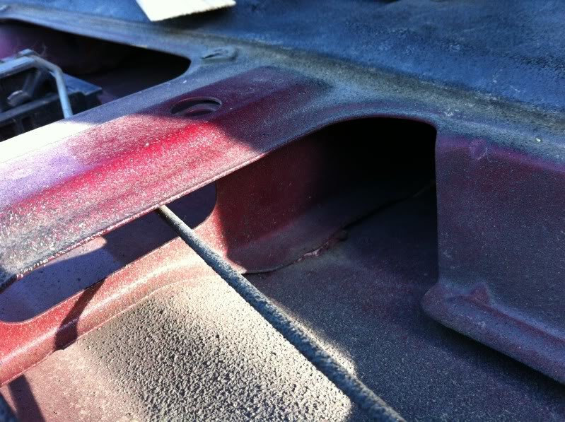

    So after 6 years I finally got around to figuring out why my tailgate handle protrudes from the trim by at least 1/2"
    When I pulled off the access panel I was surprised to see one of those metal braces (?) just floating around my tailgate. The welds were busted
    Driver's side (busted):
    Passenger side (fine):

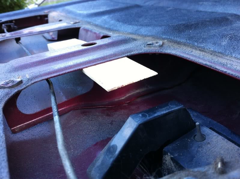

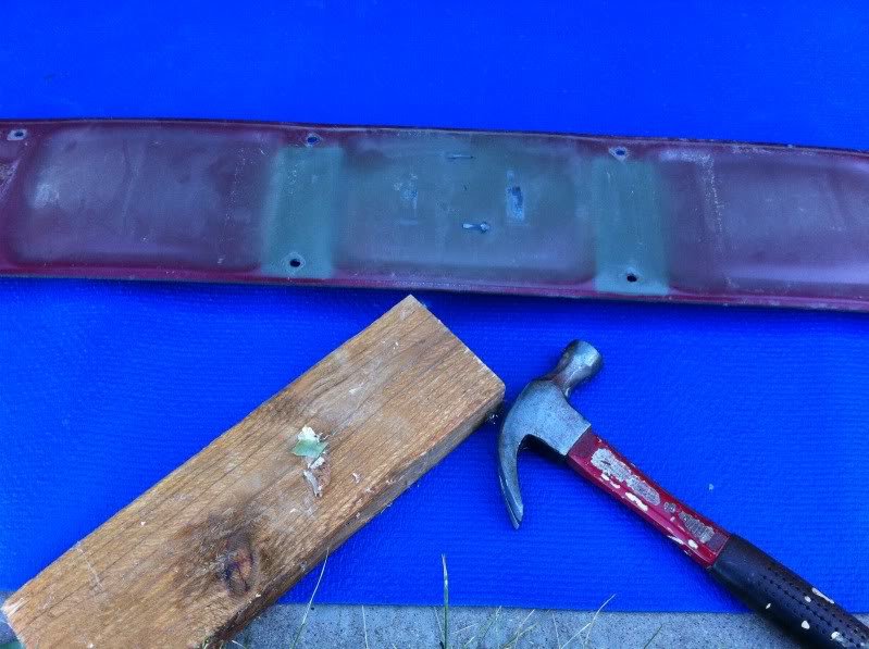

    Nothing a wooden shim can't fix:

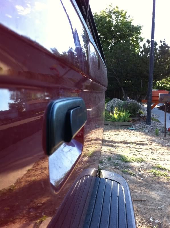

    So now onto the reason why I opened the panel. This is what my tailgate handle has looked like for about 6 years:

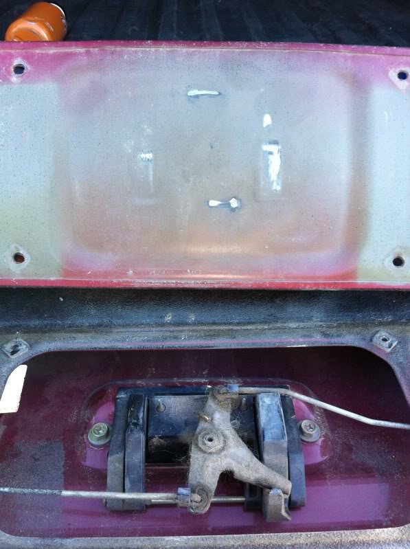

    Upon inspection I realize that the panel itself was pushing on the back side of the handle mechanism thus making it protrude. Notice how the section of panel behind the handle is concave and not convex:
    Yup, it's the panel pushing the handle mechanism out:

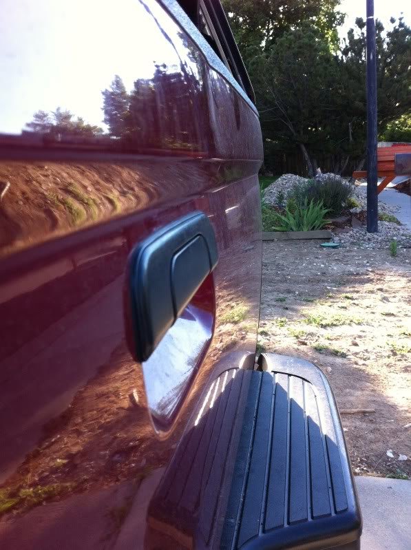

    So I got out my body repair kit and went to work:
    Put every thing back together and voila! Flush:

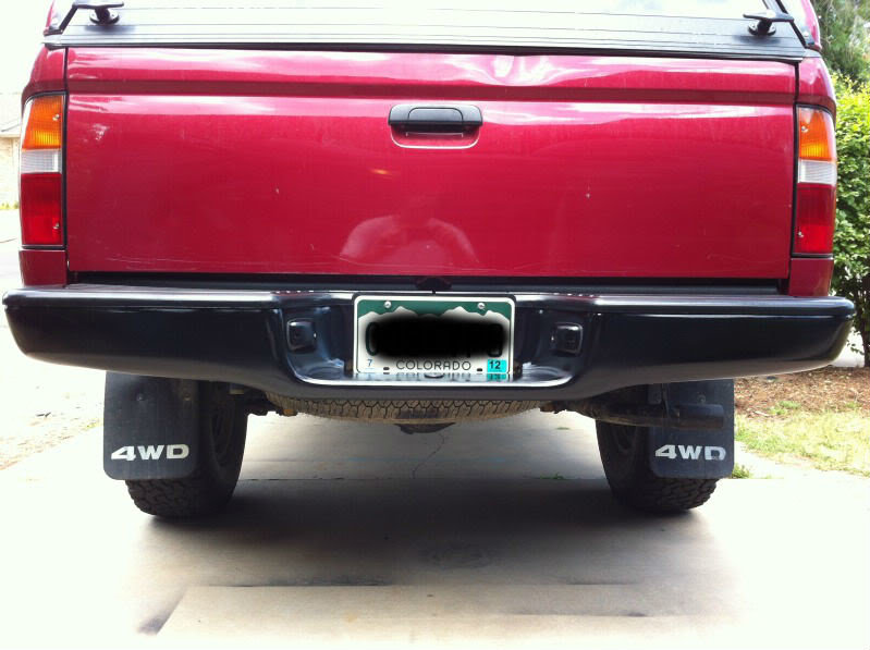

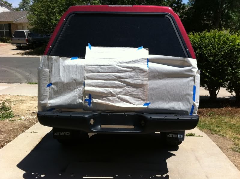

    Painted my rear bumper semi gloss
    (no that's not overspray... that's my mad photo editing skills)

    How much sanding did you do for the rear bumper?
  19. Jun 12, 2012 at 3:43 PM
    #99
    Madjik_Man
    Madjik_Man [OP] The Rembrandt of Rattle Can
    Dec 2, 2009
    #26893
    19,705
    Colorado Front Range
    1998 Ext Cab 3.4 4x4 TRD 5MT, 2004 DC 3.4 4x4 TRD
    45acp gave me his bumper and it was already painted flat black. (the first pic is how it came to me)
    It was scratched here and there, plus it could use a freshening up. Not to mention I wanted it semi-gloss, not flat.
    So I just sprayed 4 or 5 light coats over everything. By no means will it win any car show paint jobs, but it looks really good in person.
