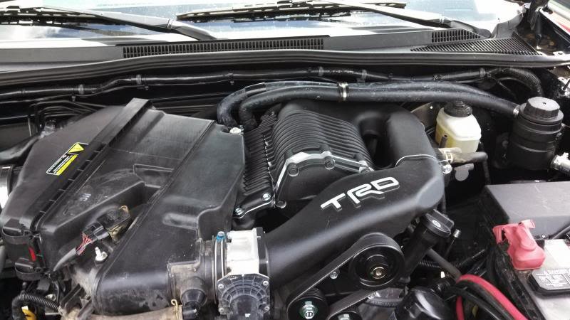

    TRD Supercharger with URD 2.85 pulley
    Custom Magnaflow muffler (for clearance, not sound)

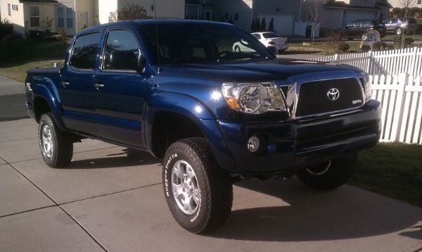

    As it sits today....
    Don't have any pics when stock - but here's the closest to it. Grillcraft grill and 3" OME lift installed

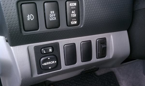

    Rear Locker override switch

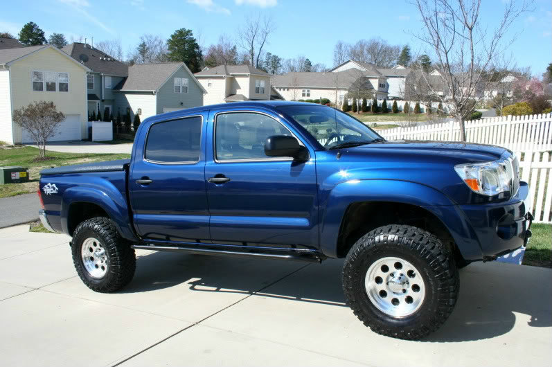

    Black Rock Yuma wheels and 285/75R16 Goodyear Duratracs installed, along with All Pro Sliders - and skids at the time

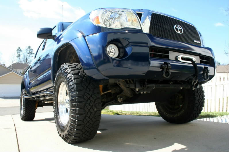

    Installed the Undercover Hidden Winch Mount System with Warn M8000 and synthetic rope and custom shackles

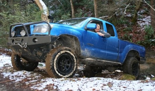

    Ran into this guy on my first trip to Richland Road, and thought he was a bit nuts....

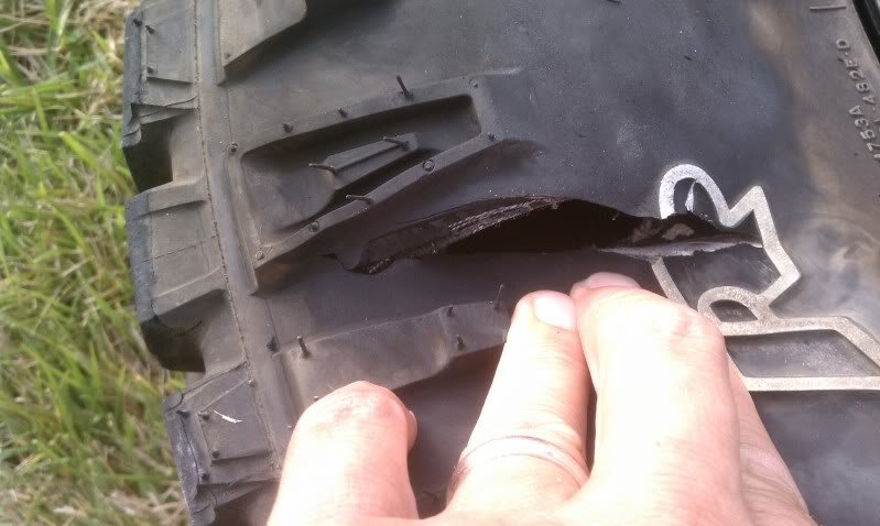

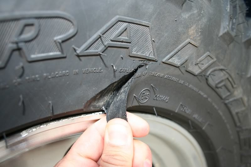

    Then proceeded to do this (strike 1 for the Duratracs)
    Then a month after replacing that one (thanks Discount Tire! :)) Strike 2...

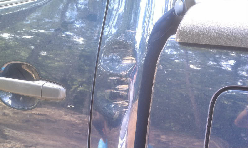

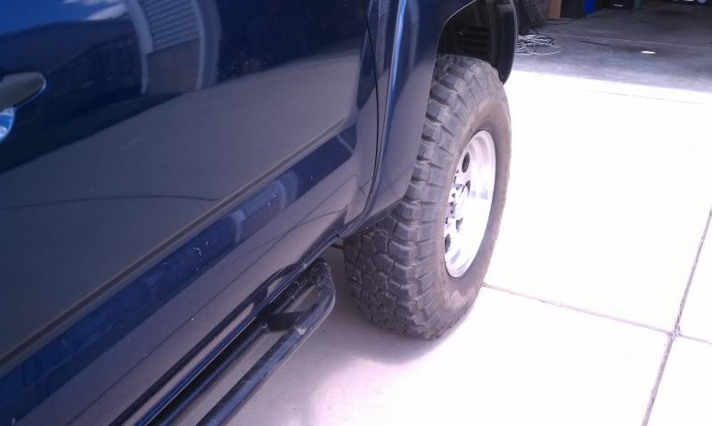

    Put my first dent in it leaning it against a tree at the top of Kodak Rock at Uwharrie NF.

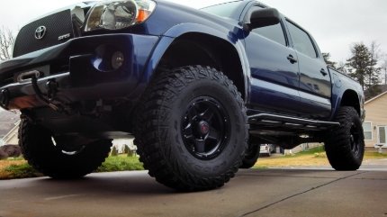

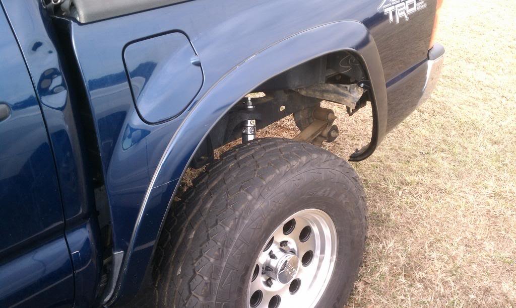

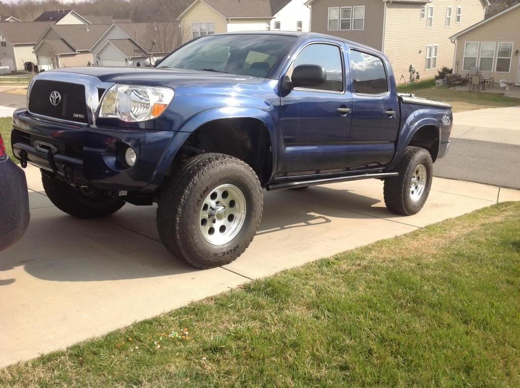

    Cut 3" out of the fenders and flares in preparation for some 315/75R16 MT/R Kevlars

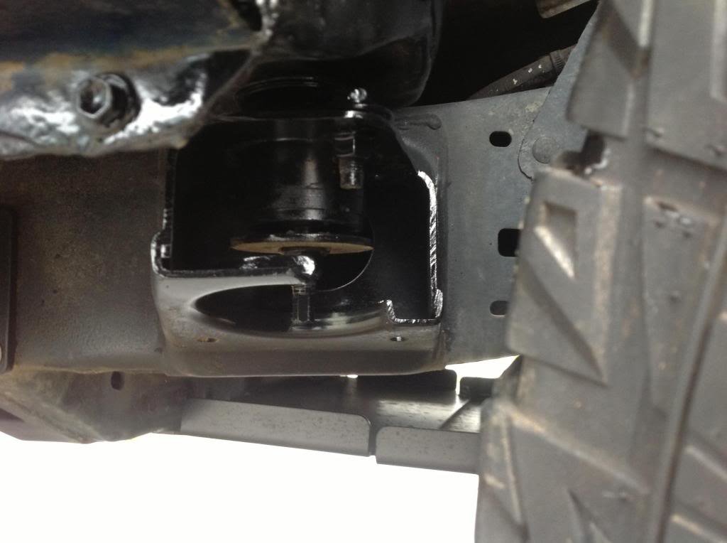

    Cut the body mount and flattened the pinch weld. Still need to finish boxing the body mount

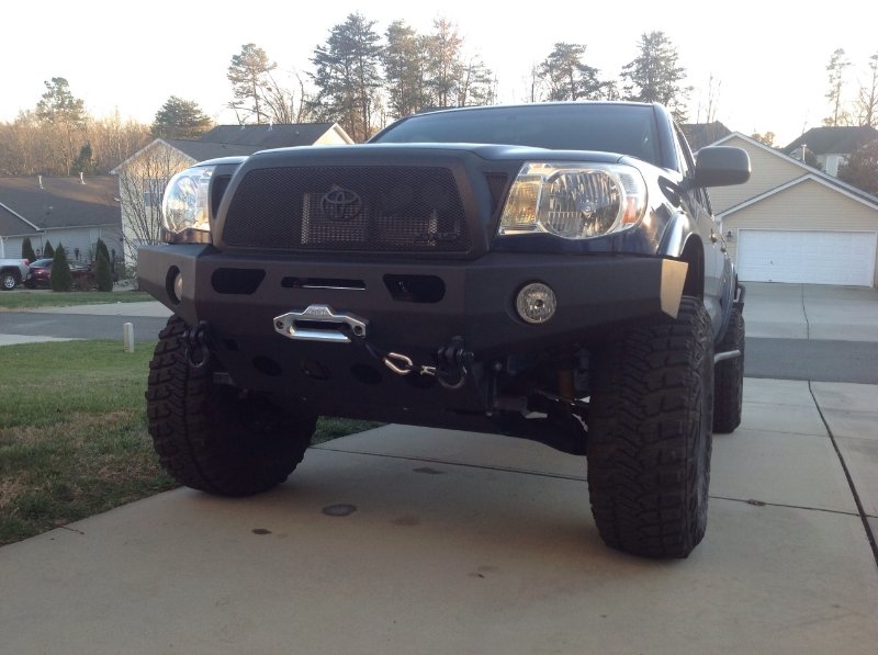

    Brute Force plate bumper to replace the UHWMS

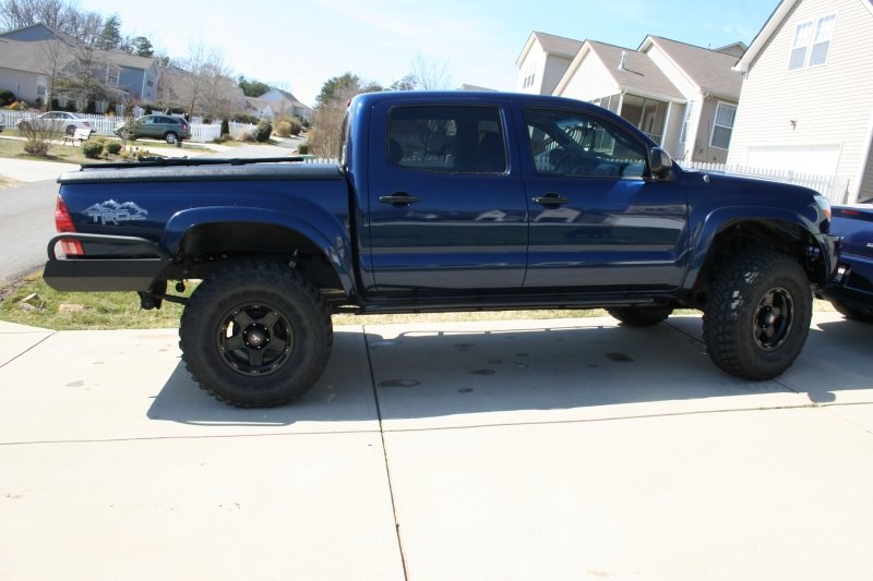

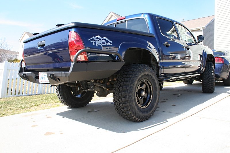

    And they're on....

    I'm waiting for the scratch guards still for the ZX wheels. Should add some nice protection in the rocks. The real nice thing about these wheels though, is that they hide the valve stem behind the lip of the wheel, which should also help in the rocks.
    Actual loaded measured height of the MTR is 34.4". That's right at 2.5" taller than the 285 Falkens.

    Jandrews has the same cab dent from the same trail, probably from the same tree :laughing:

    Ha! It's the only tree in the rock area, so no doubt the same one :)

    Better shot.... :)

    I've gotta take a little bit more out of the bottom rear corner of the cab mount. A little too close for comfort. Also rubbing the frame and UCA'S when at full lock. Not that big a deal but I might try some 1/4" spacers I've had sitting around for a year.....

    Looks good. How did u get the fenders to stay on? I am planning on cutting mine down just havnt figured out how to keep em on there
