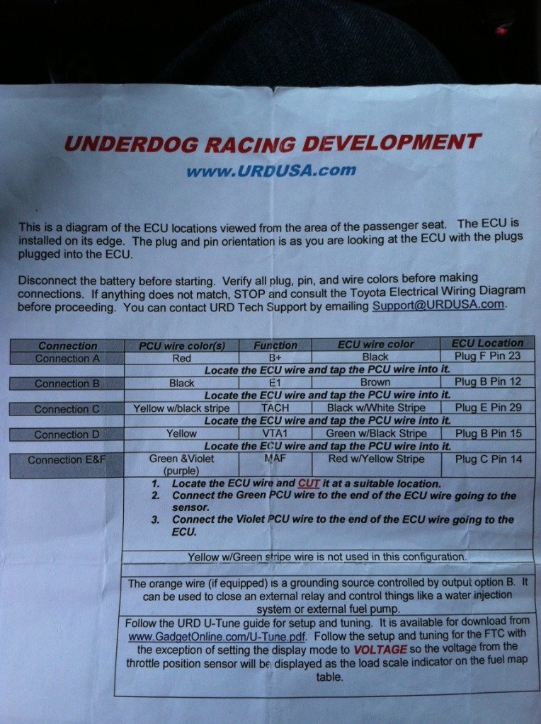

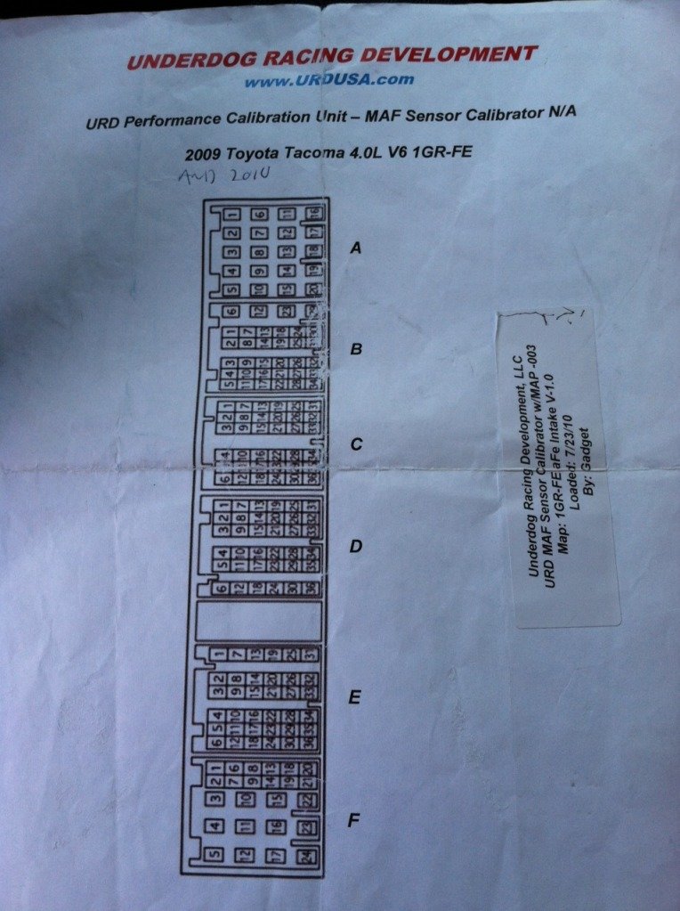

    So i went to go install today. wires arent matching the diagram I have from This DIY thread. Anyone have any idea if they changed the wire diagram and where I can get the correct one for the install if so??

    Yea I read it correctly. that diagram is for an 06' I have an 09' and the wires do not match... In E I dont have a black in pin 1. and so on so forth with the rest. I dont wanna thread jack this review so if you have any info for the 09' will you PM me?? Thanks for getting back to me though buddy!

    Sounds good, Thank you again! I searched this site and google and found others having the same issue but couldnt find a new diagram. Just want to be 100% before I start messing with my ECU wires..
    Yeah I saw that as well, but still couldnt locate the correct wire in the correct pin..

    Here is the Wiring Diagram I received from Jerez. Suppose it would work on 09+ but not sure about the 2012..
