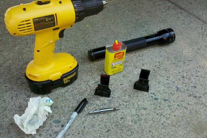

    Tools
    Mag light mounts
    Drill
    5/64 drill bit
    Pen/Marker
    Goof off
    paper towel

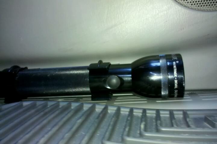

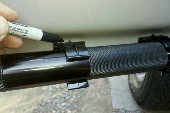

    First off you need to check the location I did this by placing the mounts on the light right off the grip so I can grab it easily. Hold the light agents the door in the location and close it to make sure it doesn't hit anything.
    As you can see you don't have much wiggle room I have about 1/8" space between the light and the jam.

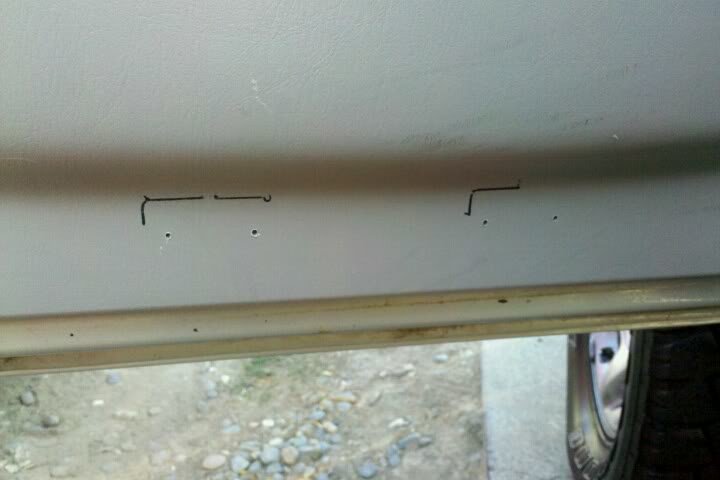

    Now that you have the placement you want mark it.
    With the placement marked place the mount on the door and drill 4 pilot holes.
    After drilling the holes take some Goof off and wipe off the marker.

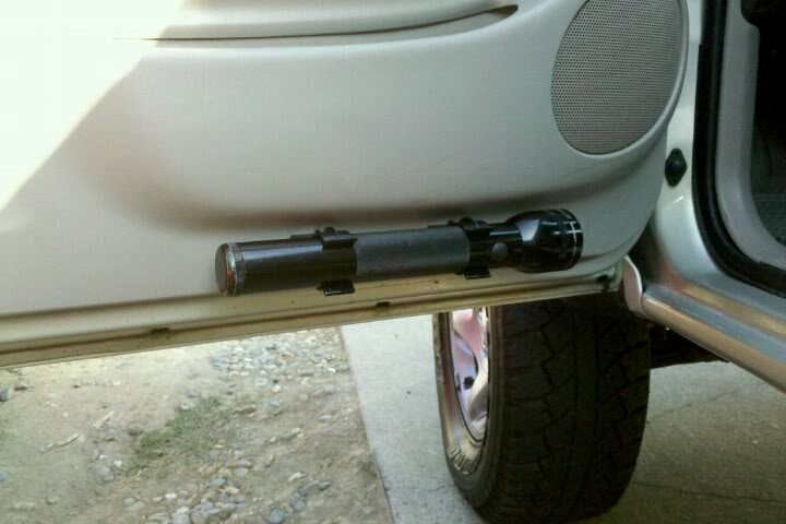

    Screw them in place and done!
    This is how it looks with the door closed.
    It's fits like a glove and it will fit a 2D 3D & 4D mag light this is my 3D but I'm going to put in my Blue 4D led.

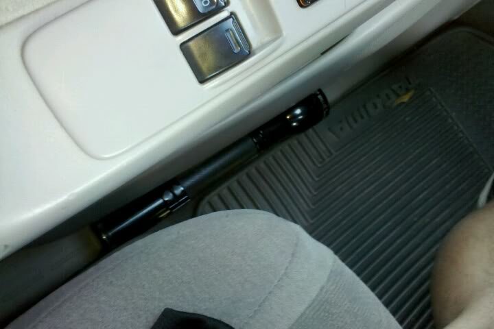

    I went the budget direction and found a free mag-lite mod, it works great, at least if you have the 60/40 split bucket seats. The 3 D cell maglite fits in between the center console and passenger seat perfectly, doesn't rattle or move and doesn't affect how the passenger seat slides, AND it's easy to get to when/if I need it. I'll try to get a picture here later, but if you're strapped for cash and have a maglite, try this for free.
