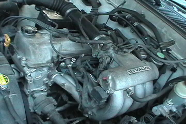

    Ah, you have a 96... :)
    I had one for 17 years and loved it.Your engine has really long intake runners which is excellent for getting good gas mileage.
    Your truck is also smaller and lighter. :thumbsup:
