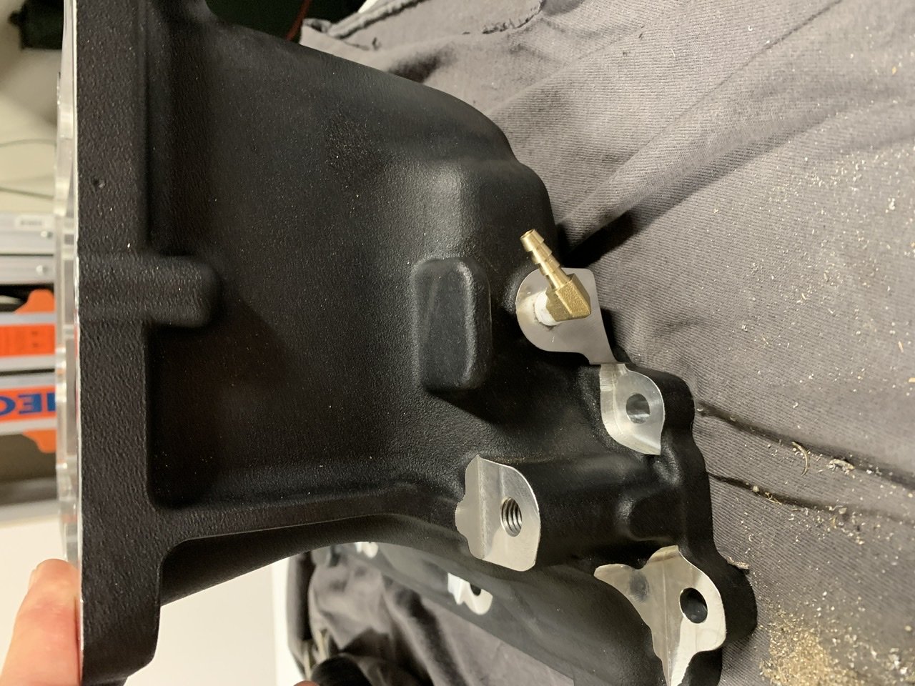

    It’s in the back at the lower half of the manifold. I don’t know if anyone else had the same issue I did, but the plug was on so tight I couldn’t get the plug out. The allen head completely stripped. I had to drill it out and retap.

    Geez. What a headache.
    A boost port could also be tapped into the cover. Any where post lobes. However, I doubt many will want to tap that portion.

    One of the benefits or improvements in this supercharger that I like is how easy it is to swap pulley sizes. Compared to what the 2nd gen trucks had.

    If the plug came out ok it would have been quick and easy. Just need to remove the plug and install the 90 deg fitting on the bench before installing the manifold. Trying to install the fitting with the manifold installed would suck.

    so part of the solution is to install the boost connection before you install the manifold. ?
