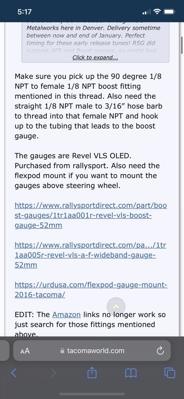

    Yes, that is the port.

    I went to Home Depot and autozone and could not find the fitting

    Thanks bro I found it online.
    JoyTube 5 Pcs Hose Barb Fittings 1/8" Barb to 1/8" NPT Male Thread Brass Metals Adapter Connector https://www.amazon.com/dp/B087Q9GV23
    Legines 1/8 Inch Brass Street 90 Degree Elbow 1/8" NPT Male x 1/8" NPT Female Forged Pipe Fitting (Pack of 2) https://www.amazon.com/dp/B074DTL1N4
    https://www.ebay.com/itm/2936342744...3kh882vTKC&var=&widget_ver=artemis&media=COPY

    @SatlyPartiot408 Just an FYI, some have complained that they were challenged by the 90 elbow, with getting the threads tightly sealed when having it pointed in the necessary direction. (when it is not tight enough, the only option is a full 360 deg turn, which can be over tight or impossible) Using a female 90 elbow, with a close nipple (or shoulder nipple) to the Maggie, allows for getting tight threads AND having it point where desired. This is an old plumbers trick, when dealing with threaded fittings, as for a 360 deg rotation, each end of the nipple only needs to tighten by 180 degrees. I found these elbows and nipples from Amazon also.
    EDIT: On the 3rd gen Tacoma, the housed wire bundle is very close to this tap-point, and I found that there is not enough room for the above mentioned Nipple and Elbow!!! I had to run and find a street 90 deg elbow, as suggested by Maggy!
    Hope this did not trip up anyone.
