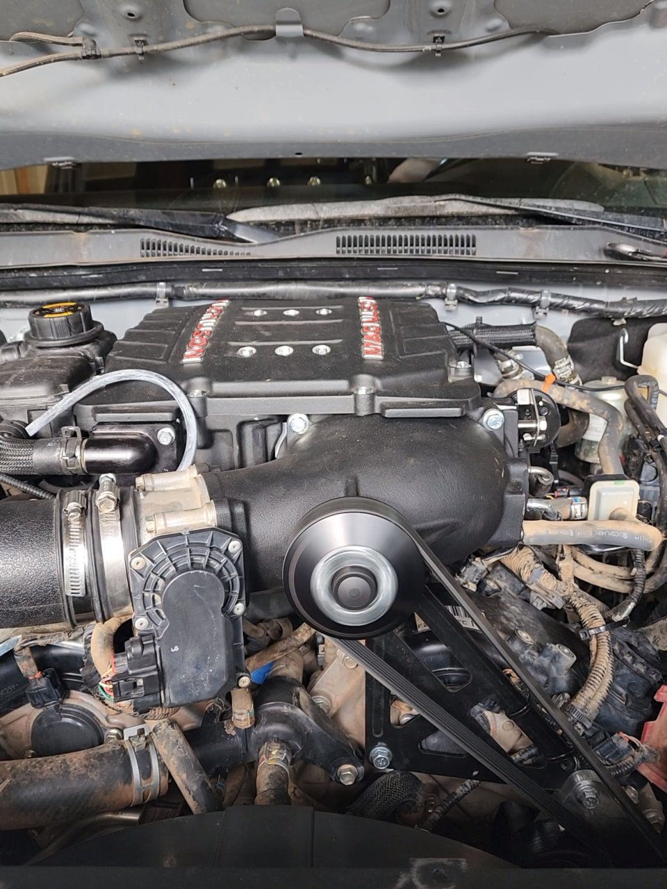

    Foam Cell Pro Stage 2.5 Lift Kit. 17 in Method Wheels 33in Maxxis Razr AT 811s Explore Overland Rock Sliders RCI Skid Plates Airaid Snorkel Magnuson Supercharger
    I'm running a boost gauge and a banks idash. Plan on getting a standalone wideband AFR gauge to compare what the banks is reading from the Toyota sensors.

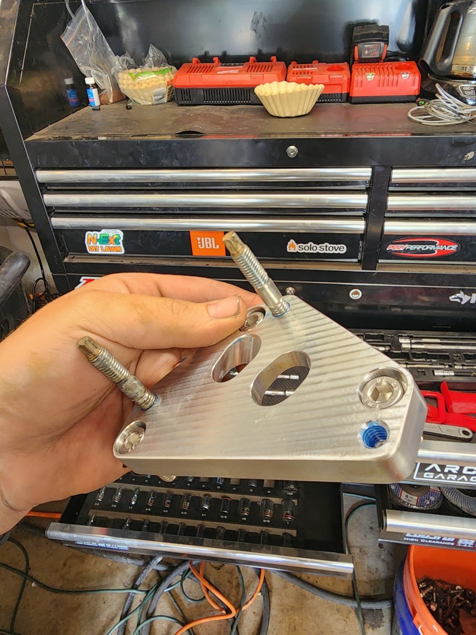

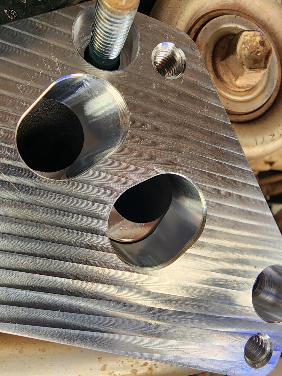

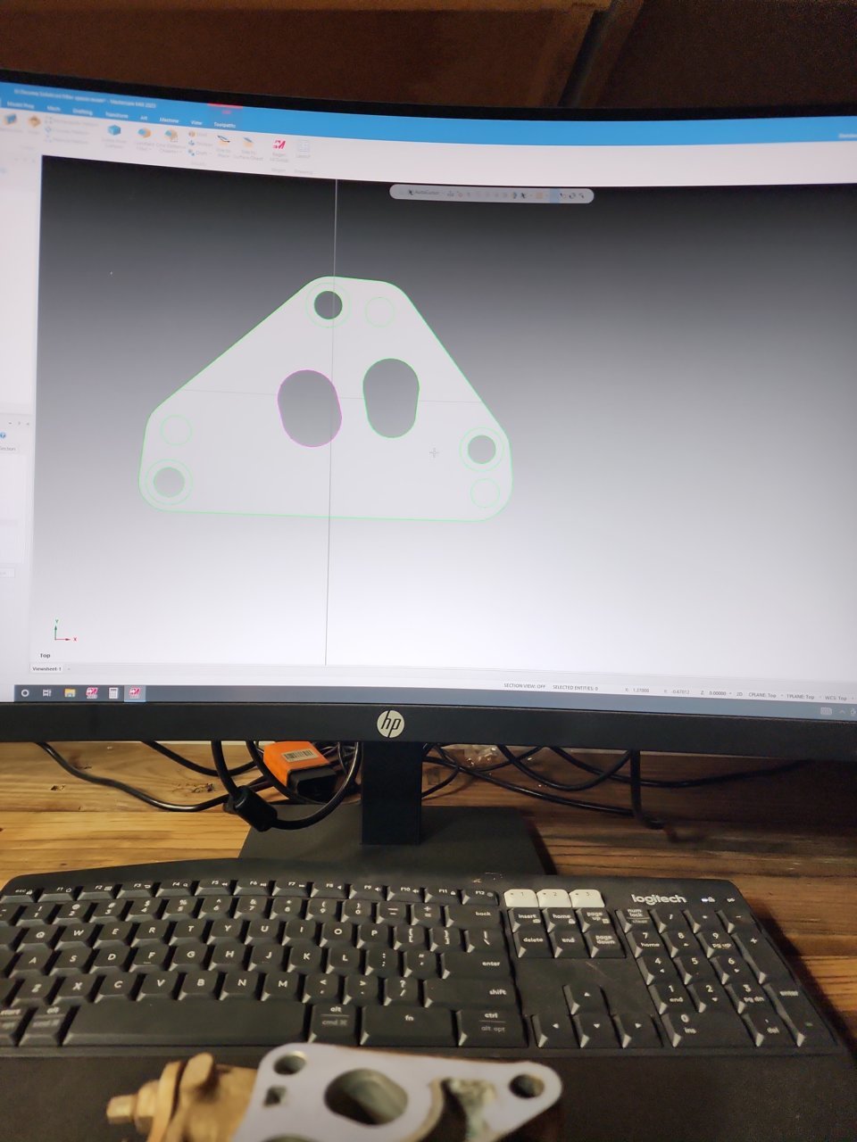

    Perks of being a machinist... I made my own oil cooler spacer... and I'm gonna go out on a limb and say mines better! My goal was to not have any oil flow interference so I went and over complicated the heck out of the passages

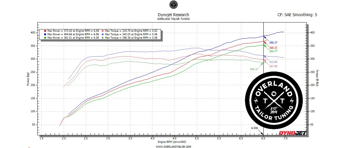

    OTT has run the 84 mm pulley and published data. Not sure if it’s for sale, but they know what it takes to make it run. Reach out to @JustDSM. Runs below were done around 4500’ elevation in SLC, UT, data is SAE corrected though so accounts for atmospheric conditions.
    Green = 90mm
    Red = 87mm
    Blue = 84mm

    Talked to him. He said 84mm was not going to be for sale. :(

    Yeah, the 84mm asks a lot from the engine. Juice may not be worth the squeeze for more ponies and TQ.
