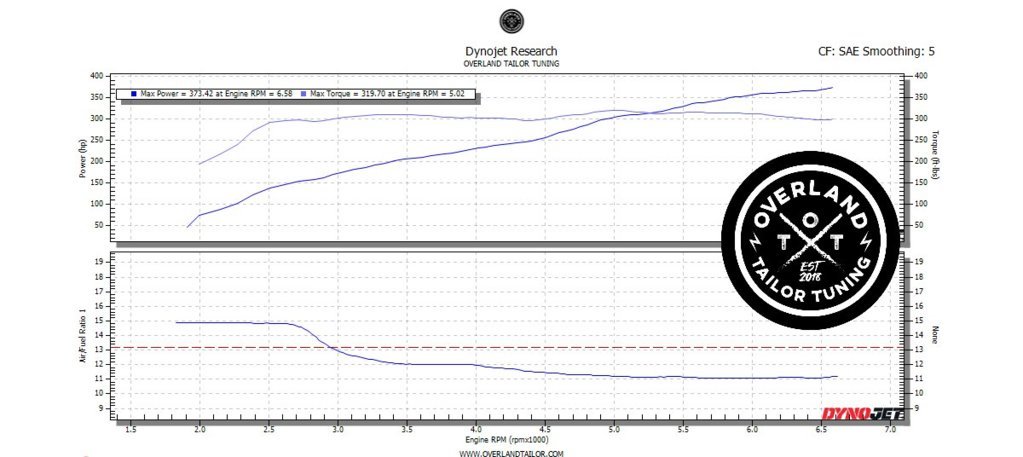

    Fueling is perfectly fine with the 90 and 87. Pushing it with the 84mm. You're out of fuel up top with the 80mm (fuel pump). There is a lot of misinformation regarding the 3GT, fuel and maggie kit that stems from a couple years ago. Mainly from a certain tuner brand trying to push a fueling kit for monetary gains when it wasn't needed ;). Hint it wasn't OTT.
