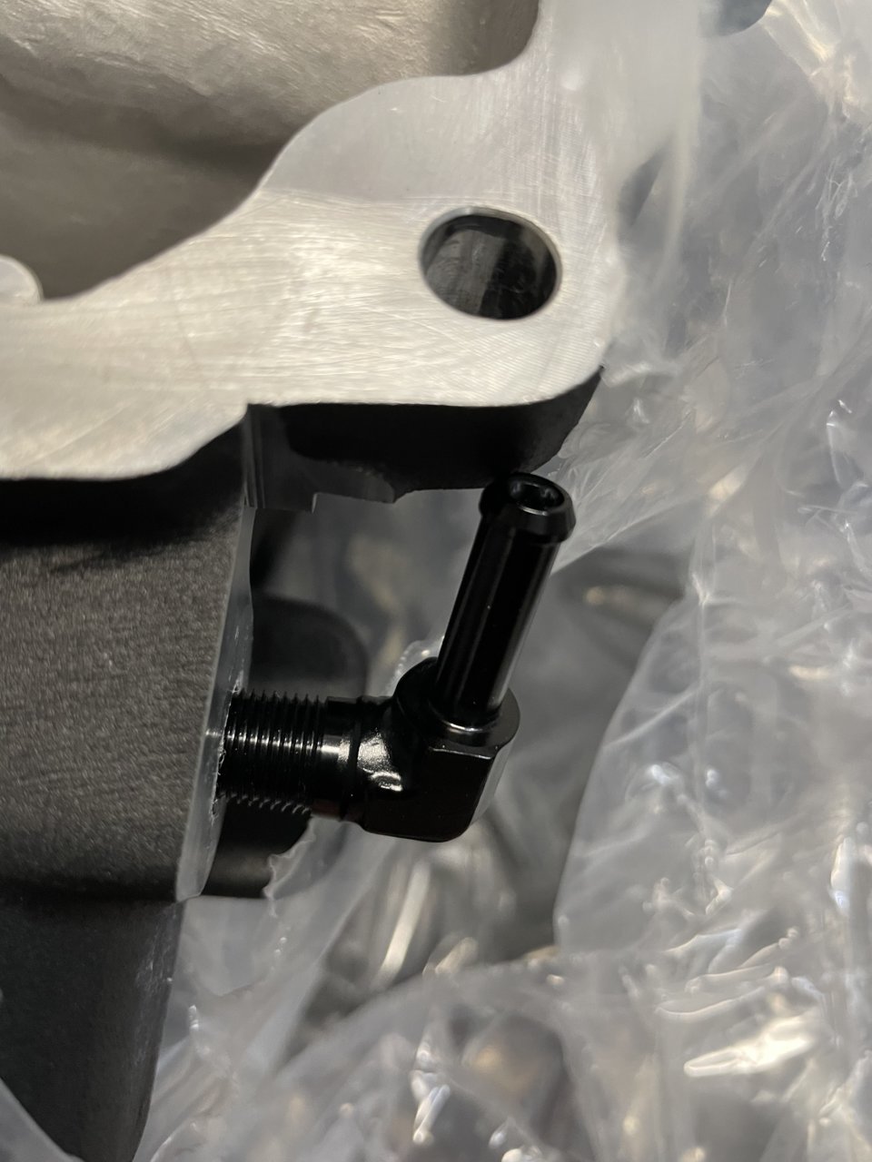

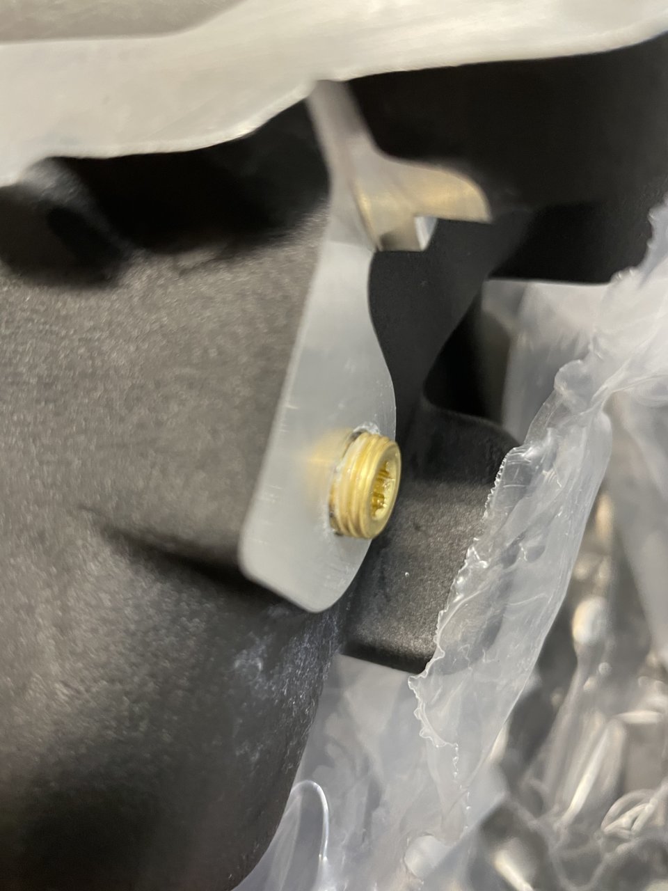

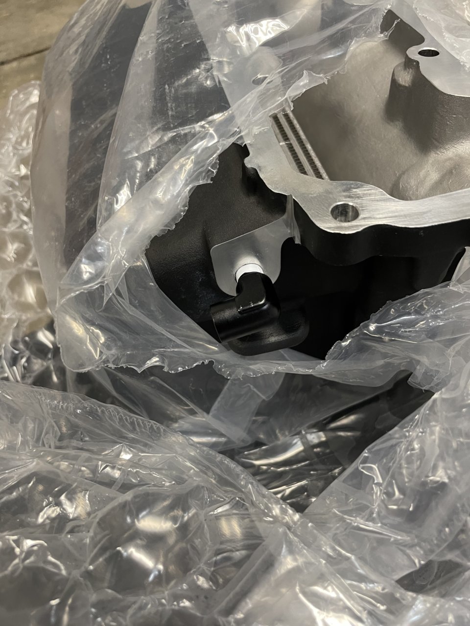

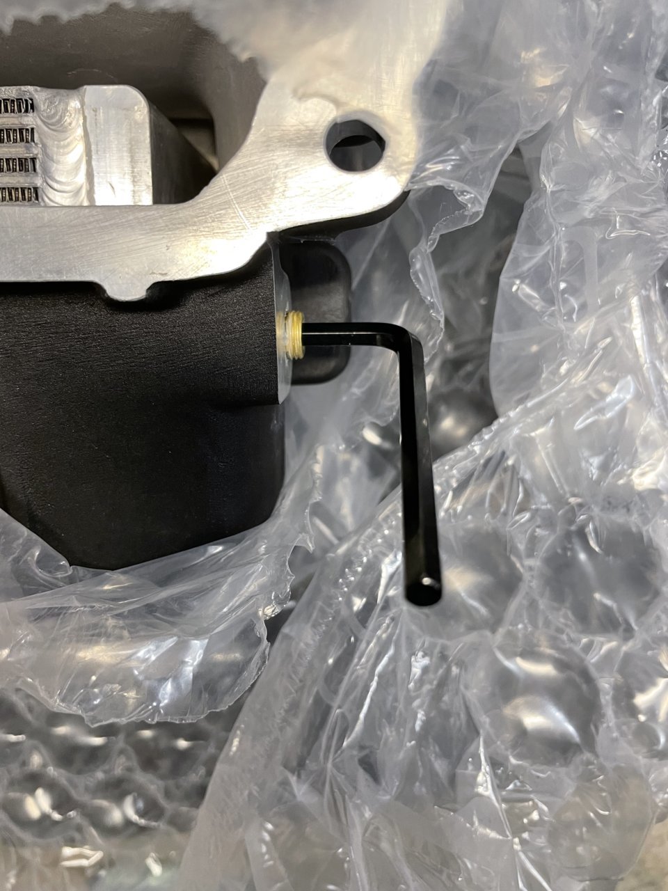

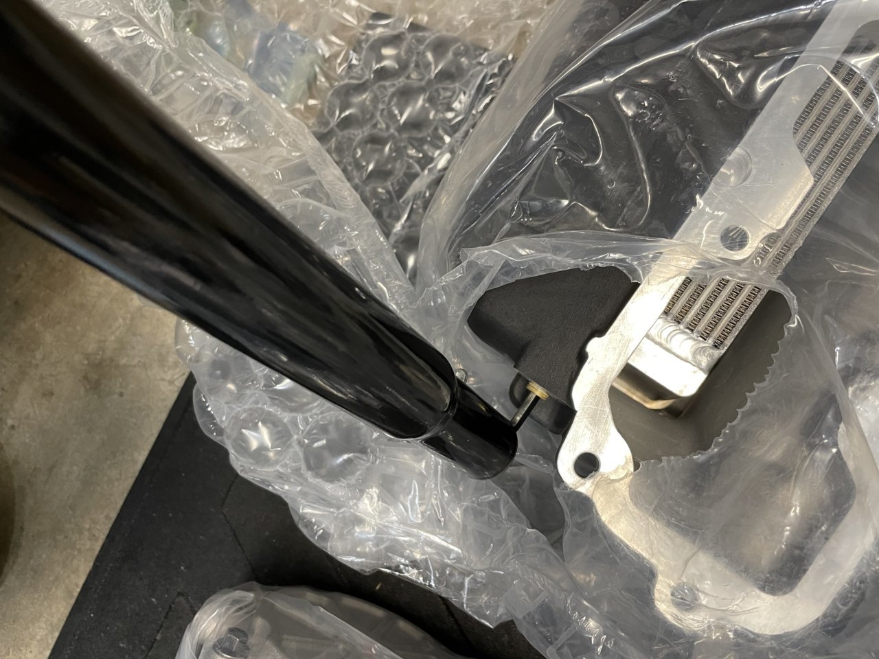

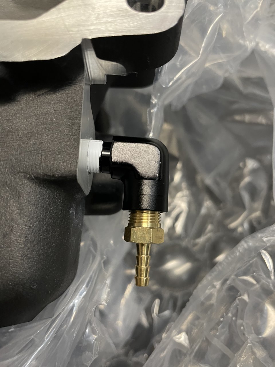

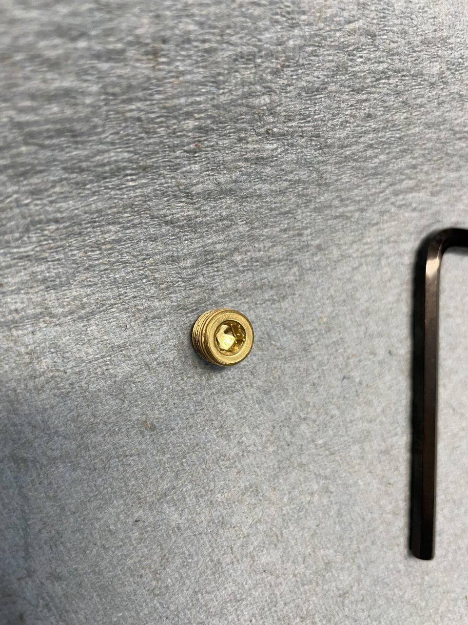

    Hey guys you know that pain in the ass 1/8 NPT brass plug in the back of the heat exchanger that we use to hook up our boost gauge? So… Magnuson uses thread locker on this biotch from the factory. For folks looking to install this supercharger in the near future here are some tips to get it out without damaging the threads in the cast aluminum housing and the brass plug itself.
    You will need to order the following:
    Aluminum Alloy 90 Degree 1/8" 1/8 inch NPT Female to Male Elbow Coupler Union Hose Fitting Adapter, Black https://www.amazon.com/dp/B07Q1WHY36
    PHITUODA 2pcs 3/16" Hose Barb to... https://www.amazon.com/dp/B07RDDFMPG?ref=ppx_pop_mob_ap_share
    1. Hit the outside with WD40.
    2. Look inside to find the plug hole. Put some shop towels inside and spray a small amount of WD40 in the hole. Wipe off excess.
    3. Grab 3/16 Allen wrench. Insert into plug.
    4. Take the handle off your floor jack. Place over the Allen wrench and push down counterclockwise lightly. Go slow. Remove plug.
    5. Last pic shows you why a 90 fitting with a nipple won’t work. Don’t order this piece. It won’t clear the housing when you rotate.
    6. I use Teflon PTFE tape on the threads. Never had an issue on prior builds. Insert 1/8 NPT 90 elbow. Rotate into place. Apply towel and gently snug down with pliers. Insert 3-16 barb to male 1/8 NPT into elbow. All done.
    Another member @OpelGT mentioned an alternative is to hit the plug with a heat gun, soldering iron, or cigarette lighter instead of WD40.

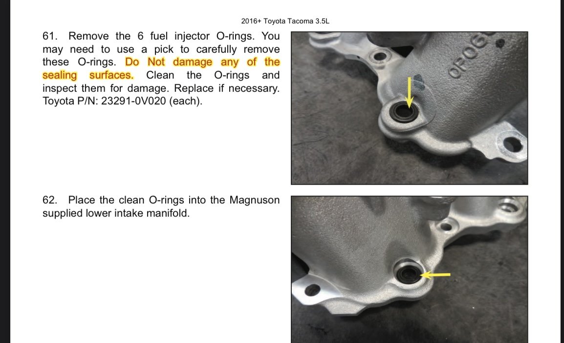

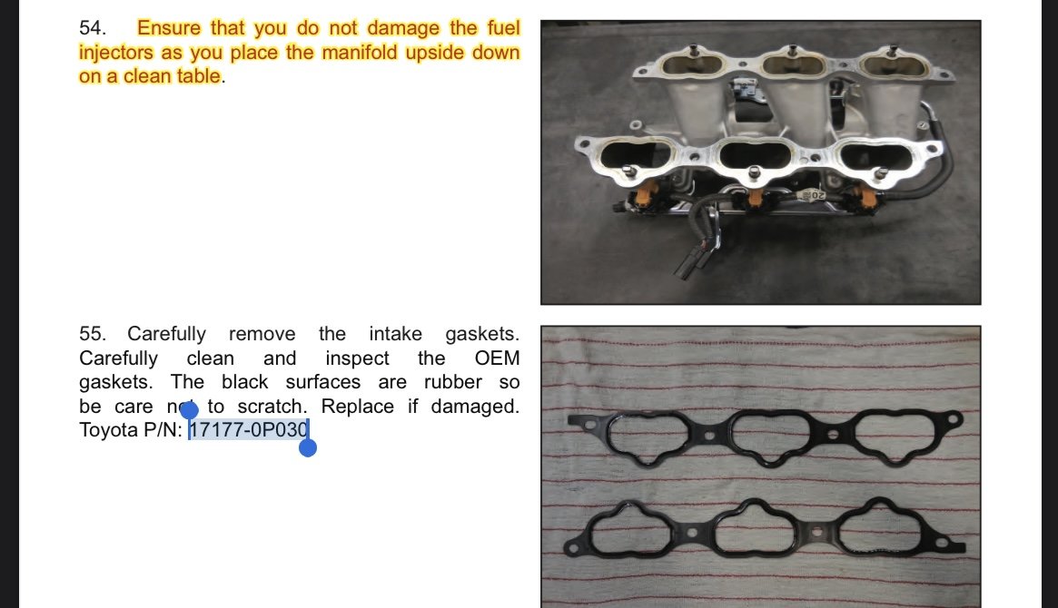

    Also for folks looking to install the supercharger on older trucks 2016-2018 or trucks with >30k miles you may want to consider swapping the intake manifold gaskets and the fuel injector rubber o rings. Part numbers below:
    Intake manifold gaskets P/N 17177-0P030
    Fuel injector O rings P/N 23291-0V020

    good tips! One more though. Heat will do more for you than WD40. Thread locker looses its holding power when hot. A few seconds with a cigarette lighter or soldering iron and it will come out easy.
    I removed mine while it was installed on the truck. A heat gun, a little ratcheting Allen wrench are the trick to working in that tight space by the wire loom.
