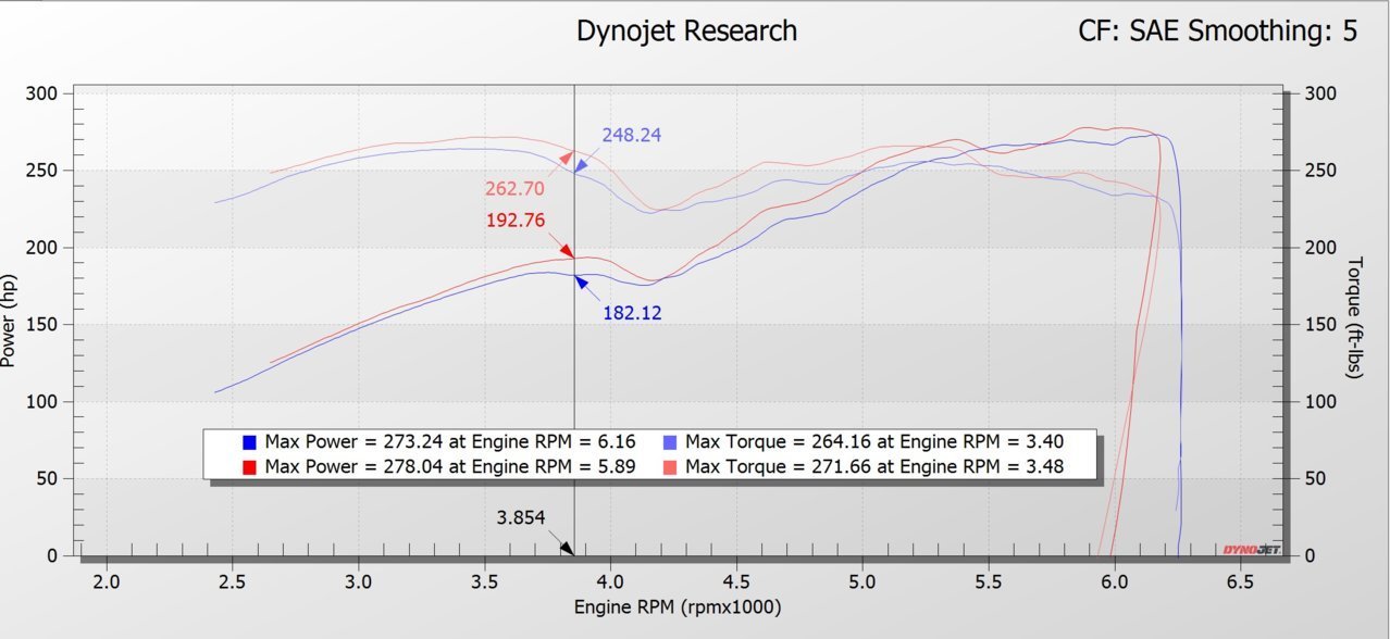

    Baseline dyno for the Magnuson 90mm with URD SPEC U exhaust tested. 3rd gear pull. Although peak power doesn’t appear to be much different, the area under the curve is increased. Delta at 3800 rpm and 4500-5300 RPM is 14 WTQ and 10 WHP.
    I have a brand new URD Spec U exhaust system never installed sitting in my garage taking up space. If anyone is interested send me a PM.
    o313, SK808 and tonered like this.

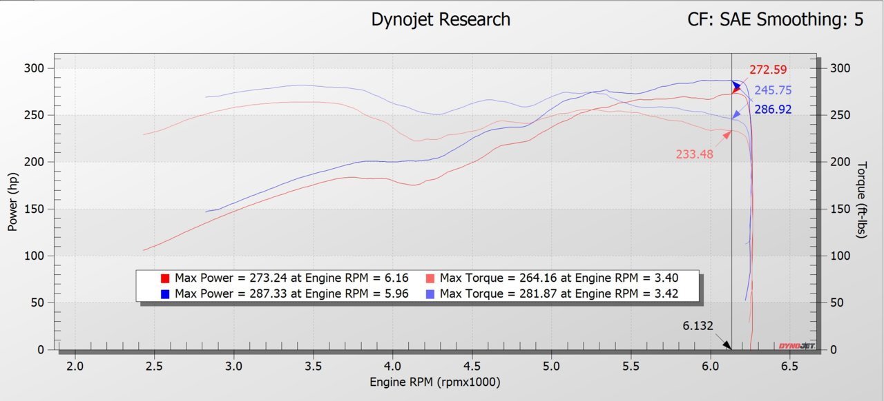

    Baseline dyno Magnuson 90mm vs 87mm with URD SPEC U exhaust installed. Stock Magnuson tune. 3rd gear pull.
    The 87mm pulley appears to be safe to run with the Magnuson stock tune. AFR’s were 11’s-12’s on the dyno.

    If the tune is good and safe with the 87mm pulley, I wonder how little we can go before reaching the end of the fuel systems capabilities?????
    Edit: Not that I'm willing to risk it or encourage anyone else to risk it...but just curious.

    Lol… you won’t need to. I’m testing the 84mm on the Magnuson stock tune right now. Will update with dyno numbers and AFR soon.
