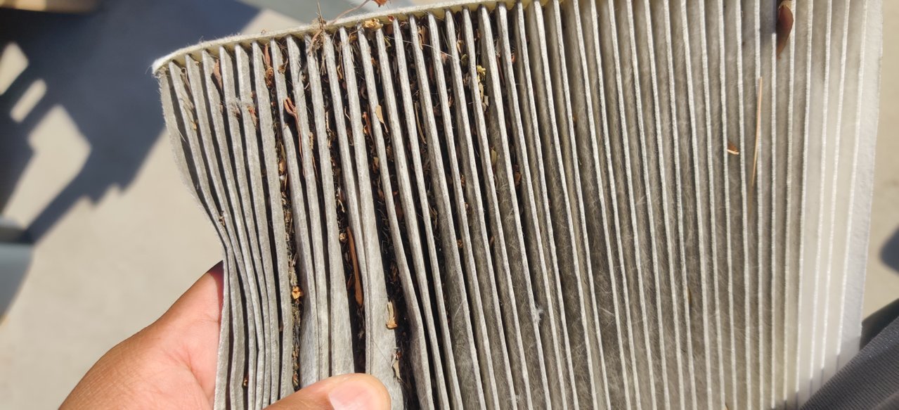

    Smell was of "musty, old, mold" so I checked the cabin filter behind the glove box.
    This is what I found:IMG_20210611_181321.jpg

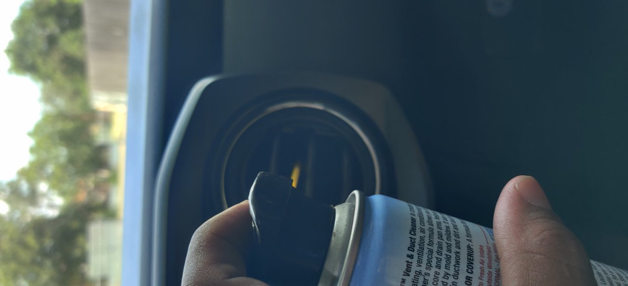

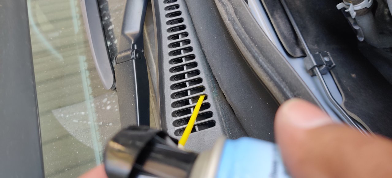

    Spray half the can to the outside vents:

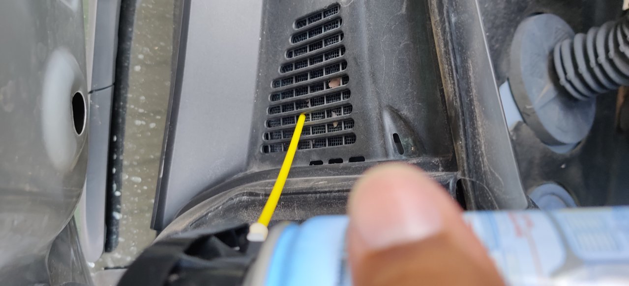

    Then the other half into all vents inside the cab:
    DO NOT REPLACE CABIN FILTER WHILE DOING THIS STEP! It will go on after the whole procedure to avoid the deodorizer being filtered. Replace the cover to the cabin air filter behind the glove box without the filter media.
    Turn on the truck and run the A/C full blast and with re-circulation OFF for 15 minutes, meaning air should be coming from the outside in. DO NOT STAY IN THE VEHICLE DURING THE PROCESS! Windows should be closed as well. After the 15mins, open all windows and run for another 10 minutes more so the deodorizer can clear from the cabin.

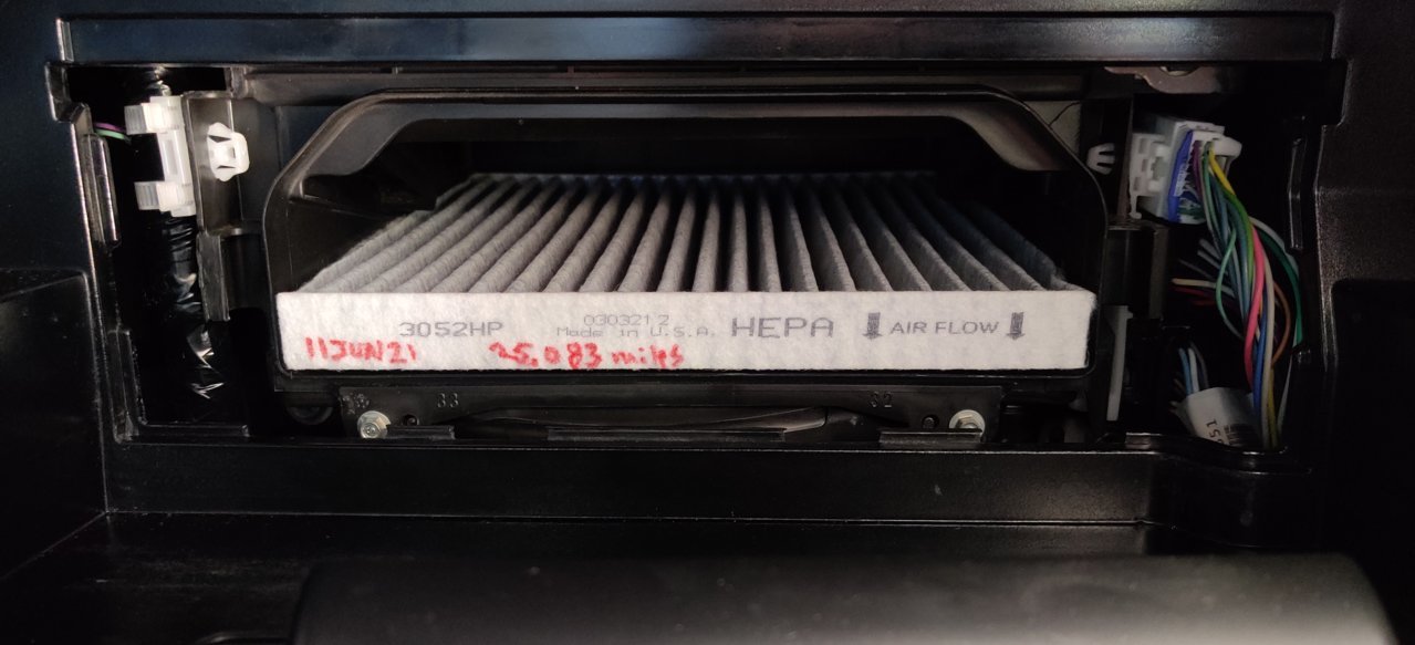

    Finally, turn off the truck and open the glove box and insert new cabin air filter media. I used the MicroGard HEPA filter Part Number 3052HP. I labeled mine with date and miles (force of habit).
    Shout out to @wi_taco on this thread: https://www.tacomaworld.com/threads/wi_taco-2015-trd-or-build.677890/#post-24189463
    It will take a day or two for the deodorizer smell to fully leave the A/C vents and ductwork, but it works. Especially if you use the HEPA filter media.

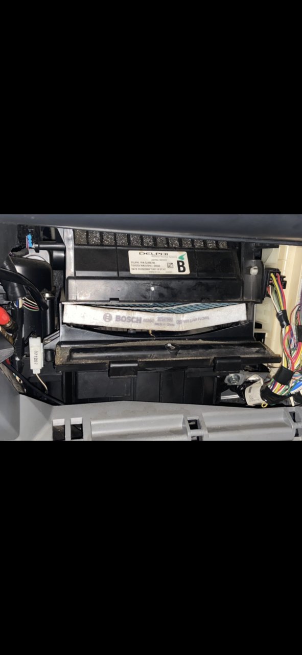

    I can give you some data regarding the efficacy of HEPA cabin air filters. For two years in a row now, the Seattle area has had pollution alerts due to forest fire smoke at the surface. In my 2019 Tacoma, the Toyota OEM cabin filter did essentially nothing to reduce PM2.5 concentration, i.e. the concentration of particulate matter less than 2.5 microns in size that presents the greatest health threat associated with forest fire smoke. I installed a Bosch 6033C HEPA cabin air filter, and running the AC in re-circulation mode reduced the PM2.5 concentration from 50 ug/m^3 to 2 ug/m^3 in three minutes! I used a handheld PM2.5 analyzer. I had exactly the same result with my XTerra which had a Fram FreshBreeze filter before I installed the HEPA filter. They say the HEPA filters restrict airflow more than the standard filters which may be true. My impression was that airflow was adequate, but I didn't analyze that quantitatively. I put in the HEPA filters for only as long as the air is bad (only two days so far this year, thankfully, but over a week last year) then swap them back out for the standard filters until the next smoke alert. I always figured that the cabin air filter was just some BS marketing scam, but the last two years have made a believer out of me, at least regarding the HEPA filters. I guess the standard filters are good at keeping leaves out.

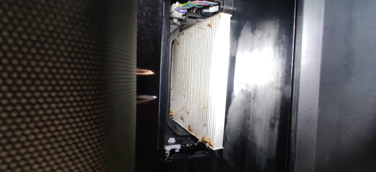

    @IRONCLADBARREL and @Jeffch you both have installed your filters wrong. The hard sides should be on the sides, not facing you when you install them. The filter should be flat and not bent or buckled up. Take the filter out and rotate 90 deg and reinstall.
    Other then that. Nice write up for deodorizing the HVAC.

    Look at the second picture you posted. That is the correct way.

    Sorry, the second pic the OP posted. 2G and 3G go in the same way.

    Yeah.
    It doesn't help that the filter is nearly square and will actually go in either way, lol. I did the same thing last time I replaced mine, just not paying attention. I realized it after my last dusty trip when I was cleaning stuff up. But if you look closely inside the box, you can see that there are shelves for the hard sides to sit on on each side.
    But good write up, now I need to do mine since my filter was in wrong.
