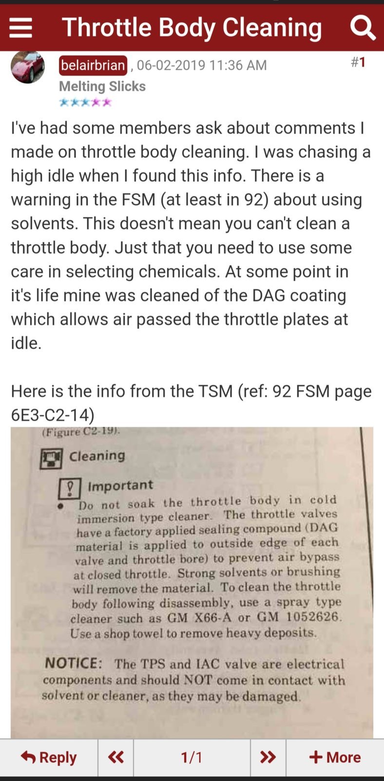

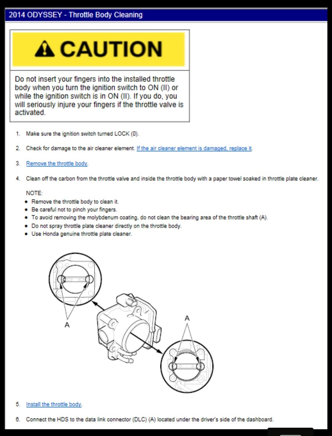

    You do you....Ive seen some of your posts. You think you know it all but really dont know shit.
    Heres a couple under your (any) fsm
    https://www.odyclub.com/threads/cleaning-your-throttle-body.206906/
    May not say frequency but still preventative maintenance. Theres prob more but im not going to sit and look them up.

    @wilcam47, just because instructions are included on how to do it, doesn't mean it is a recommended or required procedure. Think about it, there are most likely instructions for R&Ring the cylinder heads as well, does that mean periodic head gasket replacements are necessary?

    I also have never heard any authoritative source recommending the cleaning of the throttle body as a part of preventive maintenance. What would it be preventing?
    OP, none of the stuff you said the dealer recommended is a part of the published maintenance schedule, AFAIK. Modern cars have become more maintenance free than the old days, but people tend to hold onto old ideas.

    Theres literally countless articles on it

    Most “articles” are not what I would consider authoritative.

    Well dont f*n do it. Does it hurt anything to clean it? I mean really does it??...Some of you are just being contrary to be contrary.

    The throttle body around the opening and butterfly needs to me be cleaned, maybe not necessarily for newer cars but for cars with more than 200k should. There's build up in that area and can cause the car/truck to stall while idling or when letting off the throttle while driving.
