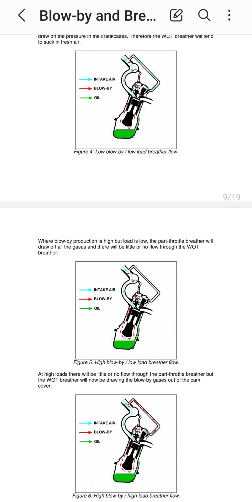

    @wilcam47, maybe you don't understand those systems, or maybe you didn't read that very generic PDF you posted. Basically every manufacturer sets up their crank case ventilation systems differently; I would argue the one in the Tacoma is tuned to not feed crankcase gasses into the intake upstream of the throttle body. Prove me wrong.

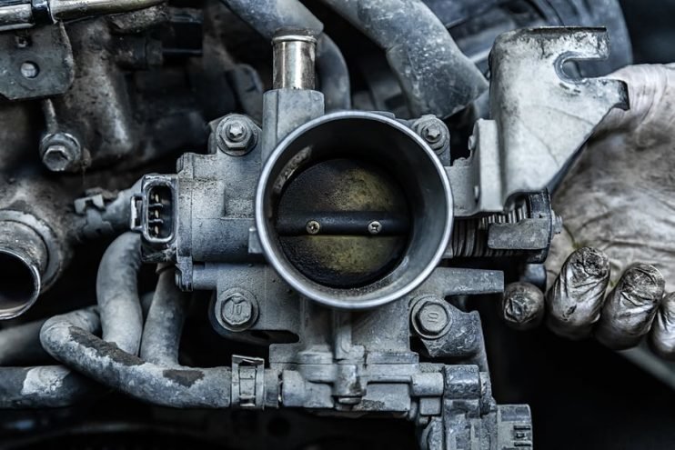

    Have you seen yours after about 30k miles?
    I got quite a bit of gunk out.
